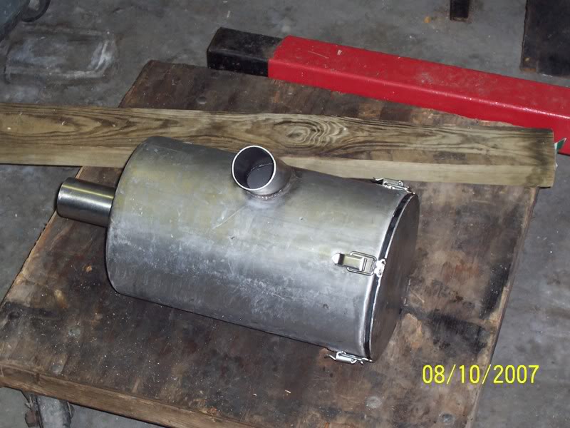

This is a box built by John's that is on their website.

Ron take some 120 grit sand paper and sand the inside of that box and remove some of the burs around the stamped holes. Then it will rinse easier.
