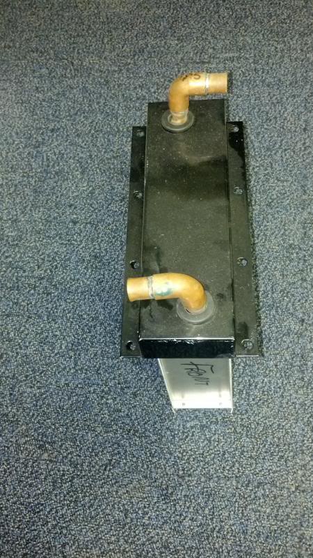

I bought a van from a business that had sold out and it has an older Prochem Legend and the heat exchanger must have frozen. Any ideas where to get one or have this one repaired? I've attempted to attach a picture. Thanks for any help.
Ed
I'd call the Pembertons. Repaired, try a radiator shop. When we would freeze a pre-heater we usually bought a new one.

Thanks Richard. I've also thought about just eliminating the heat exchangers and putting in a fuel fired heater. I might just forget about the pump mechanism all together and turn it into an extraction machine. It's 17 years old so I don't want to put a lot of money into it.
On the big units you can bypass them and still get decent heat from the helicoil not on the little ones.
I think I still have one but I'm not sure if it would fit a Legend. ???

Just call me and we can get it sent out. Your not repairing that unless it was split on one of the bends and even then it doesn't hold for for long

I do have one that was collecting dust in our store room. Not sure if it would fit though, it's for a Performer and I'm not familiar enough with the Legend to know if they are same size. Its prior to the SE so that could make a difference too. ???

John Olson has ordered me one for a great price. The one you posted the picture of looks the same, but I don’t know if it would fit or not. I’d have to bypass the old exchanger to see if it heats with just the other one as this one leaks like a bass turd.

Cool! Yea I couldn't be sure either.
It may only fit the bigger machines, I'm not even sure if when this one was made. At one point they went to more common parts across the line but this could be prior.

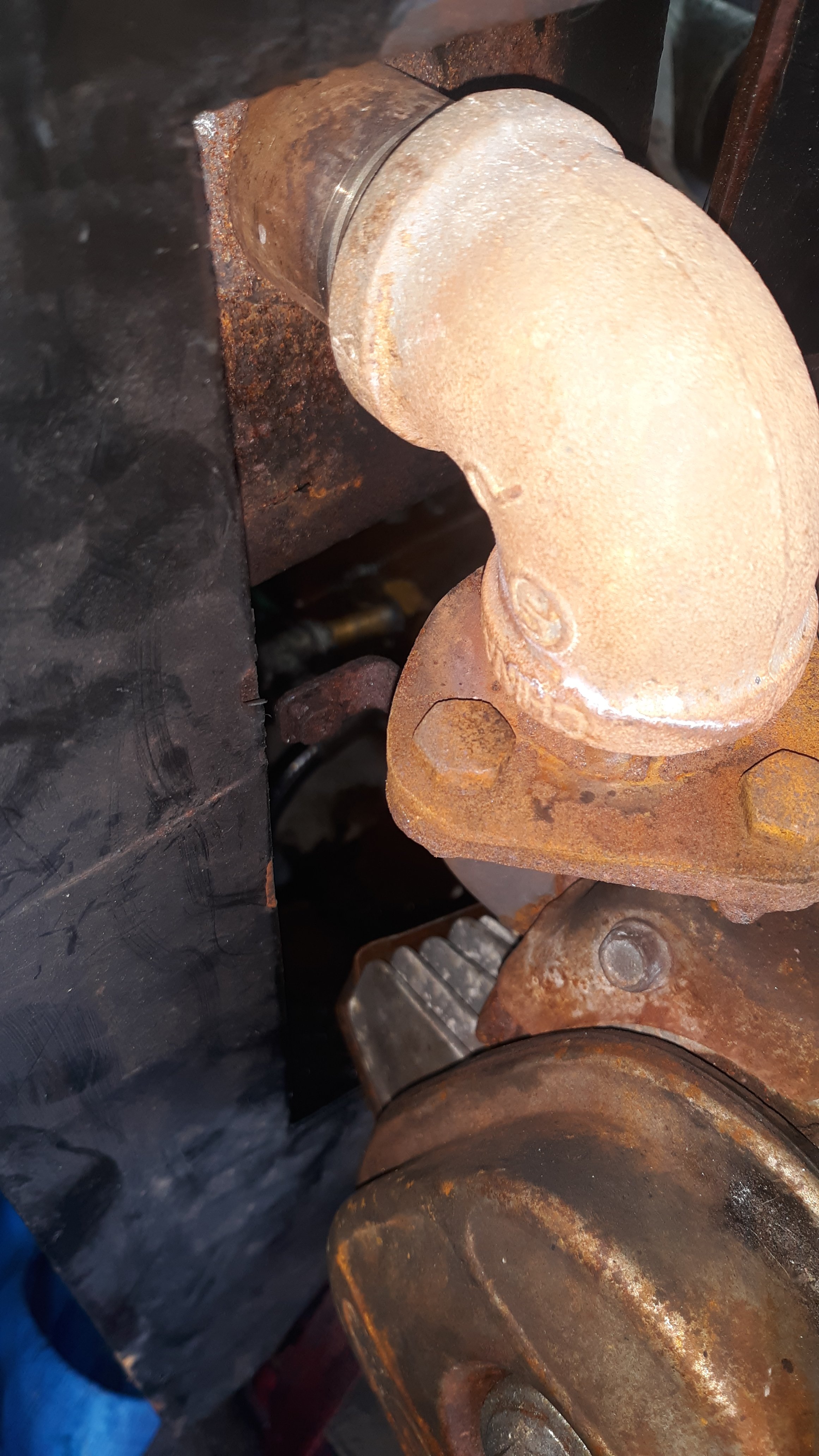

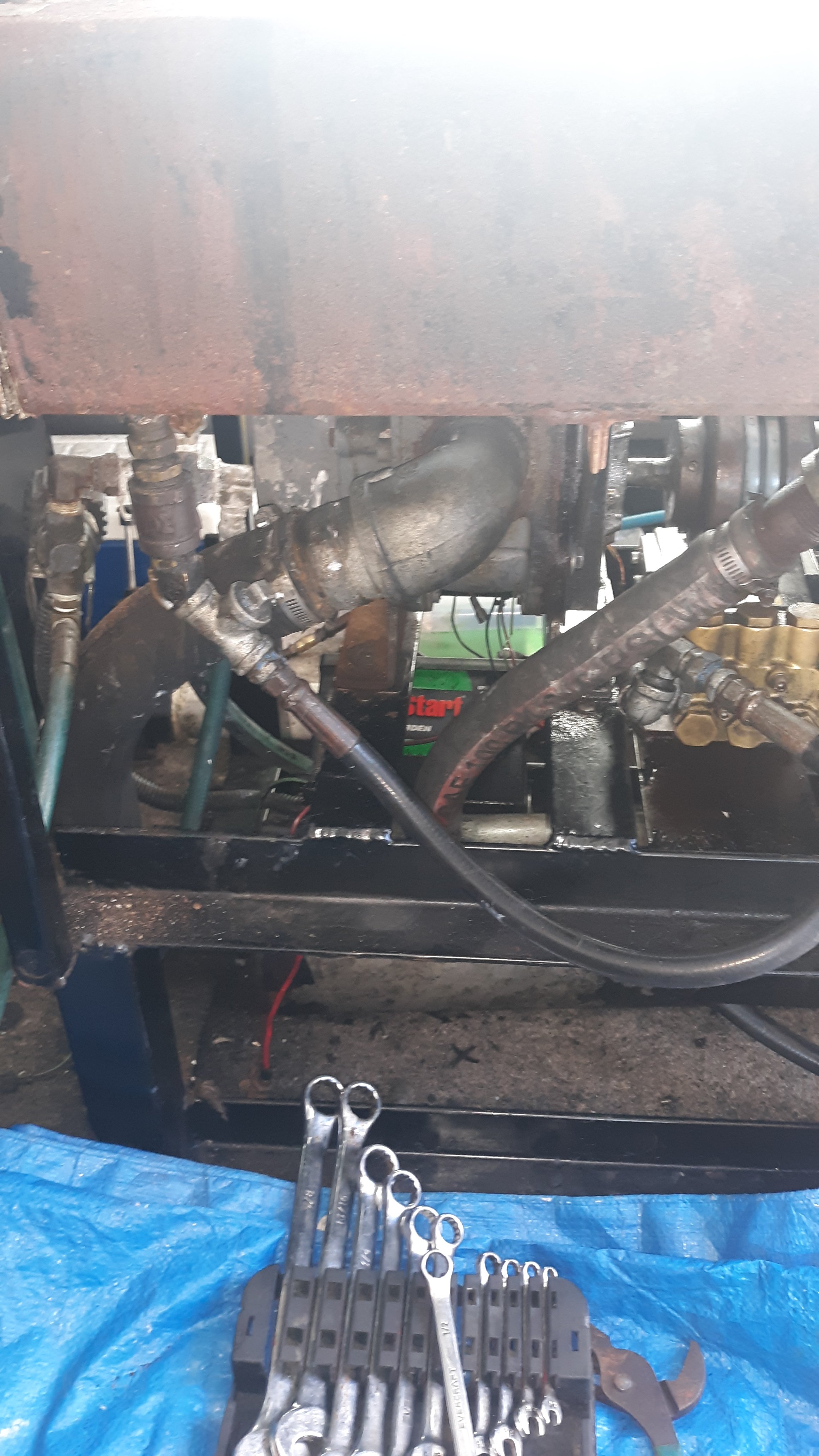

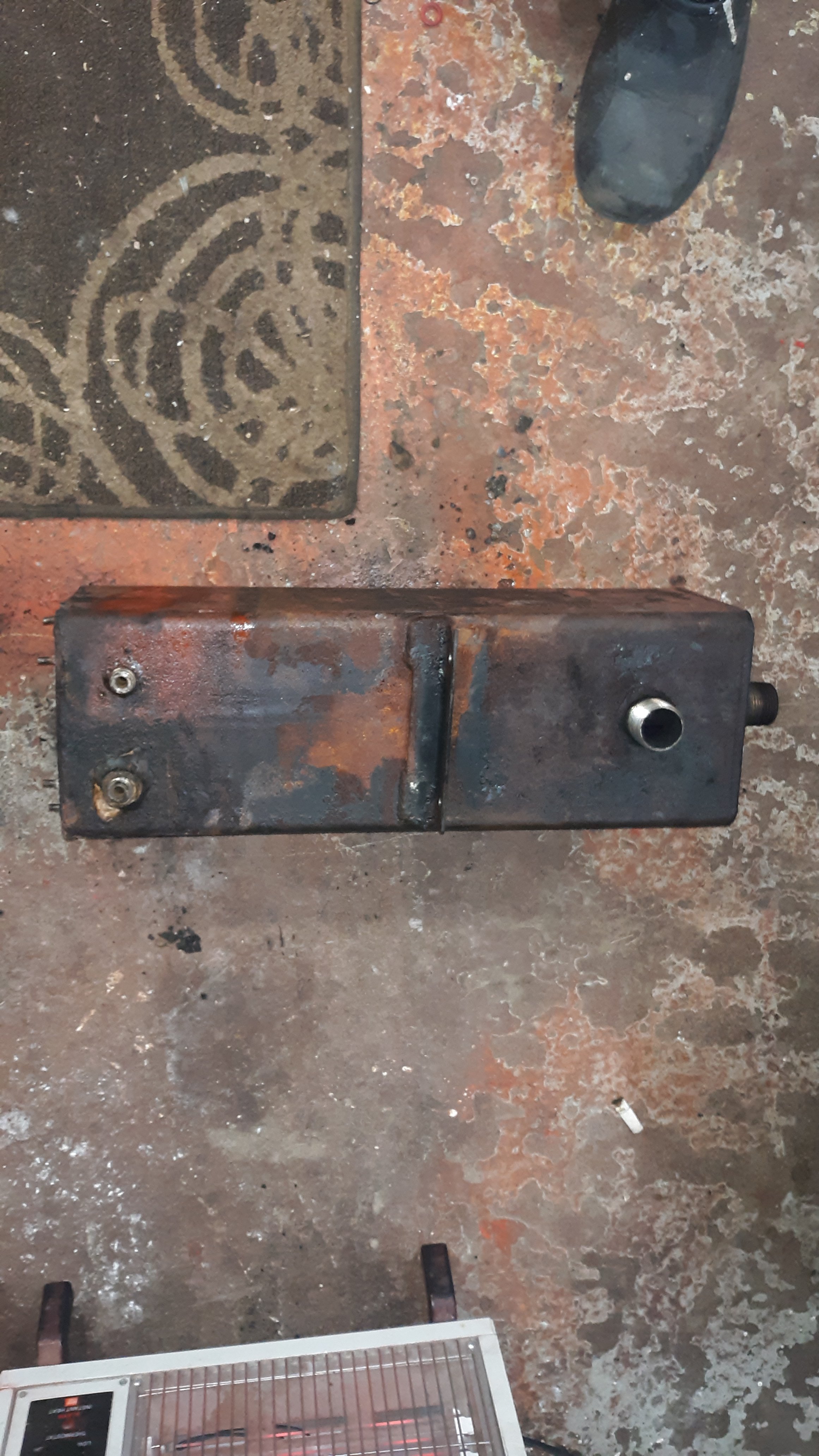

I'm having the same problem I have a chentex blackstalon. I'm not sure what to do about exhaust

I've got two Chemtex machines in my shop that came with a van I bought last year. A 20-45 and a 27-47, both with HX like yours. One end of the marine exhaust to to the engine exhaust and the other curls back to return through the frame tube to exit out the front, one on each side.
I've not tried to start them, I'm a diehard 4cyl guy.
