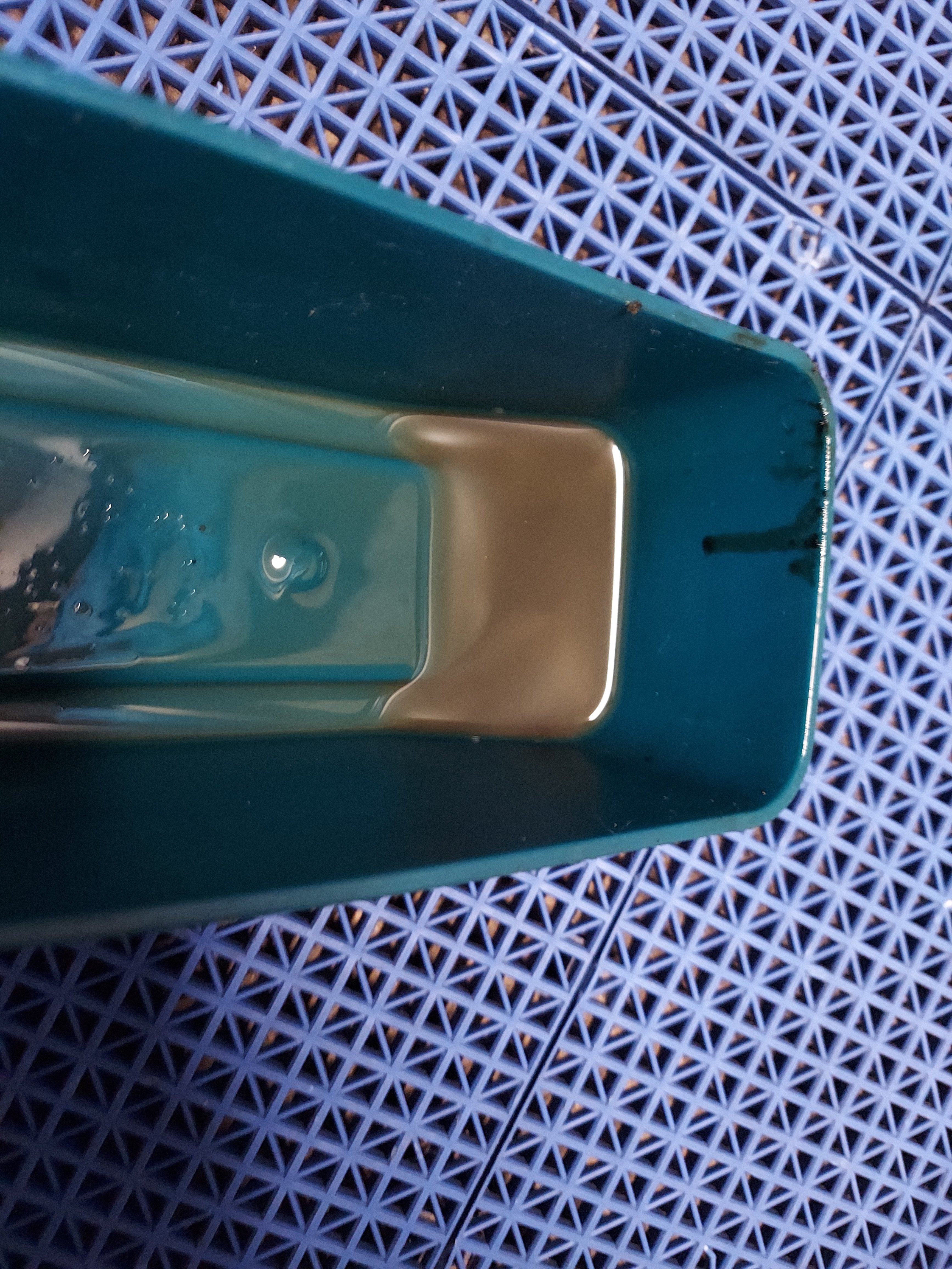

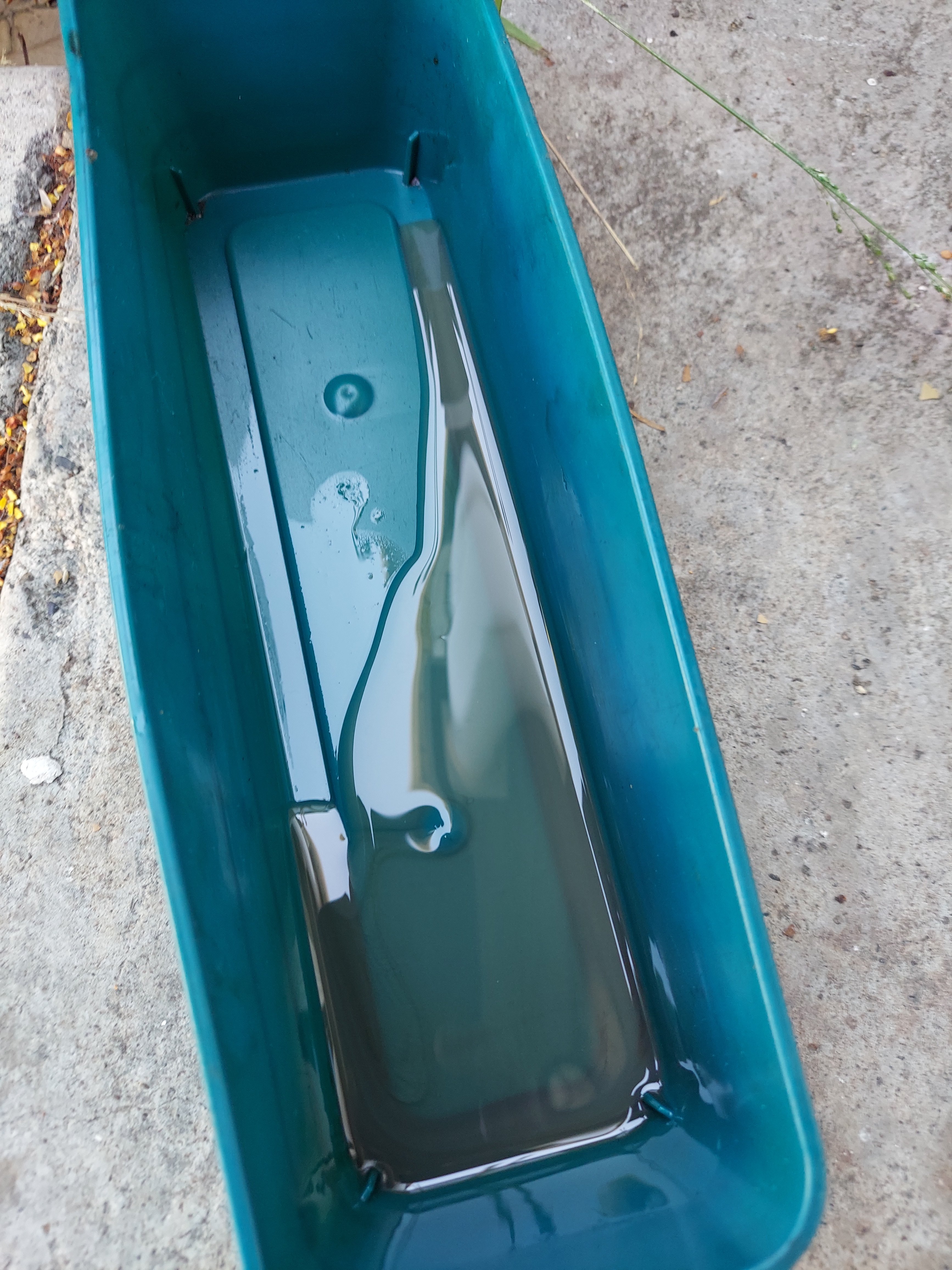

The machine works great now. I changed the belt and oil. :biggrin:

I think the system suffered a vaper lock of some sort.
The machine shut off when either the waste tank was full or when the water tank ran out of water. Which both happened.
I filled the water tank up, moved the van and began to clean again but the water pressure was low. I was thinking the system had too much air in it. I put a male QC to "drain the air" from the system through the solution outlet.
But I failed to check the inline filter which was clogged and not supplying enough water to the water box.
Everything I did just made the matter worse and was downhill from there.
In hindsight, I should have just checked the inline filter 1st.
This morning after cooling down the system started up and had pressure with no problem-- but I already had the machine apart so changed the belts and oil anyway.
That's why I think it was some sort of vapor lock issue.
