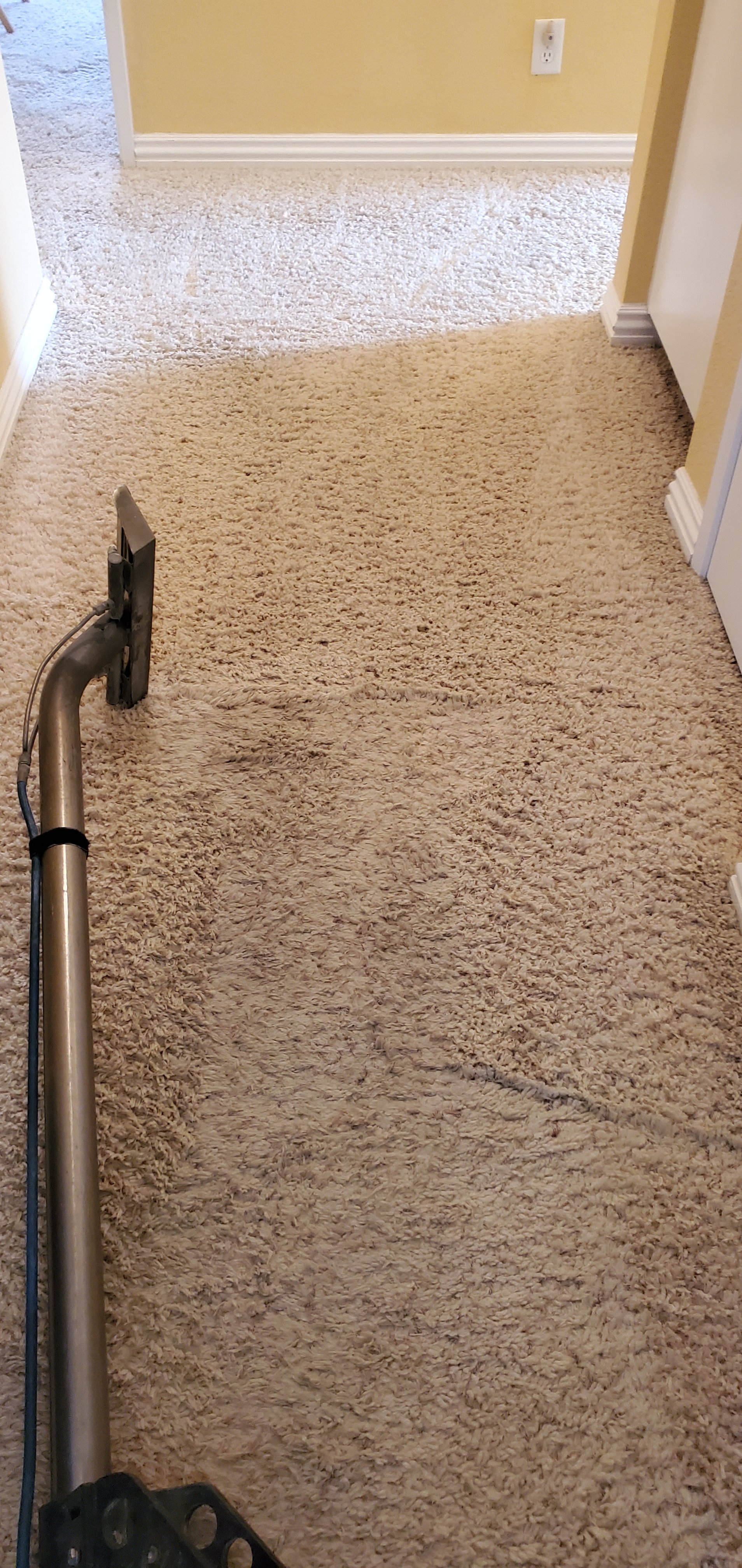

Well, 5 yrs after the original post, lol..
I lucked out and bought this used for $175 including shipping

The way it is now, it seems to have more airflow and clean better than my Antique Greenhorn wand.

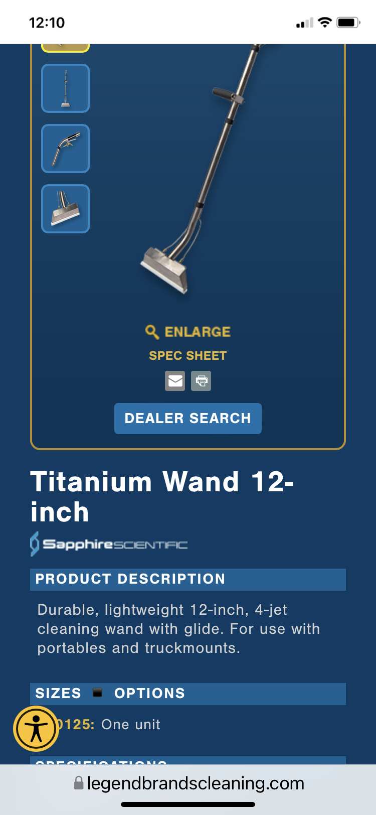

The SS12 would be the better choice but its $$..
