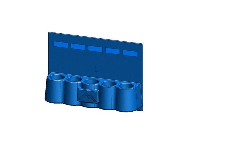

Working on a new 5-1 qt. bottle shelf will sell through your local dist. for about $25.00 each. It mounts to your van door or wall. Is this something that you guys could use or am I going off in the wrong direction? Please let me know what you think. Thanks.

Mikey, if you could sell that many. You'll get a six pack of this. One for the hand and 5 for the shelf.
Bob Foster
8,870
John please make sure it drains
If you can try and make it so you can see labels through it. Maybe a relief in the middle of the round that exposes even part of a label.
Can you also combine another use with it by adding other utility to it like block holders or even a big mouth jug holder below it.

I like it
Make sure it's not too long, so a double stack 5 over 5 can used

Funny you would have that. I was saying to myself the otherday that a good durable divider would be great for my shelving. I would prefer a good divider than that unit

Good ideas Bob. The area up above can have labels applied to it. A drain is easy. Maybe a second shelf design that held the sprayer and blocks or tabs or something would be good.

You mean like an inset for the Mytee gallon jug shelf to accommodate quarts?

yes. The shelves are great but I have to tuck my spotters that aren't in the kit between the gallons. I would prefer to have there own section

How many qt. bottles do you need to hold?

Not to complicate this but make it so you can just slide it off a locking mechanism so you can just carry it in the home.
Make another one blocks and tabs scrapper ect.

Ron K nailed it.....good storage for the door but portable to carry in.......
I would let Mike buy me one like that..........

John, The bottle holder is a great idea, I was going to make one out of plywood :oops: . Sign me up for four if you go with it. :mrgreen:

Looks great this can be very useful.
Being able to display the labels as mentioned above would be very important.

The shelf could have a bootie dispenser on it. Another thing you could build John is a shoe to put your wand head in when you are transporting the van. Most of the shoes you see now are metal and will only fit 12 inch wands. A roto shoe would protect the glide.
Another thing to build if Maker hasn't done it is a wrap to protect the bottom bannister pole on a stair. This shoud be spring loaded to open around a bannister and close "clamped" under pressure on the pole or pony wall. This also could be used around the edge of a door frame too.
A got a dozen more ideas most suited to roto molding.

Not to be negative, because I really like the idea, but is too much weight on the door a concern for the hinges? Or is 40-50lb not enough to cause a problem?
We had a solution hose reel mounted to the door and the weight caused issues with the hinges.
It eventually had to be mounted on a swivel to swing from inside the van.
Also the holders would have to come high enough up on the bottles that the don't tip out when the door is slammed.

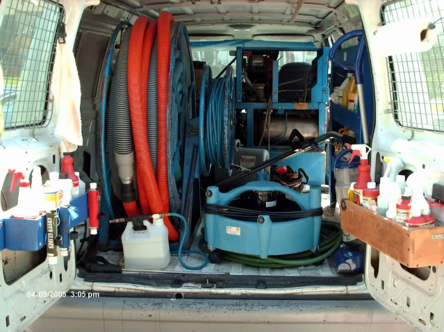

Make sure the parts that stickout dont hit peoples hose reels and make them not look as ghetto as mine look here is pic of all the crap i stuff in mine and yes there still is not enough room.
