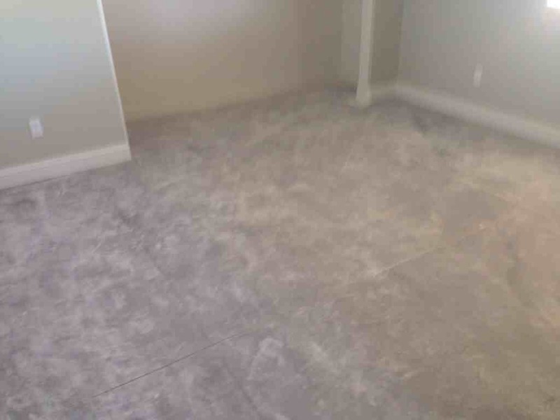

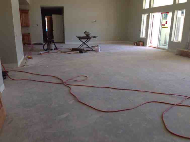

Owners asking builder to have cement clean construction dirt and dust 4000 sq ft
Sent from my iPhone using Tapatalk
11,387
What do ya do besides vacuum and steam with a glide big glops of crap should I worry??? This is why I stick to xarpet

Rinse and scrub. This one in the pics we just did this week we did at 800 psi because it was concrete, but you might rinse other surfaces with less psi. You will be able to tell by the amount of moisture you are loosing out the wand that could be more than needed loss.....

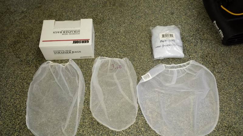

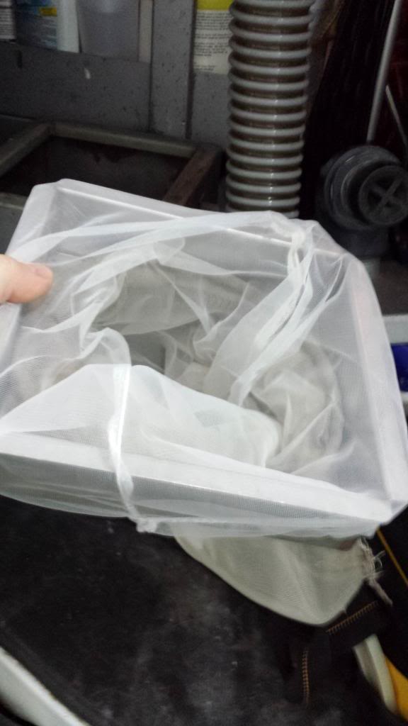

Also, you are going to go through filter bags....we use throw away paint strainer bags (5 gallon)
Not sure your going rate, but we charged .50 cents per square foot on this weeks, but looking at yours....It is going to be a lot more work!
Best wishes on the adventure, but you can get it done and make some money!
I'm getting the 5 gallon filter bags (that I make as throw away daily) from http://www.painterdeal.com/filter.html
Get item SB-501...the other numbers are for the amount wanted....you can also get 5 gallon paint strainers from home depot, but they are 3 times the price in reality. The ones on the right are the Painterdeal units. Much larger!

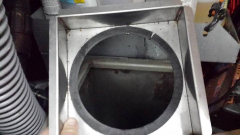

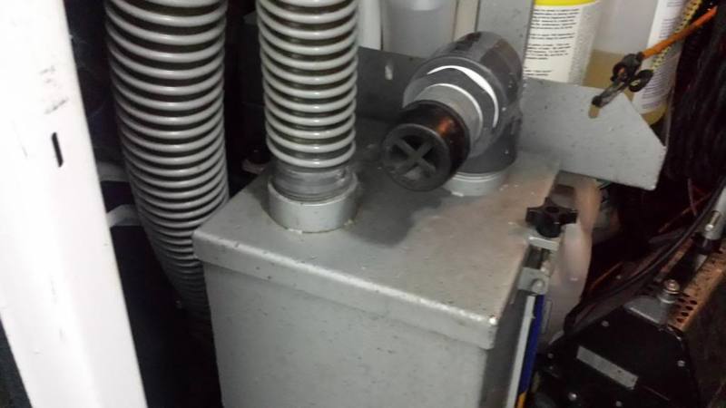

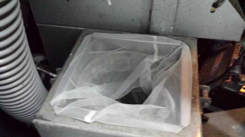

On my Butler unit rear waste bag clean out

Ya it's all cement they have some covered but dust and debree everywhere. Thanks for input. I don't know if there's electricity have to find out when they call
