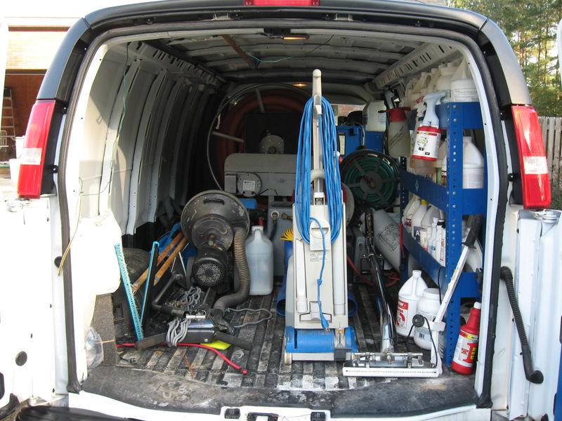

ascrubabove
Aug 19, 2008
472
Holly Ridge, NC
Air cooled 20 hp kohler, all the heat comes from the 3ht, may have too do like greenie said and put in some bigger jets, got the 11.5" prochem wand, just looked at the jets 303 stainless steel, they came stock with the wand, what size should replace them with?
TimP
May 19, 2007
4,055
I'd say you want to be in the .10 to .12 flow or higher.
How many jets does the wand have? if you have 4 jets at .03 then you should be fine with your flow.
TimP
May 19, 2007
4,055
Your temp gauge may not be working right. Cause a 3ht with 10-12 flow shouldn't hold anything over 220-230. You should get a 120 deg rise max based on above. unless the water coming in is above 100 deg which I doubt this time of year.
Greenie
6,820
You are reading teh side of the jet, read the top, it will say something like 95 01 or 95 015, you could bump slightly up to a 95 02 and you'll see more net heat with that 3HT, this would be a good starting point.
Personally if you are gonna throw out $40 for some new jets, I'd get 110 02 and buy some checkvalve jet extenders from Sunbelt or Les and get them jets a little closer to the carpet, ask for the "short" checkvalve jet extenders, the long ones are for the Titanium.
I'll try and get Les to post some New pics of the New TNT with improvements.
The Reactor is very reliable and simple for a HX machine, but nothign can touch the LP burner TNT for reliability, and return on investment.
Greenie
6,820
Tim, I won't say you are wrong, cause you really aren't, flow is a good thing, but I try not to give broadterm advice on stand alone heater applications.
His fresh water supply temp. is going seriously impact his net operating temps, while some are plenty happy with 180º water and higher flow, some have applications like a greasy restaurant where slightly less flow and high heat are desireable.
If he starts with 50º water in his tank (winter), and he is flowing 1.5 gpm through his wand, it will take all of that 120,000 btu heater to bring that 1.5 gpm to Boiling from 50º, and hold it there at 212º. If he increases to a full 2.0 gpm he may not be as happy with his less than stellar heat on a grease pit. It's all about the balance.

ascrubabove
Aug 19, 2008
472
Holly Ridge, NC
Gauge is correct, checked it several times while cleaning the pizza place. I stood next too the TM and keyd the wand for 10 min. Water temp did not fall below 230. Disconnected wand and hooked up a open end hose, let it run at full flow for about 3 min, same results!
TimP
May 19, 2007
4,055
Hard to believe you get 230 deg heat out of full flow of a solution line at 2-3 gpm. You would have just live steam coming out of that hose at 230 at that flow too.
Feb 8, 2007
1,660
89120
Jesse
Is that hooked up to the restaurants hot water, what's the inlet temp? If it wasn't 120-140 somethings not right, kinda like if your stock van was running 11's in the quarter mile.
Your gauge may be faulty, or you may have a bad fitting reducing your flow. I'd bucket test it to make sure your getting at least 2gpm through a open 1/4 hose and also try another thermometer.
Greenie
6,820
I estimate roughly: It takes 121,600 Btu per Hour (or 2,027 btu per min) to raise 1.5 gallons of 50º cold water to boiling in 1 min.
It's physically impossible to flow through an open hose at anything over 2 gal. per min. and get boing water with a #3HT.
Are you sure you didn't buy a #4HT? It has 50% more Btus avail, and makes a huge difference. What does it say on teh sticker on the side of the heater?
G
:shock: Am I the only one that worries about popping a hose with that heat?
ascrubabove
Aug 19, 2008
472
Holly Ridge, NC
I didn't see the water hookup cause one of the kids working there brought thier hose out too me, so it is very possible that it was a hot water hookup that they use to clean stuff up with, whitch would explain alot, also I was only running 400 psi as they warned me during the install "that was all the pressure the 3ht could handle". Is that true?
Greenie
6,820
A standard coil is 600psi sustained, and a high pressure is 1000 psi sustained.
yup...running preheated water would explain your scenario...mostly....lol
