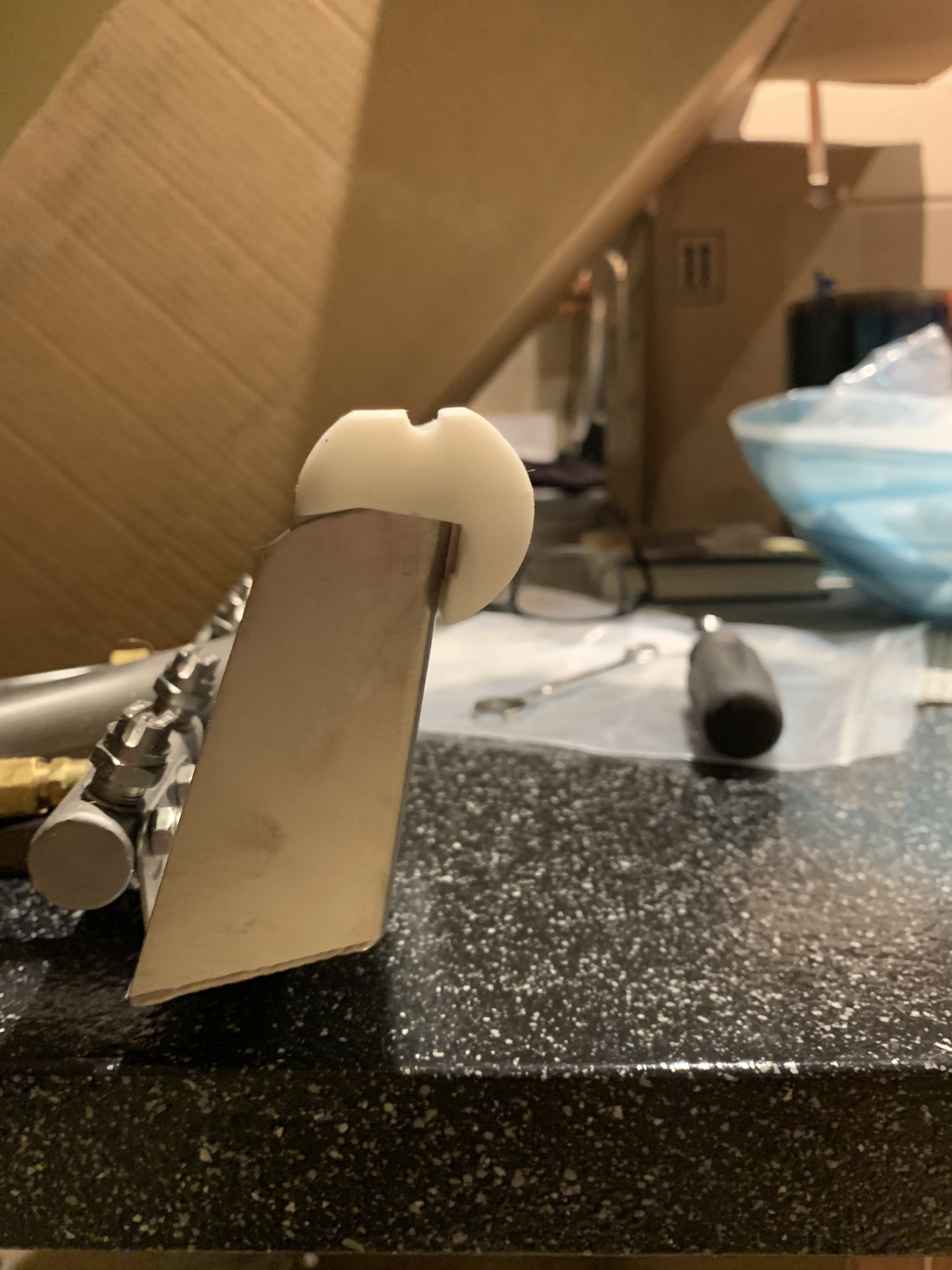

Stock at 4 flow. Should I up it to 6 flow?
Not sure I like swivel wands. I like to step on the wand end when I’m trying to clean edges/filtration lines.
116,018
Yep six flow is fine on that one and if it locks down on you get rid of the PMF glide on there that's too wide and it doesn't have any relief on the ends and get a greeny glide for it
These channels on the glide aren’t enough? The go all the way through the glide.

This newest wand is perfect for my height, 6-3. The Devastator and Bentley made me feel like an ape.
116,018
No, those channels are not enough as they will be buried in the carpet..
You see where you can't see the corner of the wand there? That's their way of keeping it from moving side to side. but it effectively removes a little bit of vacuum break that we design into our glides to keep the air flowing

No those channels are not enough as they will be buried in the carpet a lot of times You see where you can't see the corner of the wand there That's their way of keeping it from moving side to side but it effectively removes a little bit of vacuum break that we design into our glides to keep the air flowing
Thanks. I’ll try this glide tomorrow.

Worked three jobs with this wand today...
Mike, this kills me, but you were absolutely right about this wand.
It’s fun, easy and does a great job. The jet placement is perfect and it screams.
I’m not a bit tired and all three jobs were big.
I actually like the glide, except for it’s an eighth inch too wide on both sides.
It’s as easy as my Evolution, but actually digs into the carpet.
