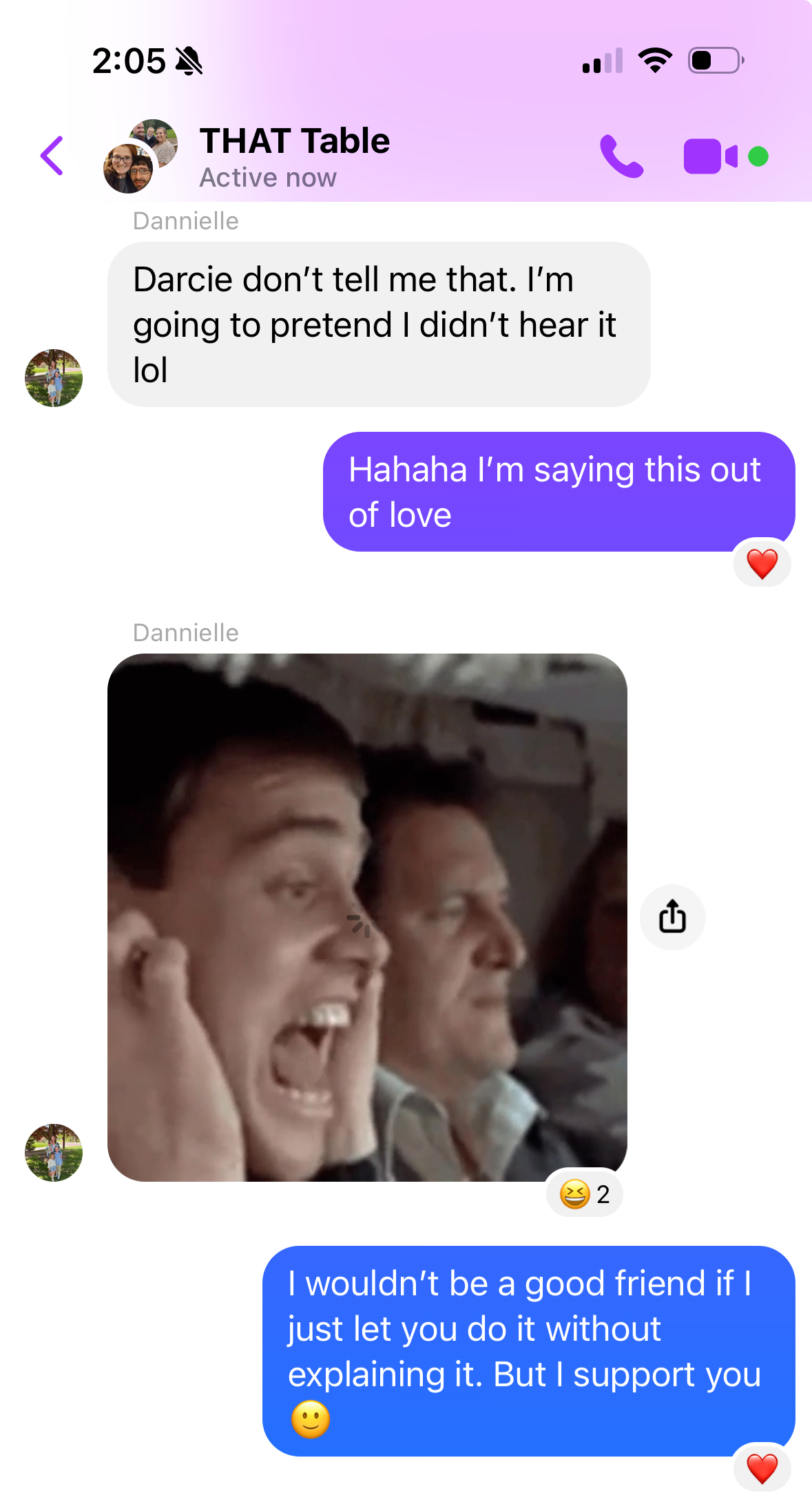

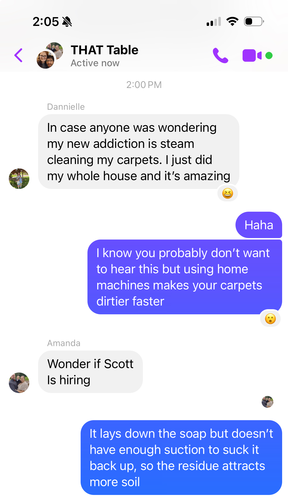

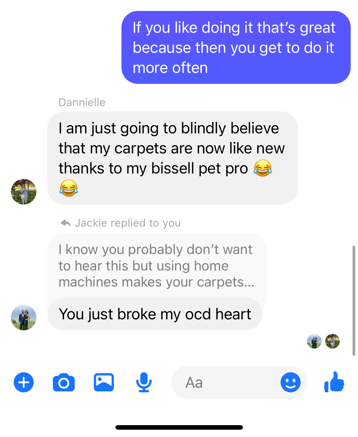

…just telling the hard truth to some of my local mom friends. This came up in the chat I have with four of my friends and I thought it might amuse you. I’m introducing them to the idea of truck-mounted cleaning slowly, three of them are stay at home moms who likely don’t have the disposable income. IMG_0918.jpegIMG_0919.jpeg
