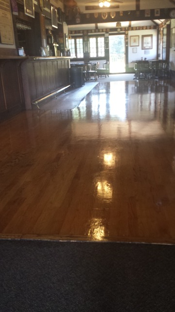

My Aptos house wood is done...
All that work just to let dust, grit and pooling fook up the finish.
Only a floor geeek like me would notice but good lord.
Dont skimp on the most important part for cripes sakes..

I did my house in Michigan and was out talking to a neighbor and looked back at the house and the dog was looking out of the window of the room (36'x20') of the room that
just received a second coat of finish. Needed to screen and coat 3 more times to get paw prints out.

Will it stay adhered to the old finish? That is not a real aggressive pad to prep with is it? I use Woodstar by Pioneer on some commercial accounts that is a floor finish that can be burnished and they recommend using a black pad. If I were doing a floor with conventional finish I would screen or use a 3M prep pad.
Keep us updated on how it works out, looks good thoough.

Economically is the key word. I'm getting really low on the product I have used and the costs and extra work involved scare me.This is spendy, but they have other great products, don;t see this as any different, I always 175 with a red or blue pad and ultras cleaner and conditioner. A clear water mop and dry and I'm good to go. I dunno about vct products on wood though as I don't know if they would adhere and how to go about stripping them.

You really don't want to use vct floor finish on a wood floor. It would look good when you are finished coating the floor but will not hold up for long.
The wood floor guys will hate you when they go in to do it properly. They have to strip the entire floor and make certain that they get it all off. The wet stripping can cause real problems.

Tacking the floor is what they call it.
After you screen use a damp flat mop over the floor with diluted neutral cleaner. What a few hours or the next day and do it again.
The first go around you will get the majority of the dust. The second will get the dust that was airborne after it settles to the floor.
