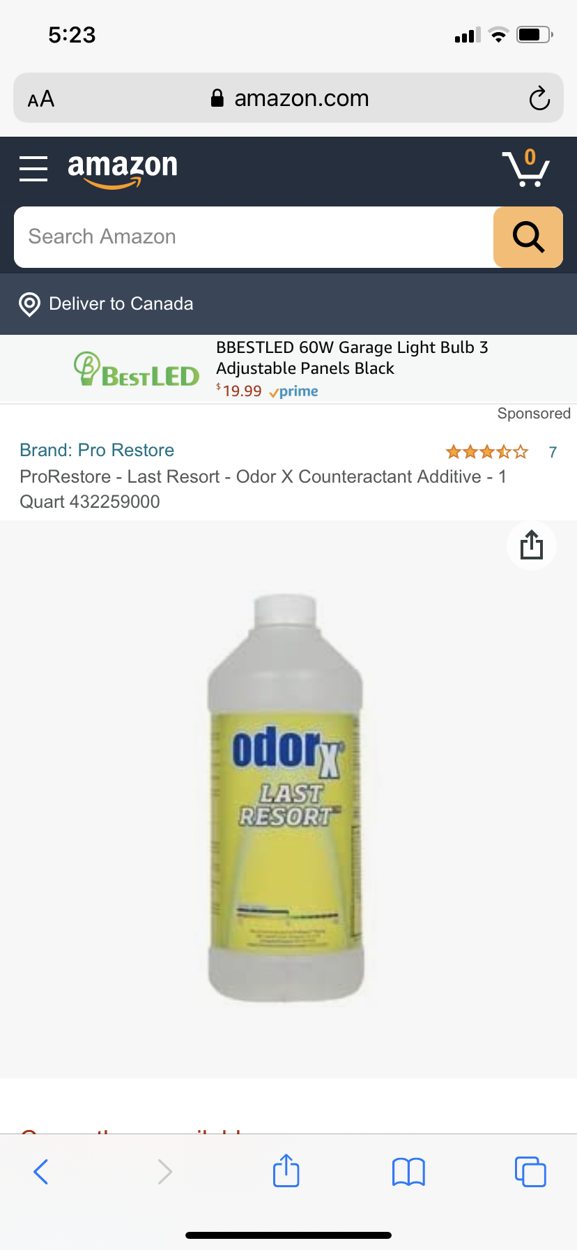

I’ve only used this the last few years on human vomit....
