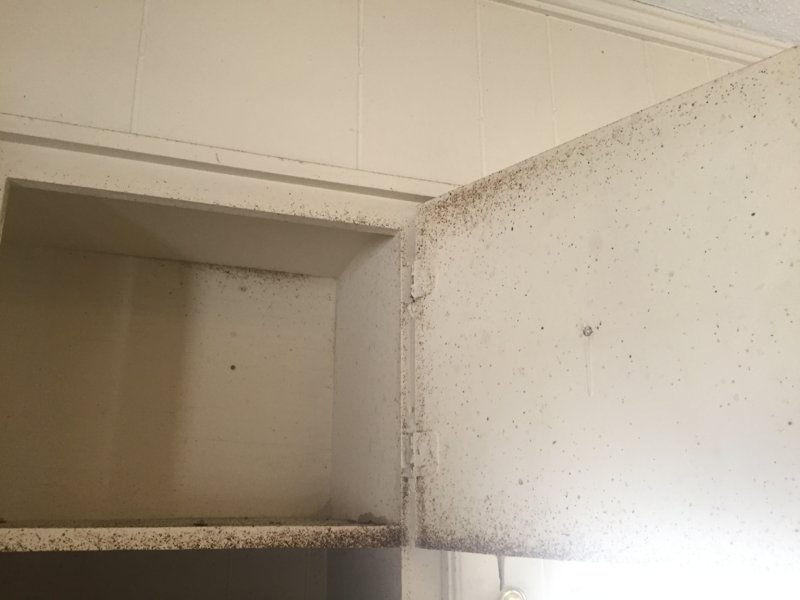

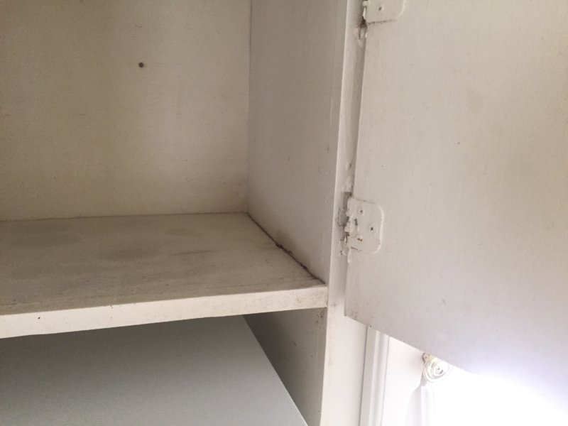

German roach feces contains up to ten times the bacterial count of human feces. It is dangerous!
Here is what we dealt with on Monday.

I've only seen it that bad a few times in my lifetime. Hope I never see it again
How much extra do you charge vs normal cleaning. How much extra do you pay your tech's?
Is it all touch concerns or air too?

It is hazardous. First, HEPA vacuuming. We spray a scary hospital grade disinfectant and let it soak. Then scrub, rinse and suck it off the surfaces. Repeat until clean. Rubber gloves, no dusting or brushing, good ventilation.
Dump the bags in the garbage bin outdoors. Flush the residues.
Open to suggestions.
