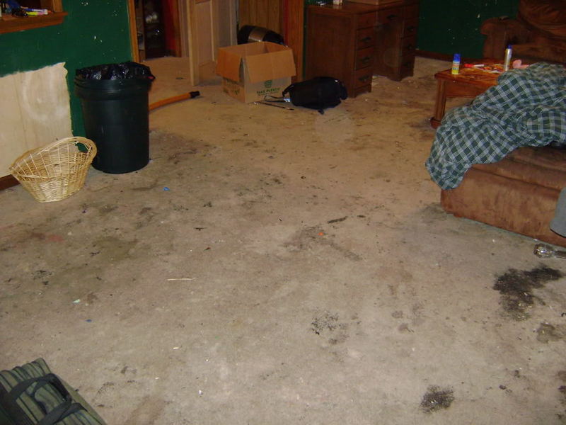

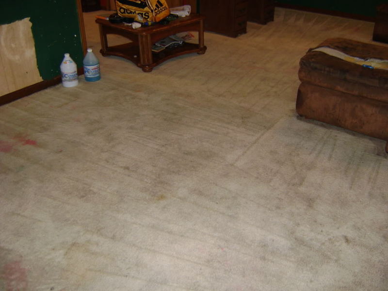

That was a definate prescrub with a 175.. it was about year and a half ago when the Judson's O2 contest was going on to get a free greenhorn wand. I ended up doing a second rinse with the wand and snapped my final pictures before I groomed it. That disqualified me from the contest. :evil:
This was some friends of ours who basically destroyed their carpet and simply had no money to doing anything to improve the situation. So hoping that O2 system with the old hot sauce modifier could work miracles and asking only fuel money. I offered to clean it up for them.
I kinda of wish I had the new hot sauce Modifier to mix with the O2. Here was the before and after I gave:
This was simply a mercy cleaning and it was definatly a huge improvement over the living condition they had. ( Notice the orange hose in first picture... I had to shop vac the place before I could even vac with my upgright.
I would have done some addittional redremoval but it would have probably takena bout a case of red relief and they were getting the cleanign darn near free anyways.
