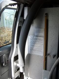

The 2.5 hose is BULKY... Cut 6ft off 2.5 hose ....& run it from the waste tank ....along
the floor..... beside the hose reel....out the side door....then hook to remaining 44 ft..
This is a much easier SET-UP...Rather than wrestling with the entire 50ft out of the
back door. Wrap the 44ft section up...bungee strap & hang on the LARGE hose hooks
provided on the fresh water tank.....

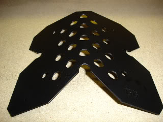

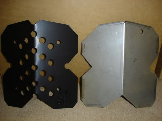

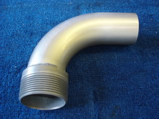

On the topic of Butler PRE-filter Box, here is a modification that is cheap and easy, just replace your stock bottom plate IN the box with the one I made, big difference in vac.
Then you can start addressing replacing your Gray plastic Spears fittings with thin walled gentle bend ones like the ones I make.
If you prefer to hook up out the back door, or have somehow moved your filterbox to the center so you can use it out the side door, then replace the spears 2.5' straight barb with a threaded 2.5 elbow, much easier to work with, and the Thin wall is better for airflow.

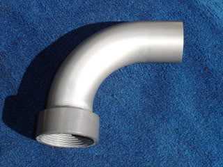

Now, I'm a big proponent of replacing 2.5 plastic with 2.5 metal, but on all of your (5.8 package) butlers 4007 blower, they will have 3" plastic elbows on the waste tank, on vac reel side it will have a plastic bushing bringing it down to 2.5" plastic barb, I don't have a problem with teh 3" elbow it's self, or the bushing, it's the actual 2.5 barb you gotta pitch, either repalce it with my threaded male elbow above, or one of these, much better for reducing restriction:

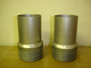

If you Skip the filter box, tehn jsut get one of these, and run 8' of 2.5 from tank to side door; and now you have a fixed 2.5 hook up. You can go down behind the reel to the floor, or up and over across the roof to the side door by fresh tank, some have even bolted it to the riser on their solution reel stack.

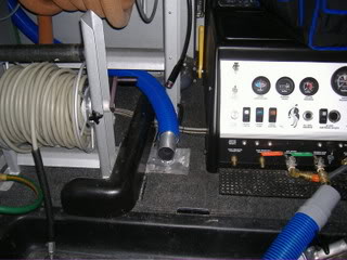

I elimanated Mach 1 also....un plug vac. hose & stick a Golf tee in it...."it is usless with 2.5"
I run 2.5 from the waste tank.....Like your photo....But..I run a little longer lead hose,so I
can still use the SAFETY PORT that Butler cuts in the side door....I like to LOCK the doors
when I am doing commercial work...or in "BAWBS NEIGHBORHOOD" :wink: :wink: :wink:
