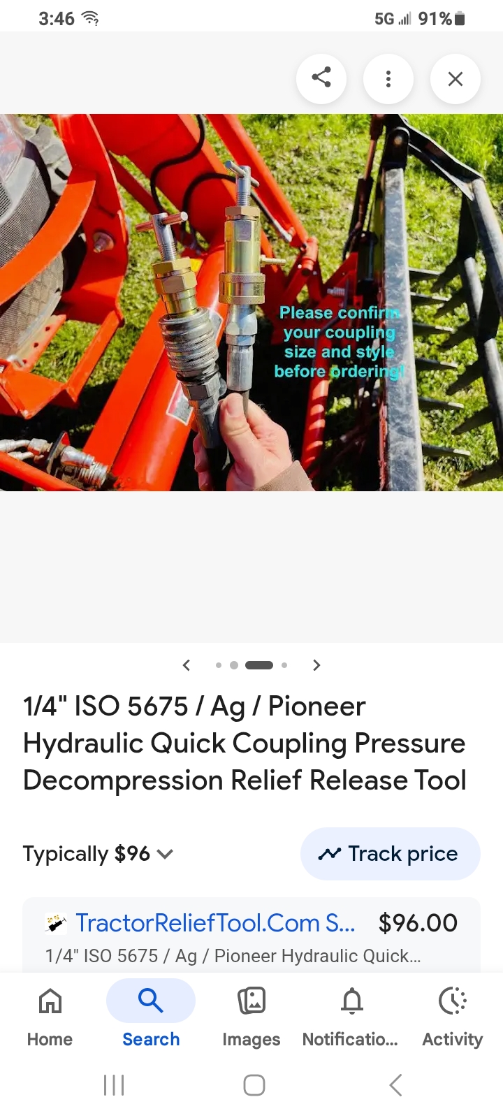

Well apparently I owe you an apology. According to my supplier they do make the tool you speak of. He says it looks like a quick connect without a poppet and instead of having female threds it has a flat area that can be smacked and a side hole for the pressure to bleed outa. Now ive seen and used a tool of that description for super high pressure hydraulic systems 3000-10,000psi that are positive displacement and can't be bled down without it. that had a screw to release nut they are a hundred bucks or so. but never heard of one for carpet cleaning nor would i ever imagine that anybody would consider a 100.00 tool to relieve pressure on a carpet cleaning hose. Not even me and i have a special tool for everything imaginable. Heres a picture of my drawer of just specialized disconnect tools! So sorry for mocking you. But if youre really looking at high pressure hydraulic disconnect tools and thinking seriously about buying one please consider also picking up one (or more) of my special metric crescent wrenches. They now come in metric and standard combos🥸

View attachment 134555 View attachment 134556 View attachment 134557
I sense that deep down, you really want a pocket pressure popper thingy. Maybe I'll get one with some radioactive green color on it 🙃 and you'll see the light. I'll keep you posted Dwain-o.

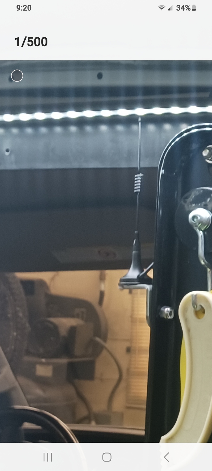

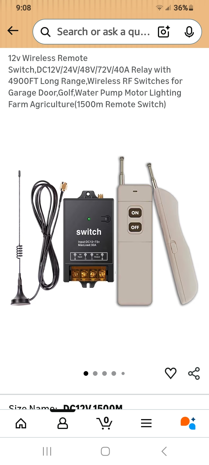

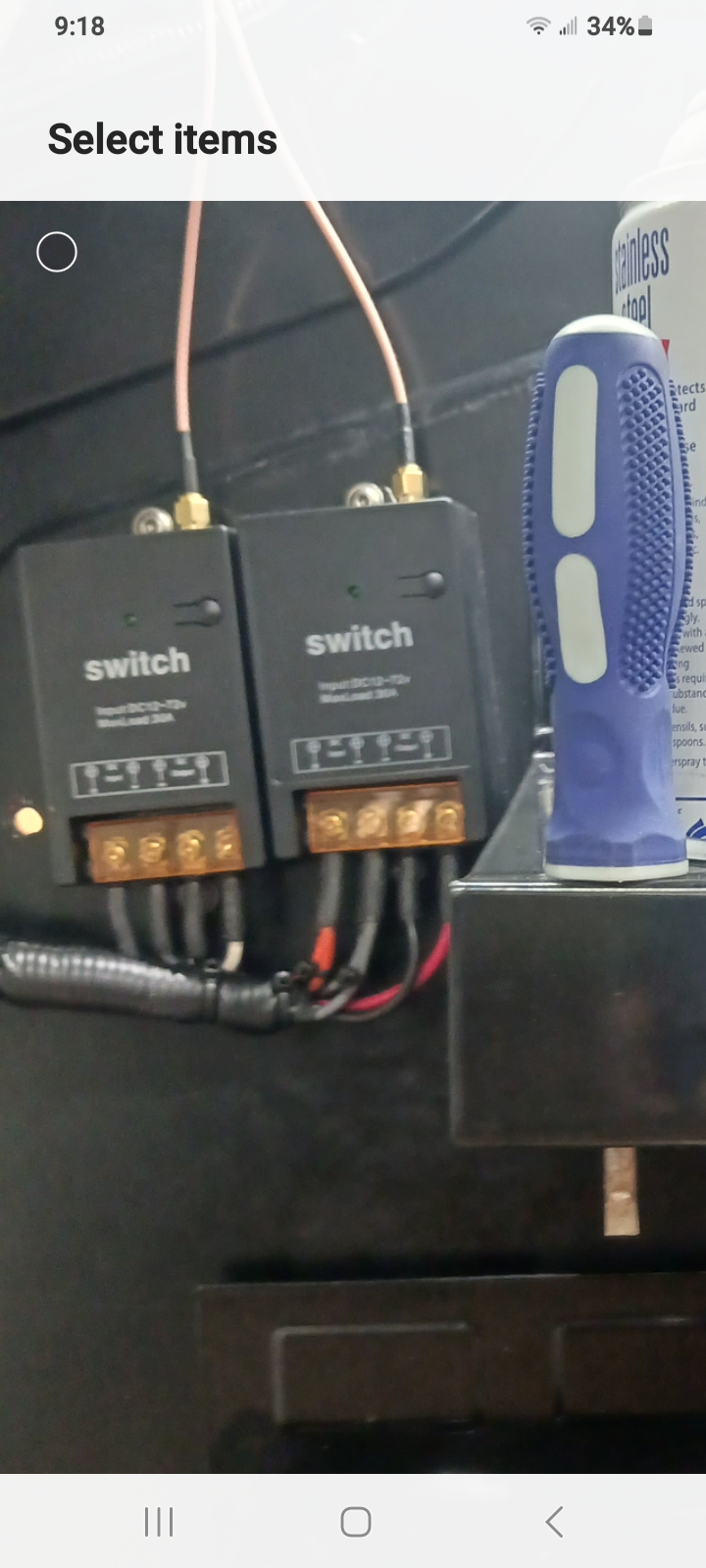

Ya know for 40-90.00 and approximately 1hour of work you can install a remote start stop on your machine. I installed one on frankinstien, loved it so much i installed a second one on the pump. I can remotely shutdown and turn back on the whole machine or just the pump from up to 1900' away. Cant pop the quick on?...... push a button on a key fob and hook it up push the button again and resume work ask Nate, he's got one on his machine and can give ya the name of the guy that came up with this idea.(not my original idea) That guy has one on his hydramaster cds too. They start at around 20.00 i prefer this 35.00 model, it has a much longer range. I wired mine to the wastetank float switch so it tricks my machine onto thinking the wastetank is full and shuts down just like it would if the wastetank was full. Much much cooler and far more useful than a pocket pressure popper thingy
