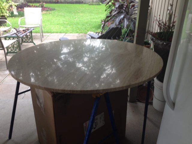

Gentlemen:
I am new here and seeking some expert advice. I have a table with a round Travertine top that has been in the family for about 60 years. It has gotten dull looking all over, with what I guess you all refer to "etch" spot areas that are a little worse. I have been looking all over the net for info and products to try to re-polish it; and finding lots of info that is sometimes conflicting. Most of the products only come in large bulk quantities to do hundreds of square feet of flooring etc. Some recommend dry polishing powders, and others the paste type compounds. Some contain acids, that require special neutralizing rinses; and I worry about getting on the wood. Others seem to involve diamond impregnating pads and use a very low rpm polisher that I do not have. My question;; .... is it possible to re-polish and put a fairly even shine (doesn't have to be a really high gloss; just even looking again with some shine) by maybe using a wet/dry 800 grit sandpaper and wet sanding it? Table top is about 3' in diameter. If this is possible; would it be best to do by hand, or with an orbital sander?

I would like at least a little shine, but don't need a high gloss. Mainly an even appearance. It has gotten dull all over; but when the light hits it right there are definitely spots that appear worse like something maybe spilled and set a while before clean-up. Nothing really bad or any bad scratches.......just the dull, splotchy look.

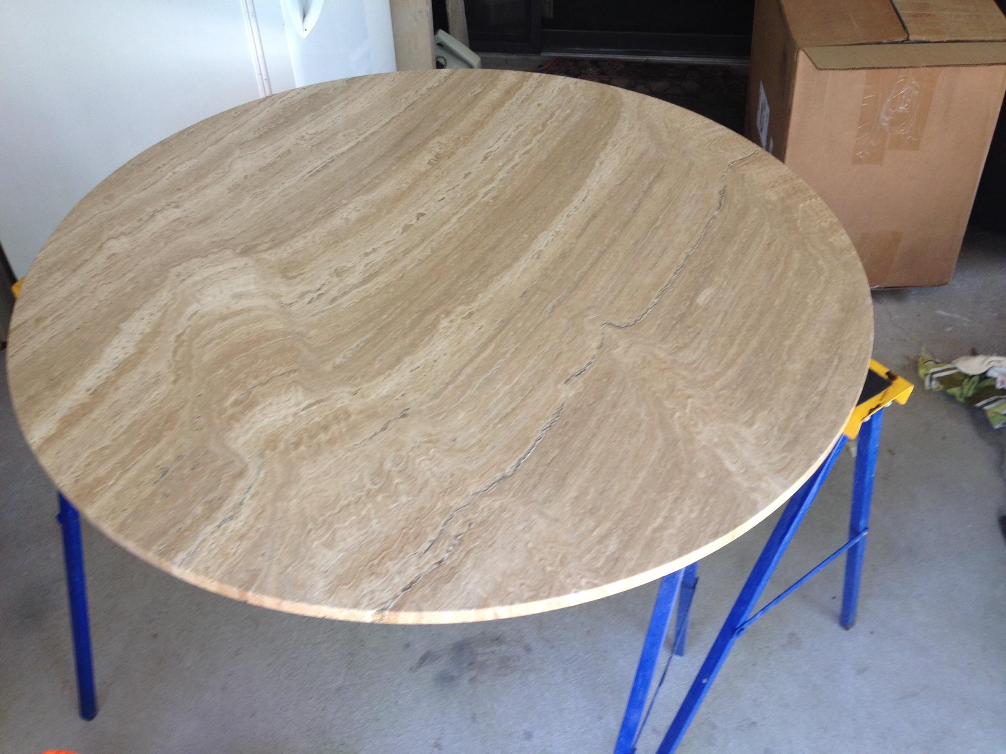

You obviously missed your natural calling; should have been a baseball coach. LOL I followed your advice to "swing for the fences"; and I seem to have hit a Grand Slam Home Run! I had gone by my local Harbor Freight to get a cheap orbital palm/hand sander, figuring the rock/stone dust would have the same effect on my good sander that pouring sand in the crankcase of my truck would have. They also had combo packs of 220, 500, 1000, and 1200 grit wet/dry silicon carbide for CHEAP and it looked like good quality stuff, so bought it. On to the local auto parts store and picked up 1500 and 2000 grit which was the finest they had. Spent about 5 to 5 hours on it and it looked REALLY GOOD. Decided to try and find some 3000 as you suggested. Found one place with 2500 so went and got it. Went through all the grades sanding dry. Did a final polish wet with the last of the 2500 grade. Now it looks even BETTER! I was only 9 when my Mother got this table; and that was 60 years ago; so I can't remember or swear to it for sure, but I don't think it was this shiney when it was brand new. The picture attached below is just wiped off and cleaned with NOTHING on it. It was taken against a very overcast sky a little after 6:00PM. You can see the reflection of that large oak tree in it nearly like a mirror. I actually noticed a squirrel running on a limb in the reflection when I was fixing to snap the pic. Believe it or not, that little $11.00 (with coupon) "Drill Master" sander held up like a champ and completed the job running strong....surprised the Hell out of me! Now I have to decide which direction to go from here. Do you have any more good advice to seal, or not to seal, with one of the many stone seal products I have seen; or any other finish protector or polish to put on it?

Looks great.

No; it has always been an inside living room/den "coffee table"; and I guess will continue as such as long as I am alive. The slab sits on 3 trestle type pedestals on a round wooden base, forming an open type table. My Son had it for the last 8-9 years after my Dad passed away. Don't know what the Grandkids may have spilled on it; or even what damage my Mother may have caused possibly using the wrong cleaners on it. I have some 511 Impregnator Sealer made by Miracle Sealants that I bought a year or so ago to seal some tile and grout that seemed to be absorbing water. Seems to have worked; but also seemed to have dulled the tile somewhat. Is this typical for all sealants to dull the shine a little; and would this be an acceptable product in your opinion? (It has Marble and Travertine listed on the label.)
As a side note that may be of some future use to all of you doing stone work. Some of the original filler in the voids had chipped out in places; and I guess the Grandkids had made the new chips and pock marks in other spots. I was looking at the Stone Pro Traverfill to repair; but it was going to be around $25 for 1 pound shipped; ....and I didn't need but approximately a teaspoon full. I bought a stick of the J. B. Weld Kwick-Wood epoxy putty. Cleaned all the spots with acetone and a Q-Tip, kneaded the 2 parts of the putty together, filled the voids, and scraped/cut off flush with a razor blade. It came out perfect and the light tan color matched the stone's natural color way better than the original dark brown filler. Dries to a very hard epoxy in a couple hours that can be sanded, stained, drilled, etc. Maybe a 15 minute work time before you can feel it starting to set up. You have to really look for it to find it; and simple to work with. Guess not knowing what you are doing sometimes pays off if you are willing to take a chance and experiment with things; ....but then I grew up having to learn to improvise. LOL
