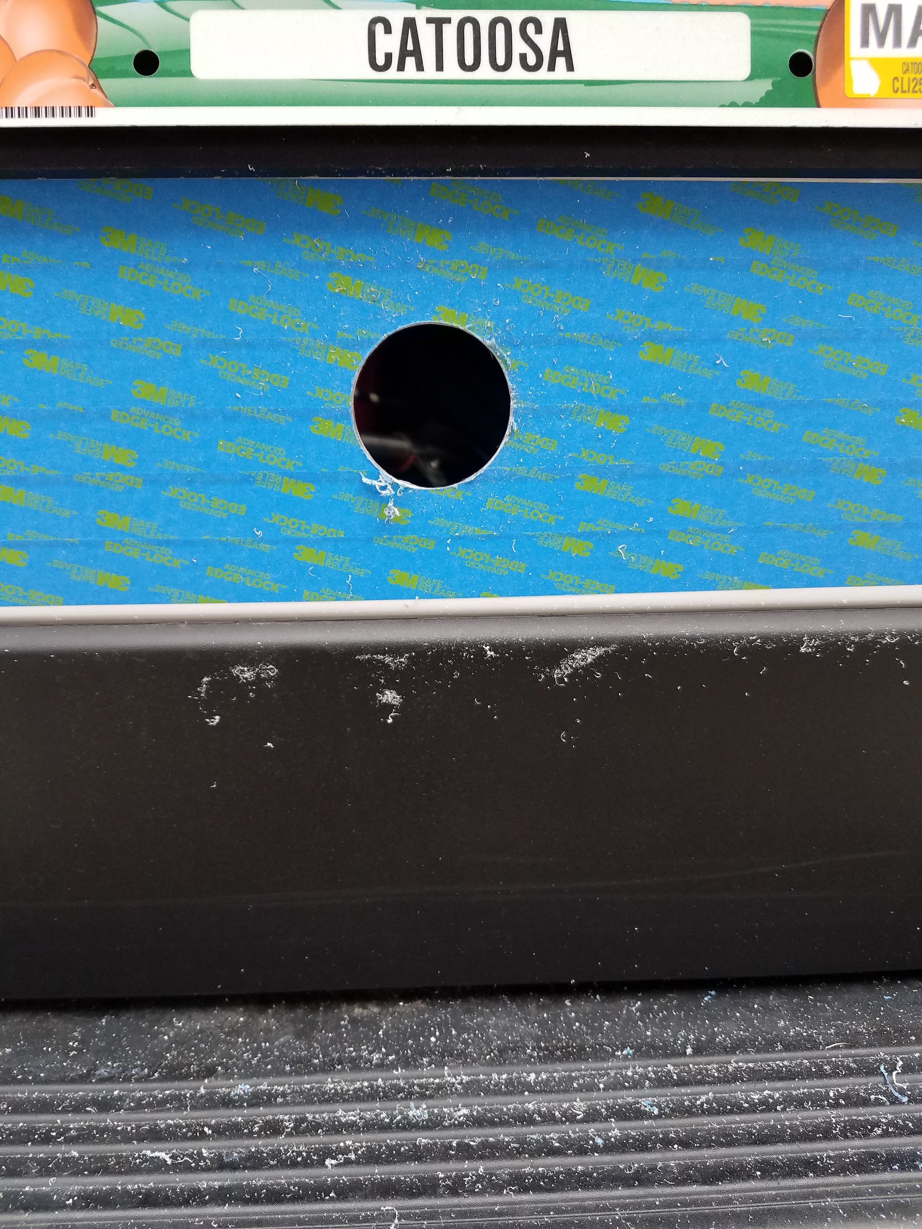

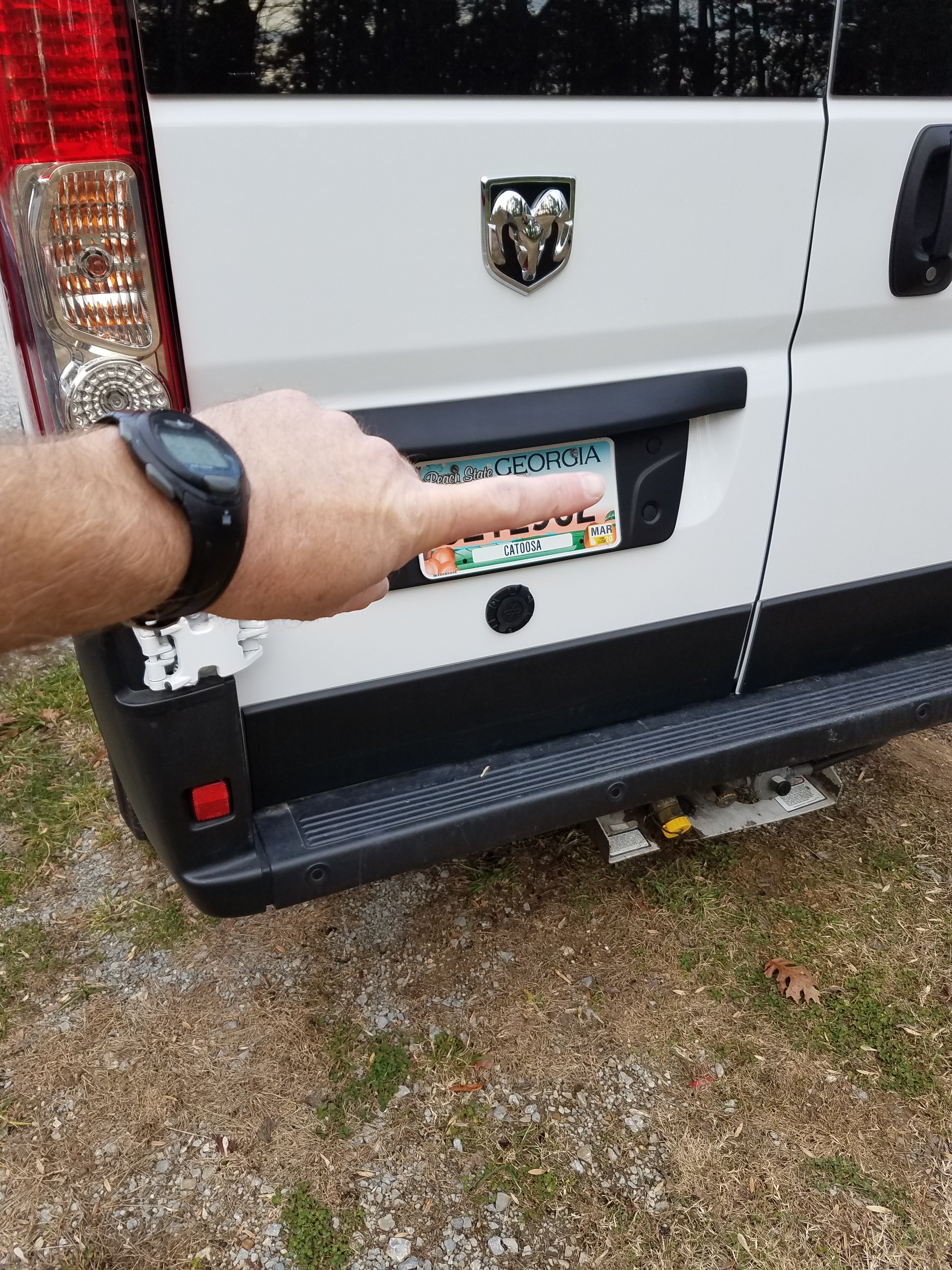

So I first saw these on Ford diesel forum for use in bumper for block heater.
Just put one in my back door of Promaster today for ease of Electric heater plug in.
Amazon for around $15 GCP1 AC plug
No more cord pinch in door.
In hindsite I didn't think about the door being in weather during rain. Later I will have plywood on the door and will put a RV accessed hole in.
Outside has weather proof tab/lid.
For now it will work.

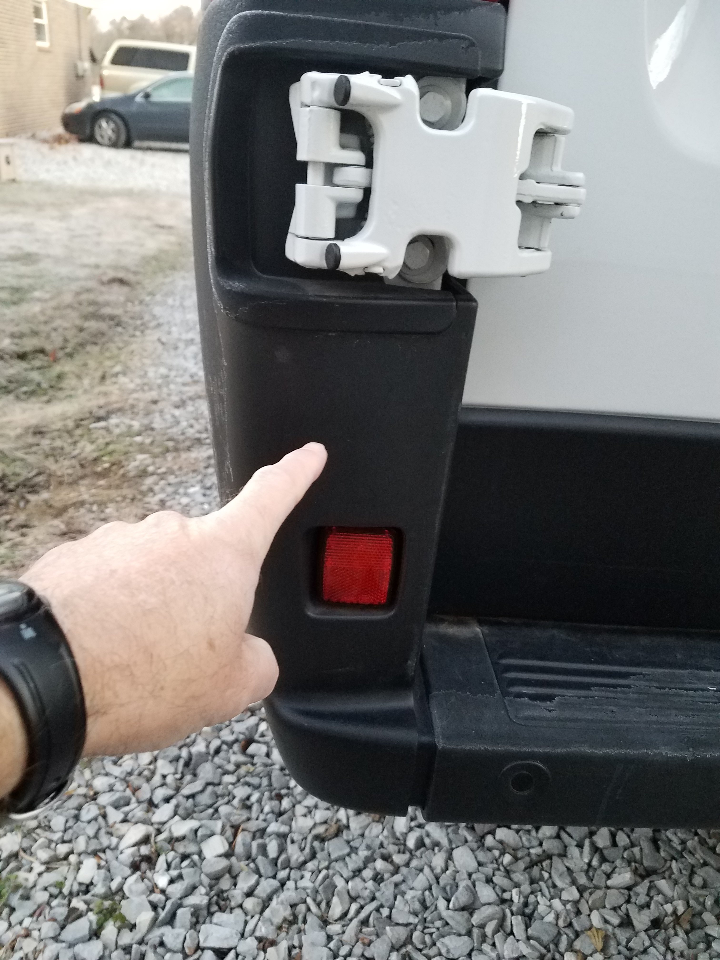

There is a better spot to install it without drilling through the door. I'm installing mine in the left lower corner of the bumper corner above the red reflector. From there you can get inside the van, no drilling through the metal.
Show me

Here ya go DAT
I just wonder how well the screws will hold in plastic over time.
My friend told me about that location but looked like bumper cover and metal to make holes. I will investigate with flashlight later today.

Damon what your talking about is hole in bumper cover then punch out the air pressure vent or cut it for the cord.Tight to reach in inside that space. Especially if you need to add screw and nut to fasten later.
DAT I used a 1 3/4 in hole saw. If you put it on side of rear the female won't be in the weather if raining while cleaning. I thought about over the wheel well also.
Think about vinyl lettering if you have any or adding some.
I think these past thru plugs are pretty tight once screwed in. Could also add some silicone caulk for extra seal.
