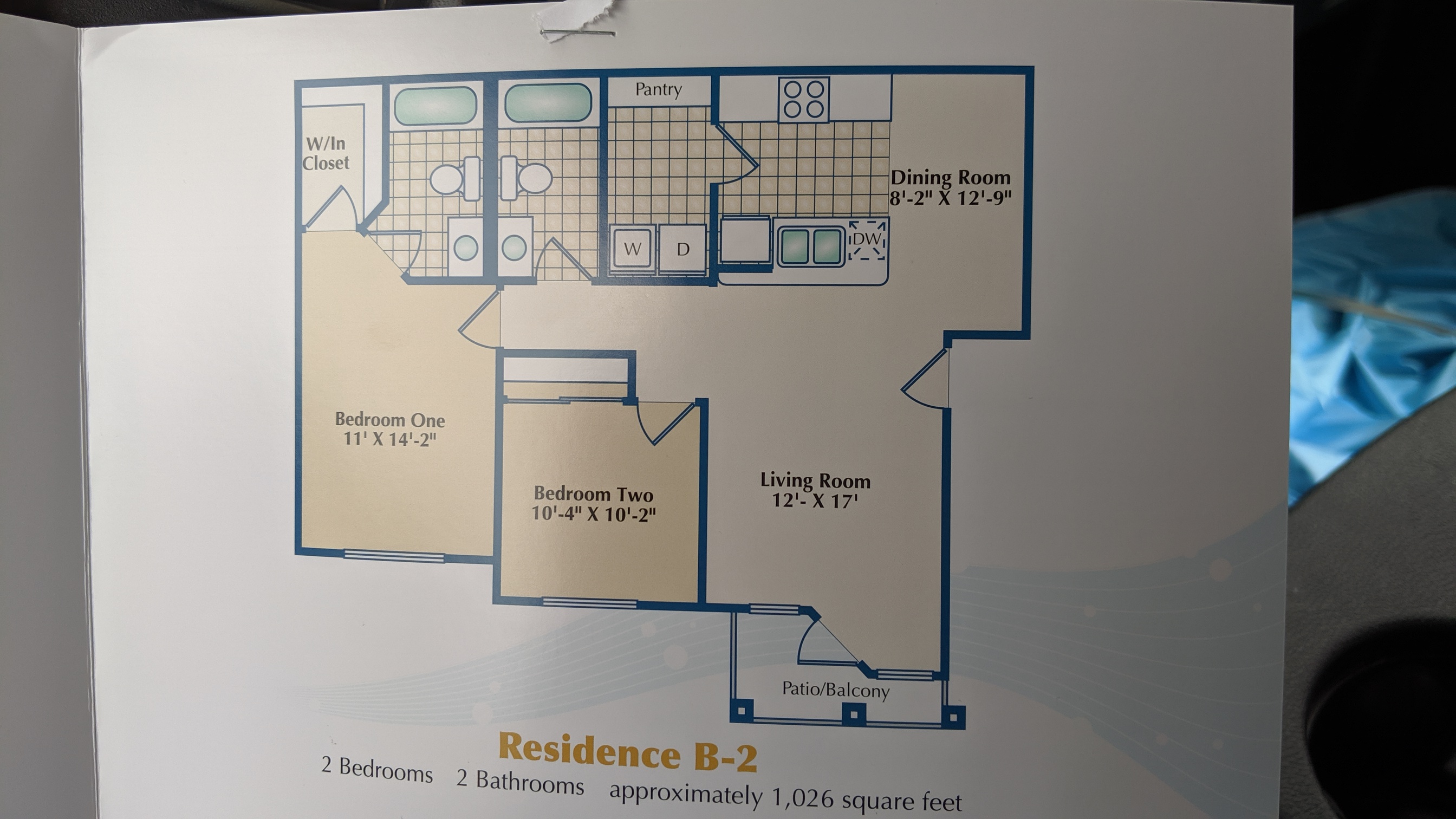

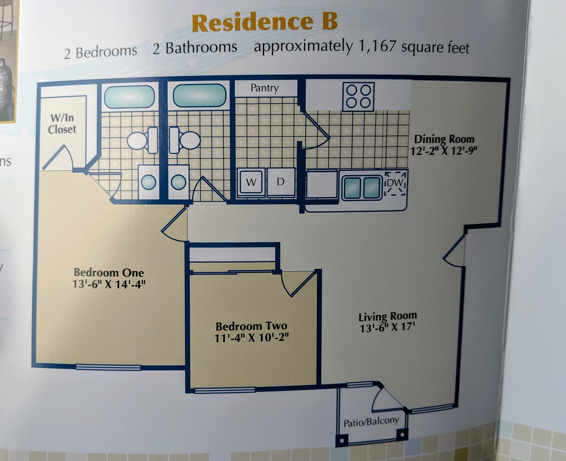

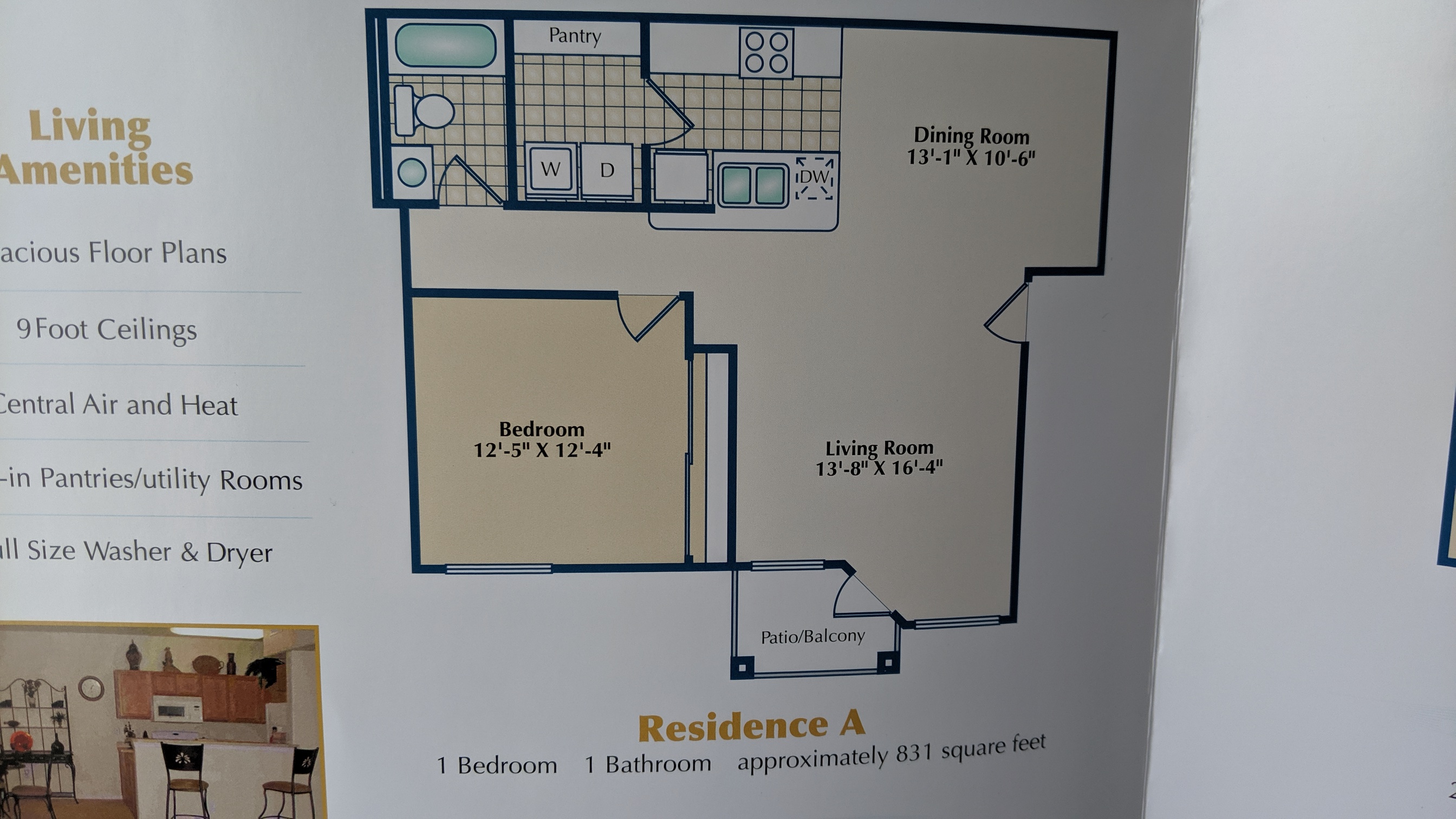

I've never been an apartment guy but this 130 unit complex called. I'm feeling the Yelp hit so I went and took a look.
They allow pets but replace the carpet if damaged.
3 story buildings, no steps in units
Currently paying 95 to 125 but not happy with the results
Access is decent, nothing over 200 ft
What's you price on each floor plan for a do what ever it takes cleaning?
