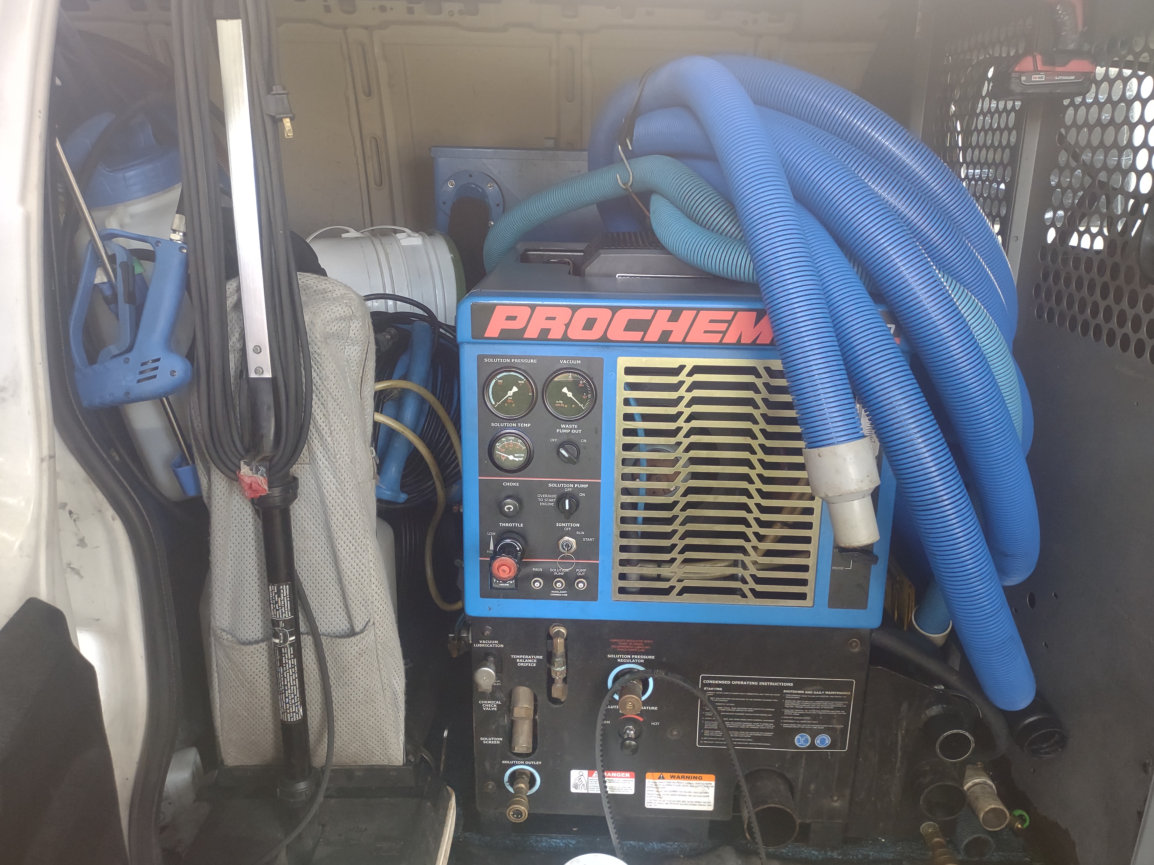

Check the Lint trap and blower filter.
Check and change the blower oil.
Clean the "blower relief bolt"-- these are the bolt you remove to fill the oil and has a little hole in them.
Organize the van better--
Maybe the hoses are dripping water onto the belts and pulleys.
Wires and hoses can also be accidentally disconnected when cluttered like that, and this lowers your curb appeal.
11,288
Blower filter can get dirty need to be rinsed.
Maybe there's blockage somewhere send a towel through the system.
If it ends up where it's supposed to your good
