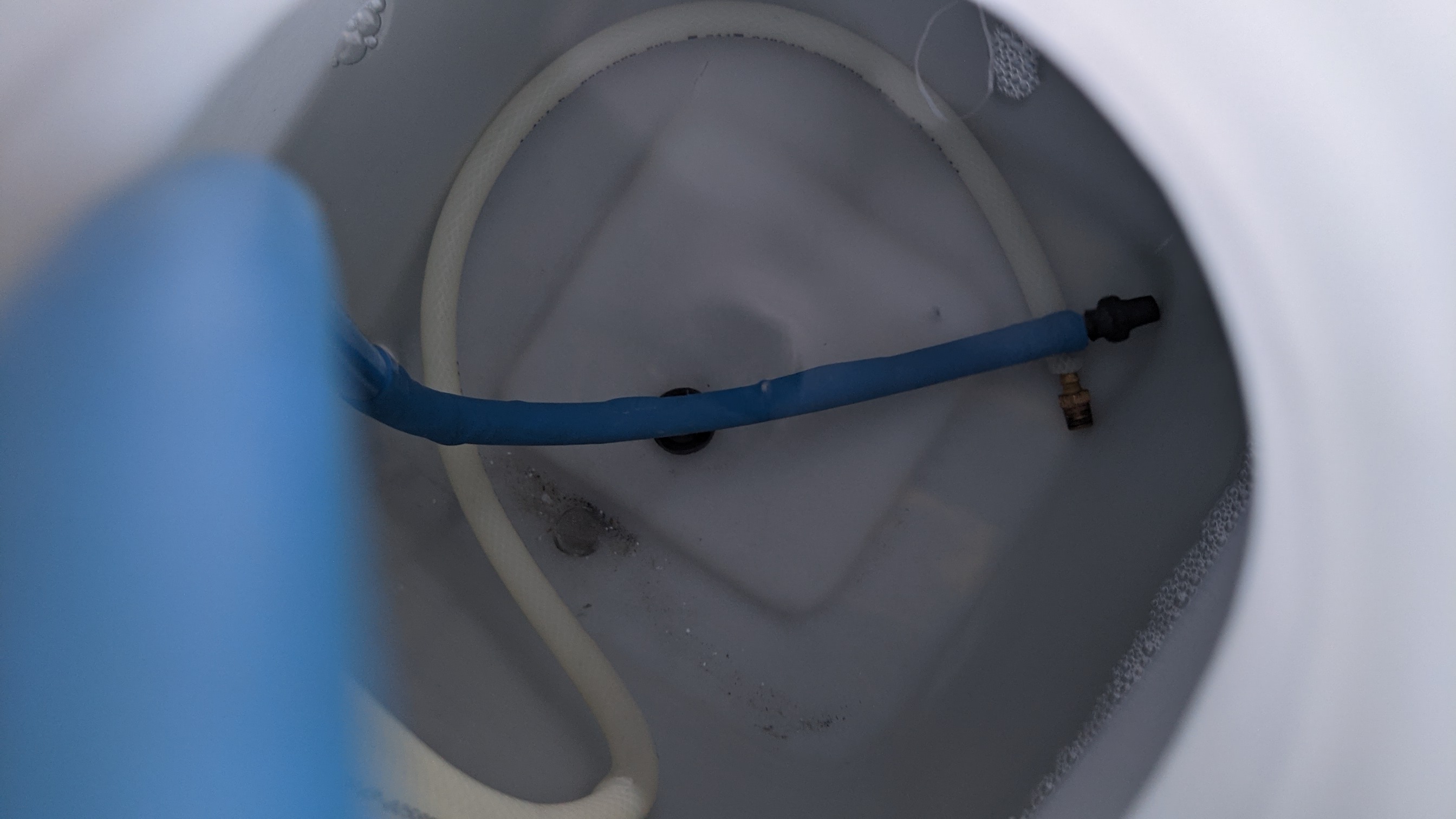

Dissolves bad
I agree. Wondered why my chem injection stopped working. Screen filter was clogged with the stuff. I even mixed it on the light side.
Seems to get hard once you open the jug
1/3 of a tub left. Have to scrape with the scoop a lot to loosen it up.
use a cordless drill with paint mixer in hot water
Shouldn't need to do that. It should be soluble.
Back to liquid acid rinse or dry slurry depending on need. Maybe it is just me, but I had the same issues with Ice.

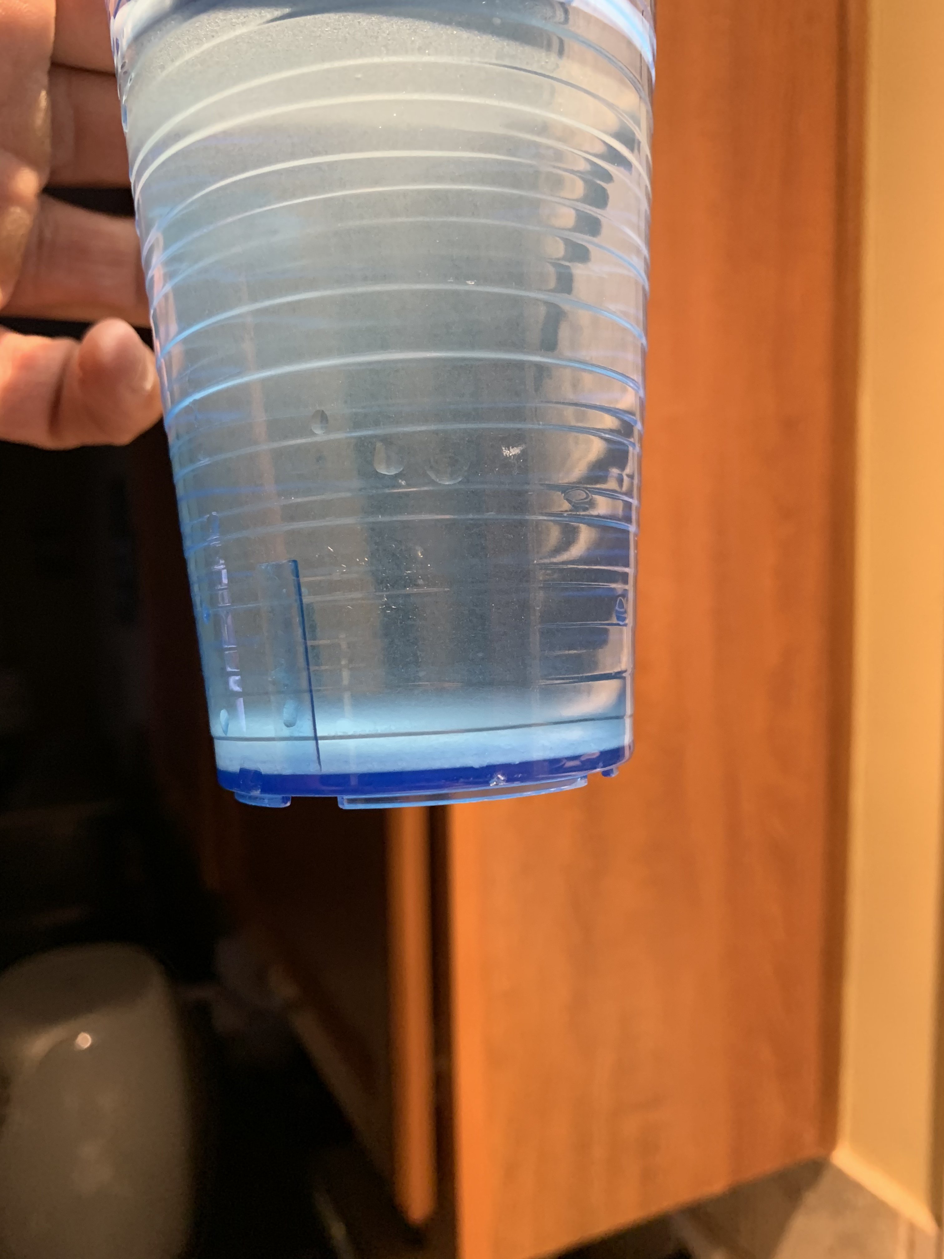

I mixed a teaspoon in a glass of hot water and let it sit for a few minutes.
Easy to see the powder at the bottom of the glass.

So, I’m supposed to go from pouring 32 oz in my 5 gallon jug and working, to stirring this in hot water before pouring it in my 5 gallon jug?

You are more than just a little stupid. Do you stir your coffee when you put sugar in it?

lemmie help you with mixing powders
do you have short piece of solution line?
If not, get one.
(or use your sol line)
When mixing powders, use hot water from the TM, while using the hose to stir while filling
fill your jug while bleeding off hot water at shut down.
