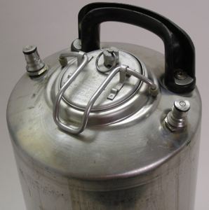

does anyone have a picture of the pepsi sprayer I would appreciate it

Chads;
Here is the top of the "pepsi type" sprayer:
It is about 2.5 feet tall. QC's go to the 18" wand and pressurizing hose.
Center Lid come out for filling.
Larry Cobb
