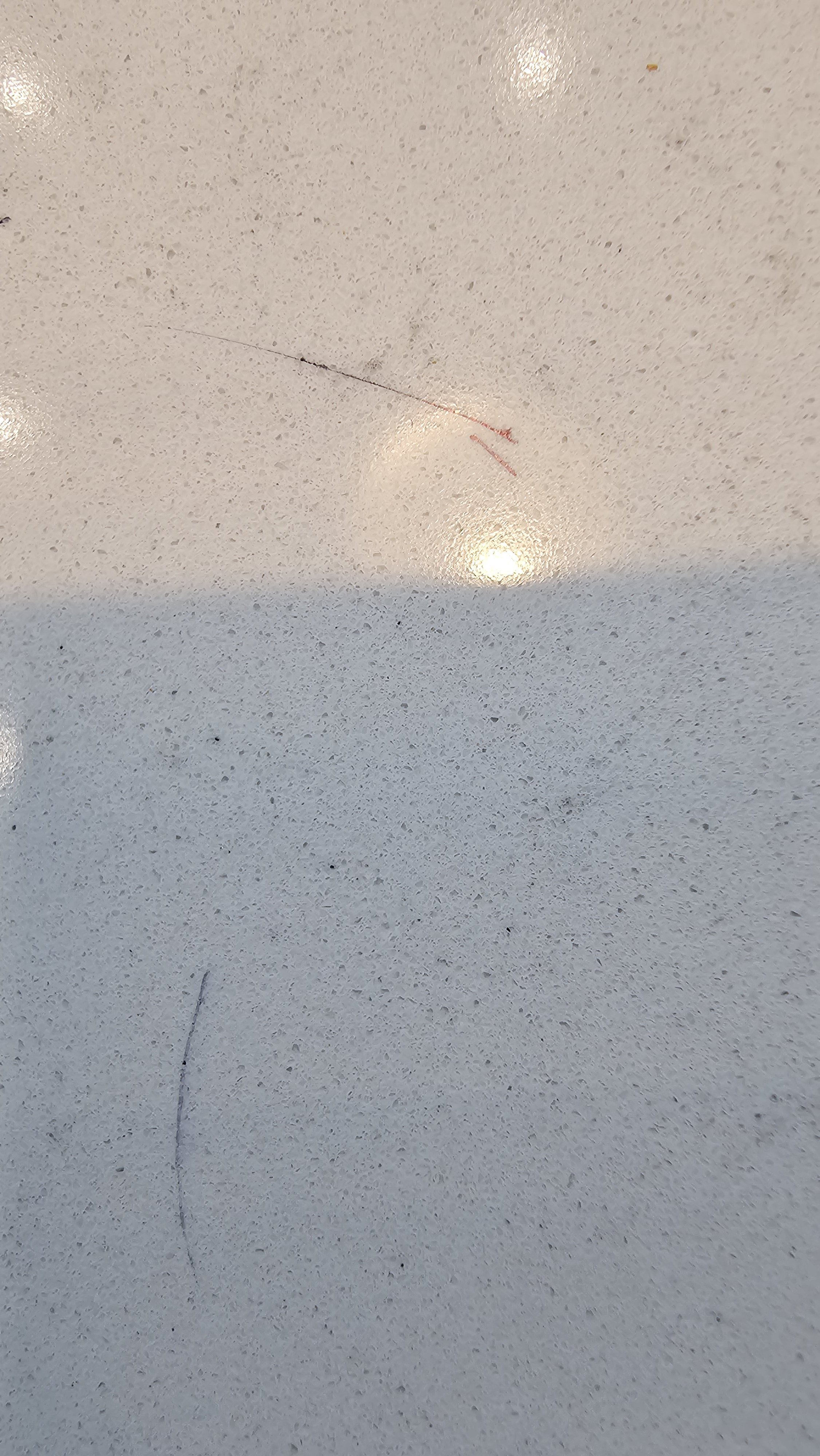

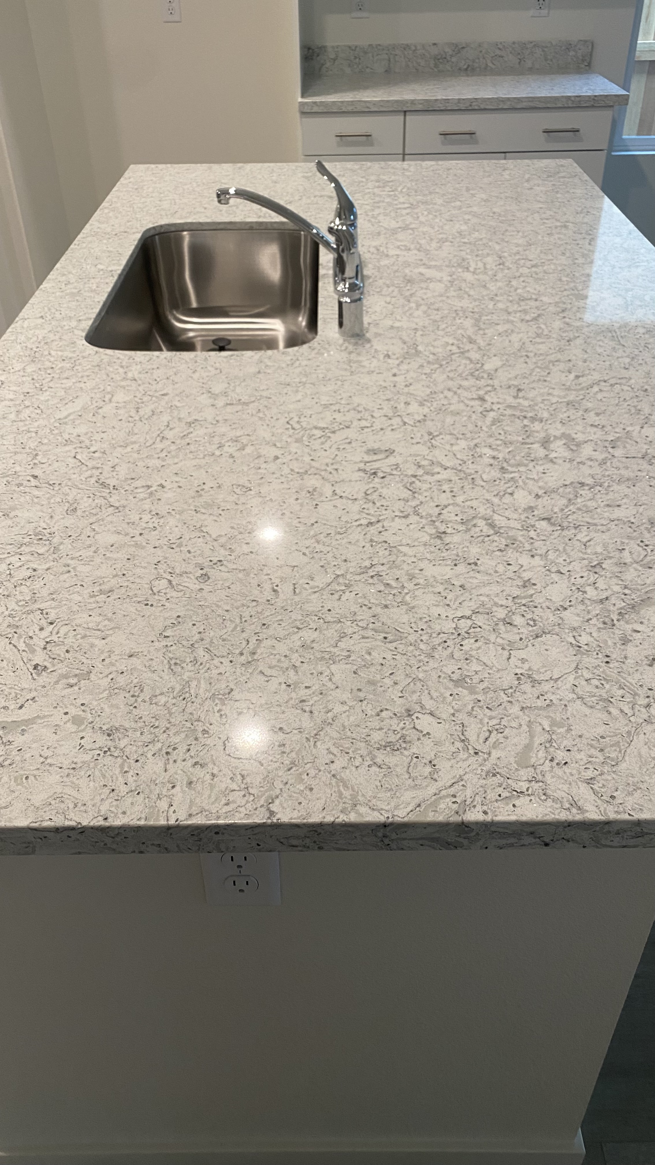

I have been asked to look at cleaning this quartz contertop. It is in a vacation home and the previous guest got ballpoint pen on it in several spots.
My instinct is telling me that I'm going to need something more than neutral cleaner to get the ink out. How aggressive can I get with quartz? Will it dull from high alkalinity and etch from acid?

Quartz is just an acrylic polymer with quartzite particles mixed in. acids and alkalines aren't an issue, but heat and some solvents can be, and polishing to remove scratches can be difficult because the plastic is so much softer than the quartzite bits.
