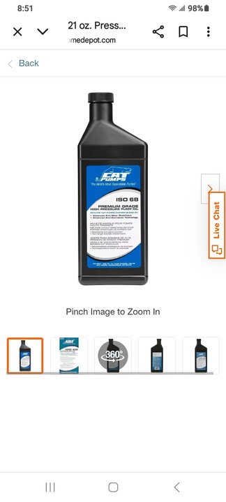

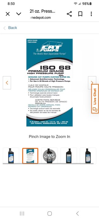

I would use pump oil. Transmission oit takes heat and punishment and lasts 25k+ but would you put that in your engine? I don't know if one brand of pump oil is different than any other but i know there different than motor oil. I run Hypro pumps they say use Hypro pump oil. I use Cat pump oil instead because I can get it at home depot. I also run Cat oil in my Comet wastepump Unless the pump specifically says use automotive oil( i believe Hydracell recommends 30w non detergent) i would steer clear. If your car says use 0-20w and you want to get the most outa it i wouldn't put 15-40w in instead. And if you want the most outa your pump i would put in oil specifically designed for pumps.

Any oil will work...... for a while. pump oil is just w30 not detergent for the most part.
View attachment 132728 View attachment 132729
