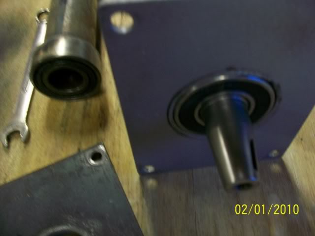

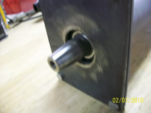

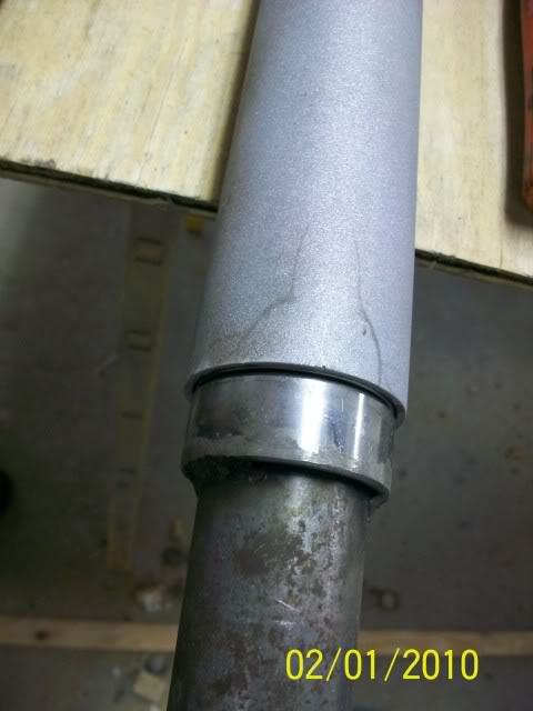

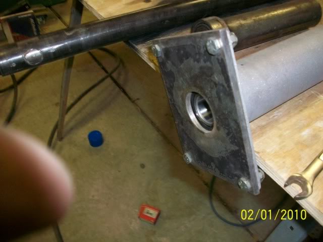

It's the PTO. We have the same problem on our units. Could be a sign that the bearings are going.
44,263
La La Land
replacing driveshaft bearings

With my Cleanco it's not a bearing issue as it has made the noise from brand new. It resonates from the shaft.

I just replaced the shaft and bearings in one of my units last week. When it's new we get very little of the vibration/growl.
