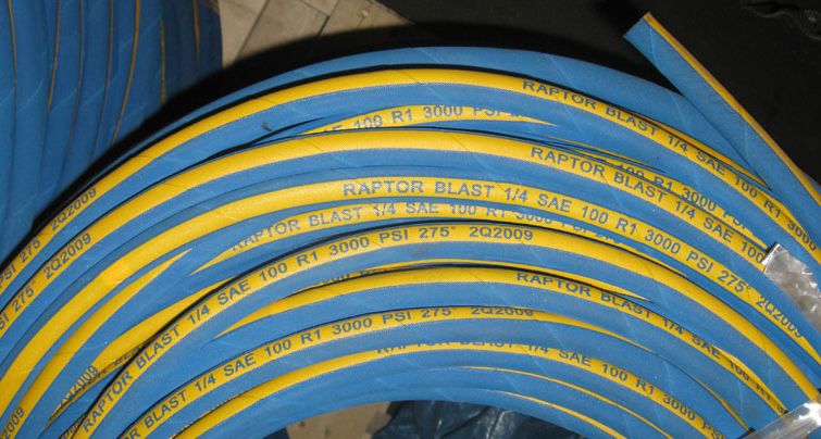

Just a note to our TM hose customers...
that the Raptorblast 275° F hi-temp hose has finally arrived.
Thanks for your patience,
Larry
