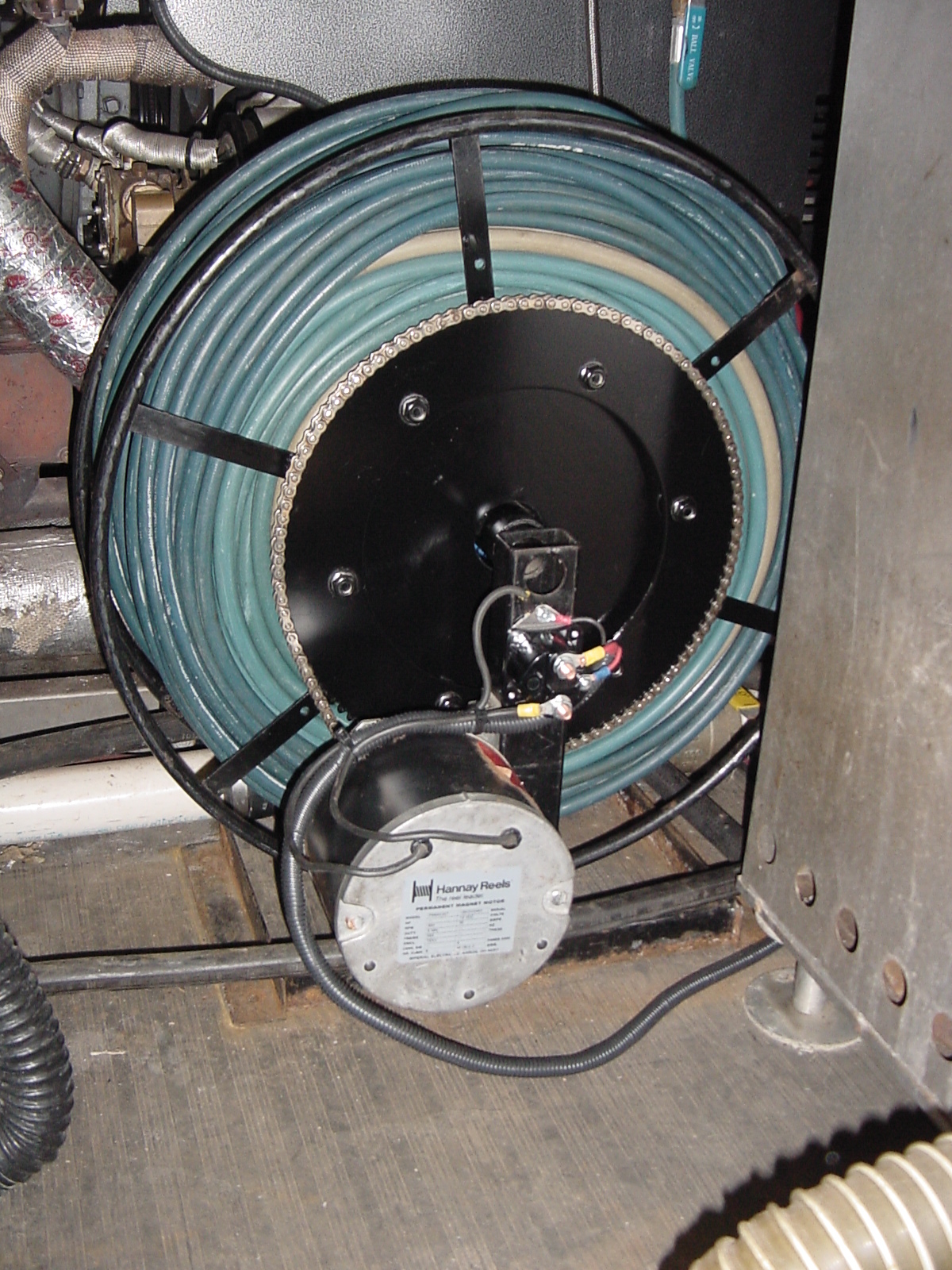

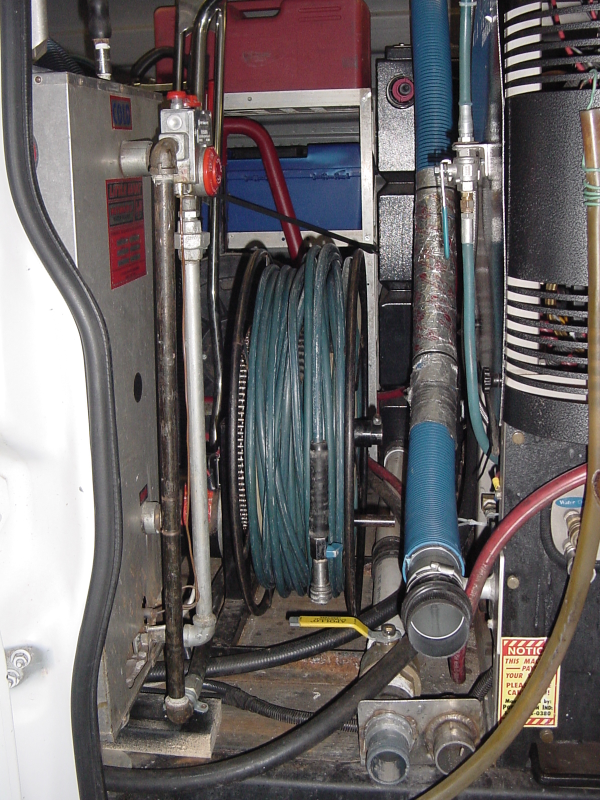

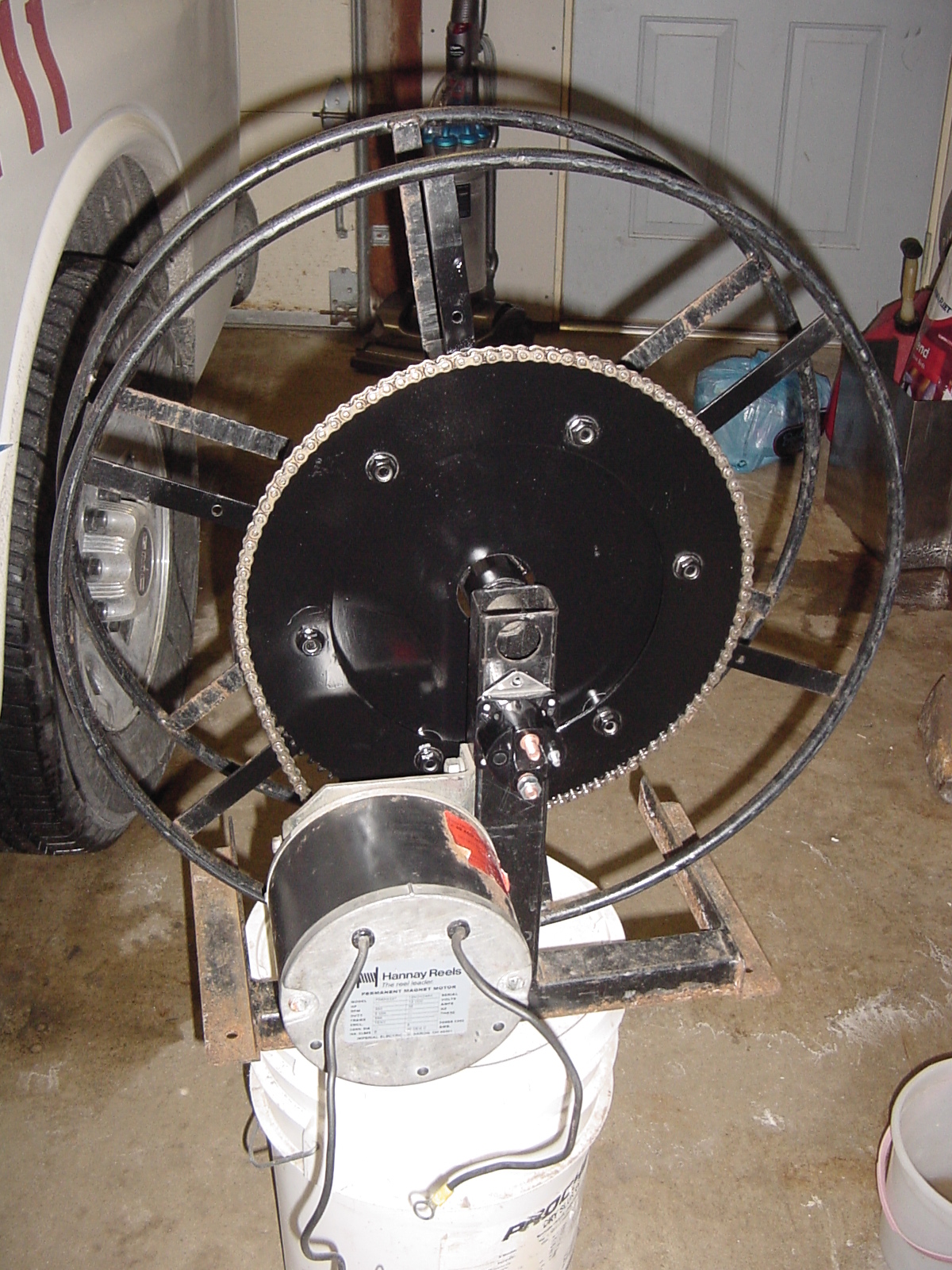

I didn't have room for the width of a Cox or Hanny so I made my own.
Cut the handle off a standard solution hose reel.

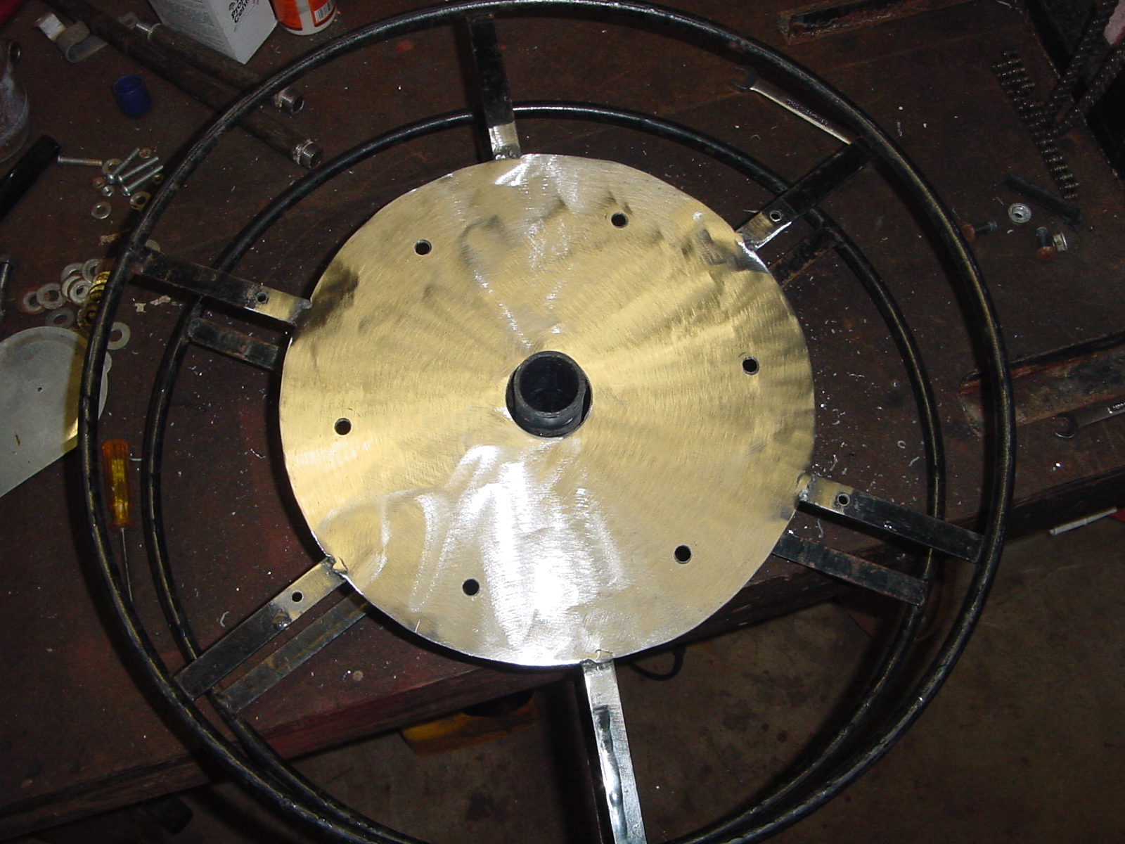

Made a proper size metal disc and welded to the reel spokes.
Bought a relay/solenoid and chain from local farm store.
Took the sprocket, motor with mounting bracket off a used Hanny reel and assembled them on my reel.
Motorized Hose Reel 002.jpg Motorized Hose Reel 003.jpg Motorized Hose Reel 004.jpg

Winding the solution hose up by hand never was an issue for me. With the set up I have there just wasn't room for the handle and my hand to do it manually. I always carry the solution hose end back to the truck, not a problem with it getting intertwined in the vac hose.
