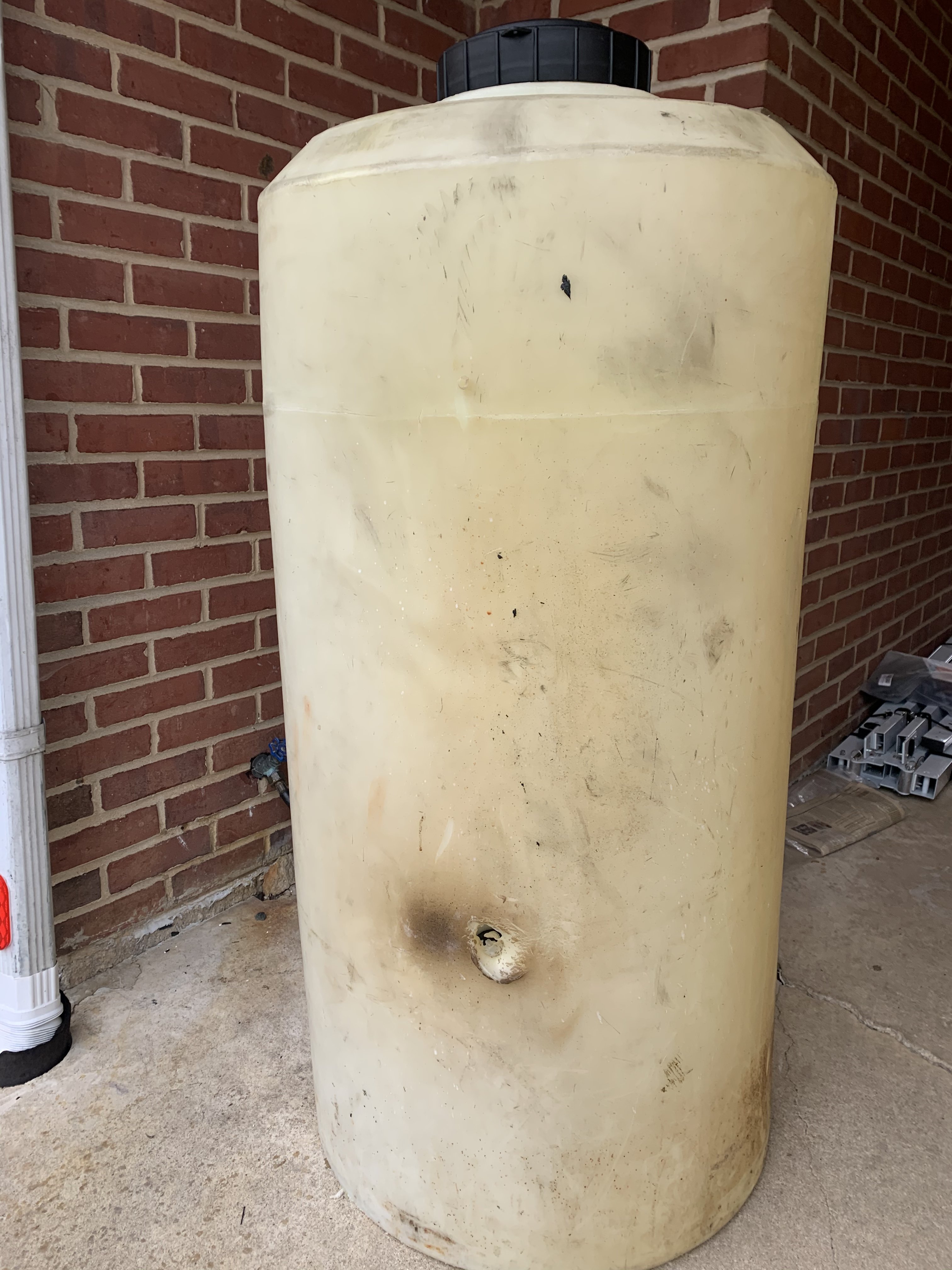

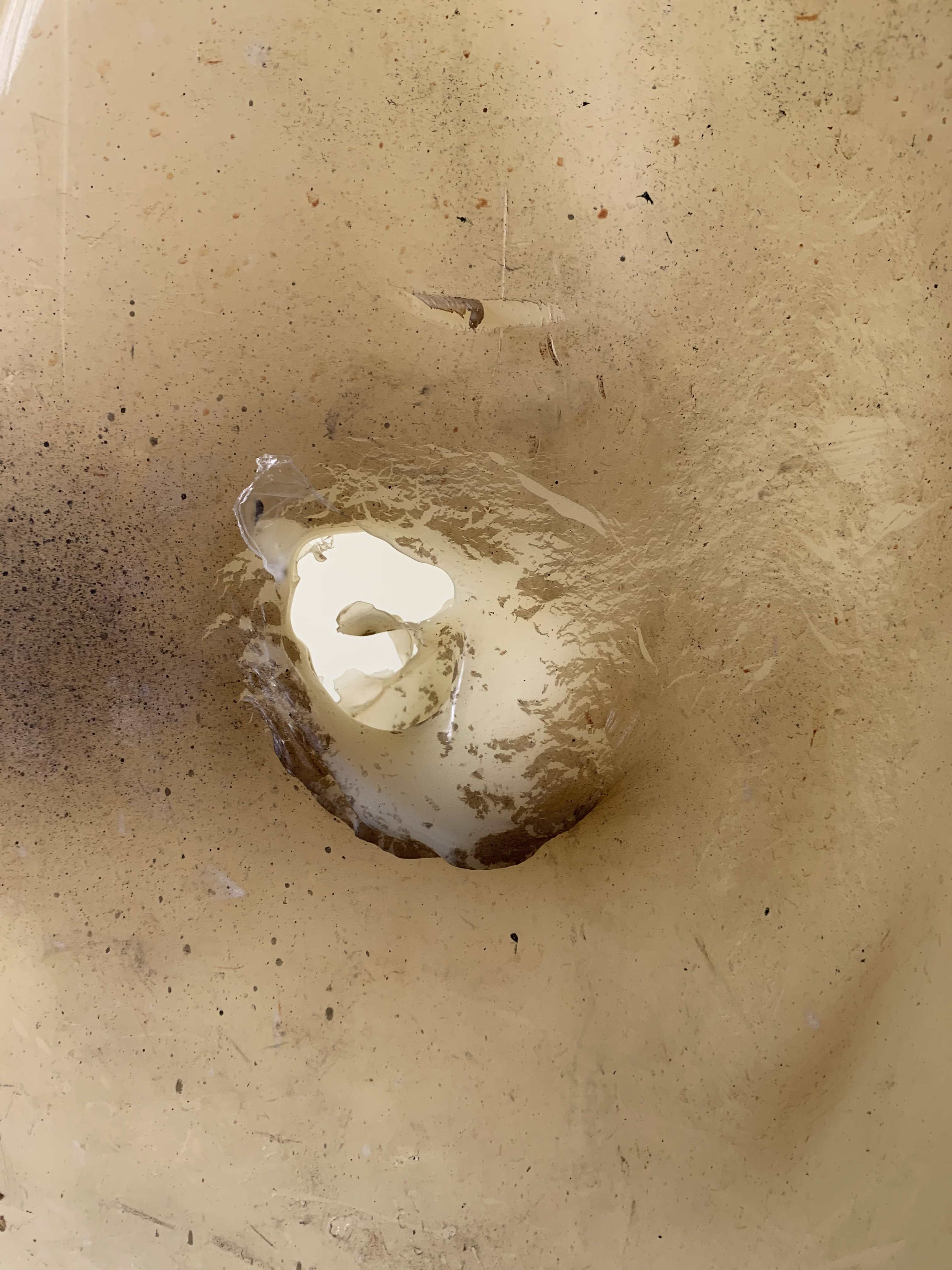

anyone ever attempted to repair a burn hole on the poly tank?
I could drill a hole into it and install a pvc bulk head fitting then screw a cap on and be done with it. The only problem is my arms are about 12” too short from the lid downward to insert the inner bulk head to screw onto the the second part. Any ideas on how to hold and insert the bulk head from inside the tank being 12” shy to hold it with my hands?
Does JiMmy have gorilla long arms or does he just look that way?
The burn hole is about 12”” up from the ground.
6742075B-3601-43C2-984F-4B6CBC676EFF.jpeg 2C1DE8EF-F10B-464B-9582-C889DC8EED9D.jpeg

If the tank is thick enough you could try to screw at patch on from the outside. Some stainless sheet metal screws would likely hold. Use a rubber gasket between the tank and patch.

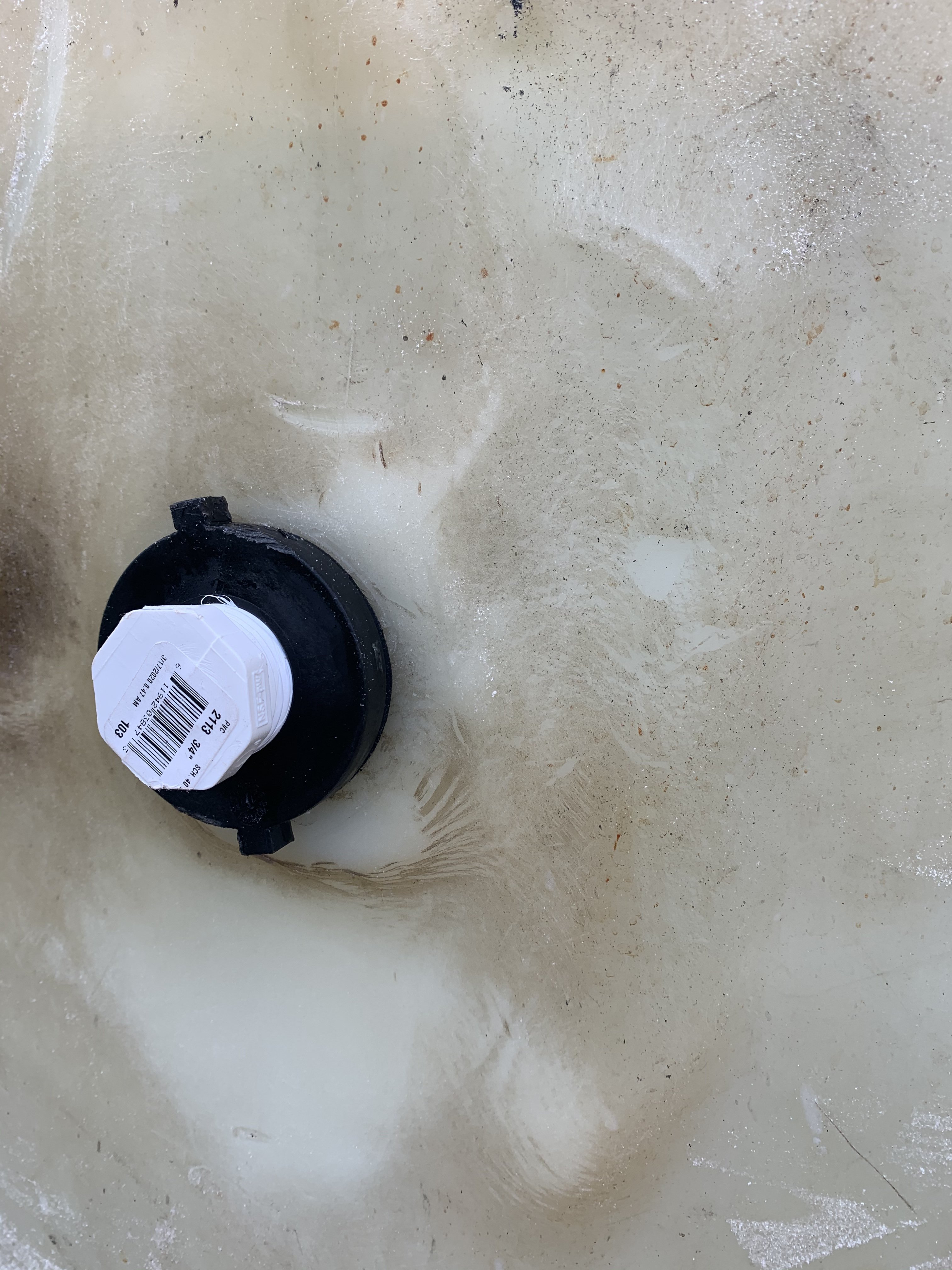

got her done...sanded smooth the melted area...smoothed out the hole...so happened to be a 3/4 hole...installed a bulkhead fitting with a cap...tighten her up, DONE. Filled the tank...no leaks.
Ordered heat shield that Carl suggested....will be fitting it on tomorrow.
$3.49 fitting + $37 heat shield vs new tank....$41 fix won.
thanks for all the suggestions. much appreciated.
