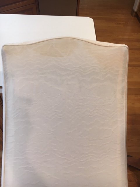

Recently cleaned 6 dining room chairs. Tag said "polyester fiber".

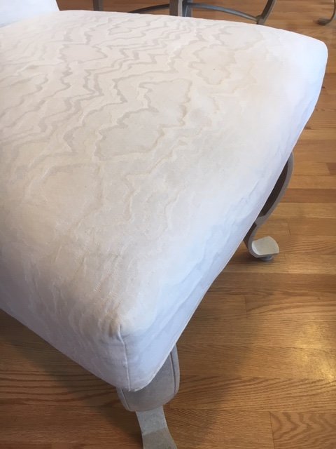

The homeowner mentioned a prior cleaner had to come back to remove some yellowing. I used Prochem upholstery prespray and flushed with the Saphire tool. Sure enough the day after the cleaning she calls to let me know some yellowing appeared. Went back and found yellowing on several chairs, it was around piping and edges. All of the yellowing came out except for this on the back of one chair.
This was the worst of the yellowing and it didn't come out with regular upholstery prespray. The yellowing seems set in the fabric. I think this is a jacquard? Any thoughts on how to remove the yellowing if possible?

It seems that the yellowing is in areas that more difficult to extract thoroughly. I would treat with browning treatment, flush with an acid rinse, thoroughly extract and towel dry. Sometimes a final light spray of browning treatment works wonders.

The tag deceived you.
Most of the time, those tags give you the product that is used as filler material underneath the fabric you’ve cleaned.
Ron’s suggestion as mentioned above should fix that for you.

I wouldn'the have chosen the Sapphire handpiece. The PMF internal jet would be my weapon of choice, considering the piping on those chairs.

Yes, most do.
Too strong of a mix, repeated applications, or if the product is mixed in very hot water can damage dyes, or in this case, leave it "whiter".
Be patient, and remember that "more isn't better".

Spritz some O2 scampoo and towel it off and call it done.
They are on the acid side anyway.
EncapPLUS with oxy-force from NILODOR is a good one.
