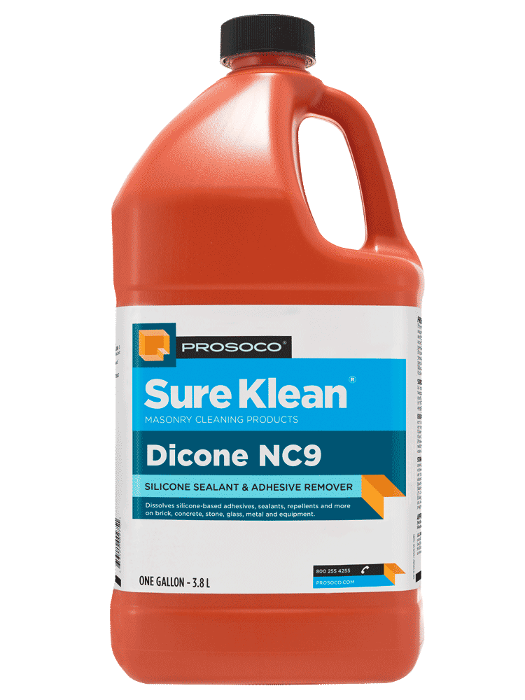

Dicone 9 from Sherwin Williams or other supplier. Expensive as hell. $260/gallon. Maybe you can buy a smaller amount somewhere.
Prosoco is just down the road a bit. Lawrence KS.
Not sure if they sell it this cheap but its listed they do.
