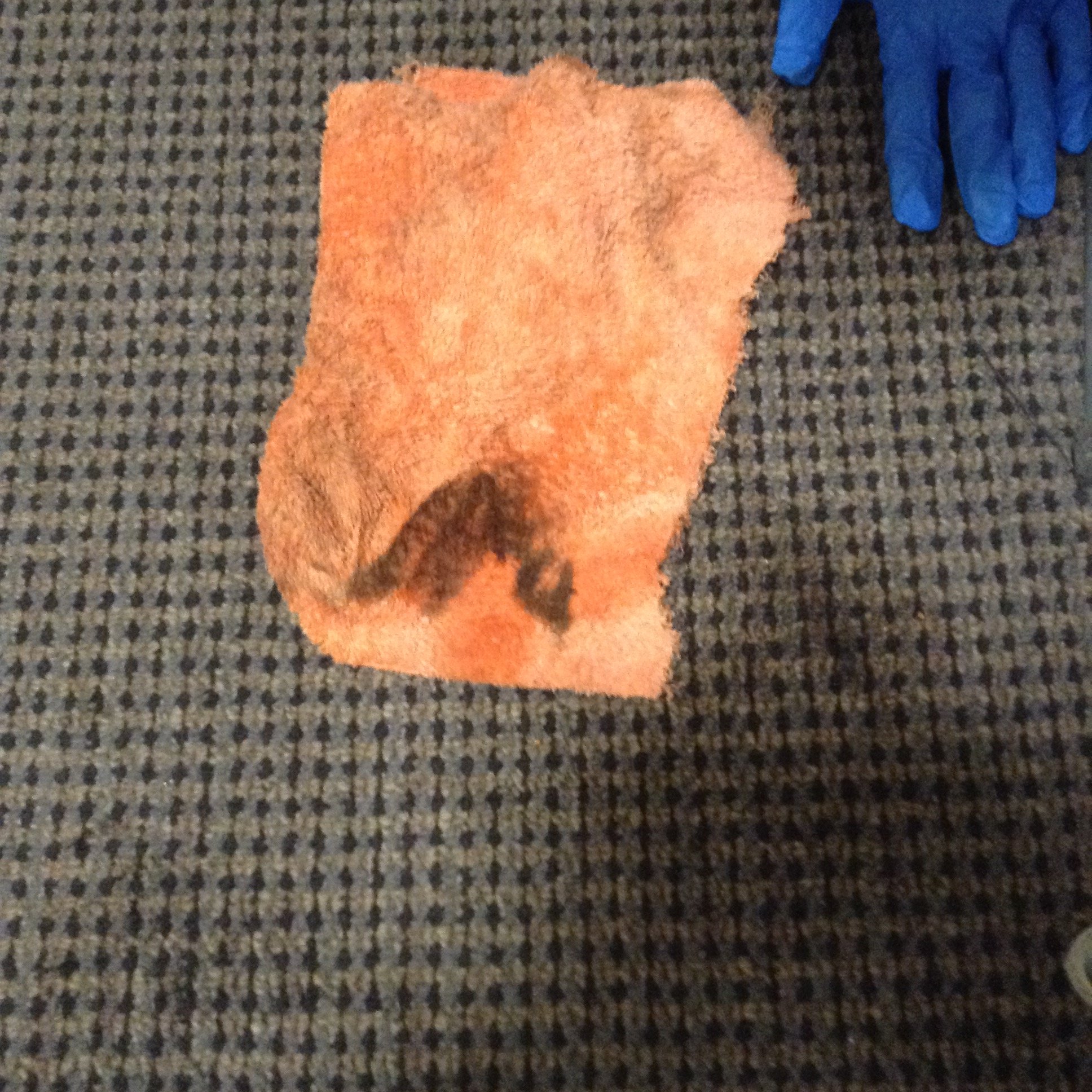

I have a residential building and the top floor all commercial carpet, the roofers tracked roof cement on a ten foot by four foot area! Is there anything to get this out speedy. I'm using a few solvents with a rag but it's taking forever and not completely removing it to an acceptable point.

I had this exact problem. This is where I found out how good Prochem Pro spotter is. It will get that out like a hot knife through butter.
WD40..
Years ago I was repairing chimney flashing.
got roof mud on my hands .
Tried the d'limo juices I had on the carpet van, tried the nuke degreaser pre-sprays ...nada
Grabbed the WD and WOW...stuff melted off my hands
FO-REEL!!
scotty747
Oct 19, 2006
866
I mix a little of the black prosolve spotter with the yellow. It stays wet longer and seems to work better. Wd-40 works too and keeps the carpet from squeaking.
