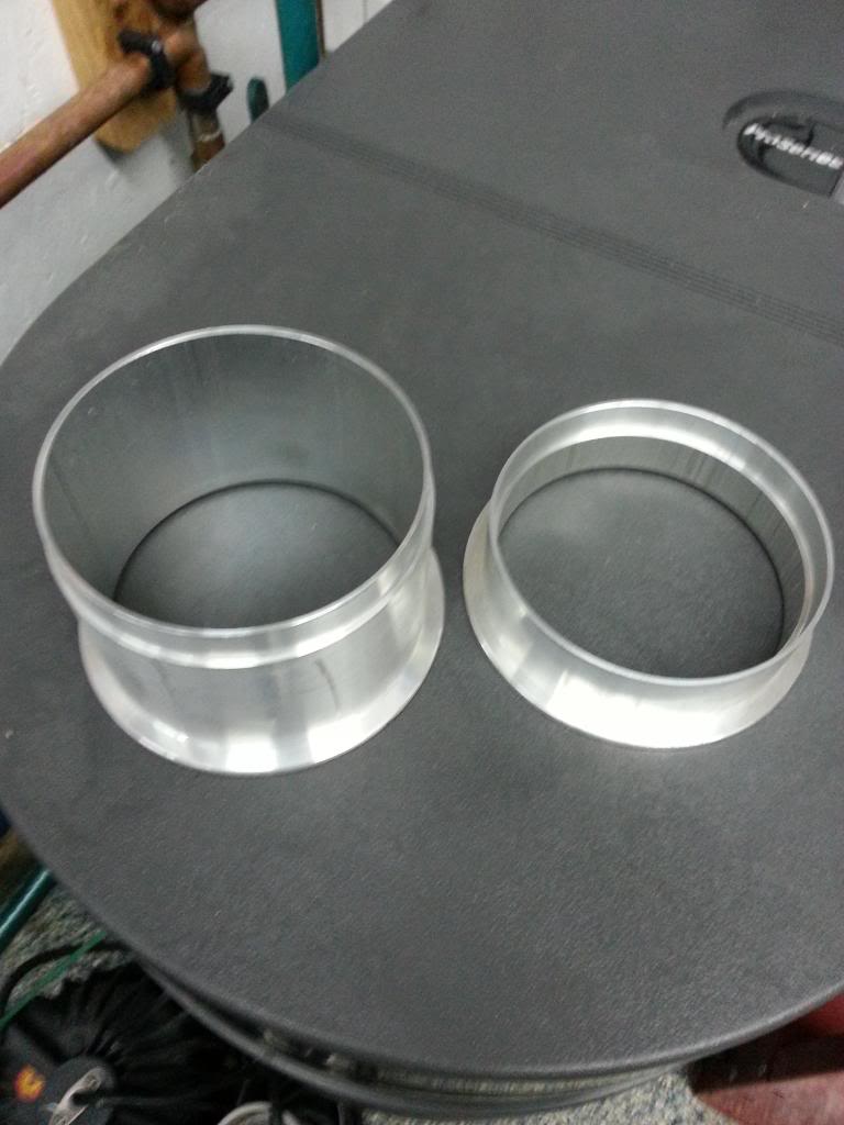

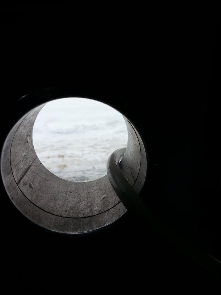

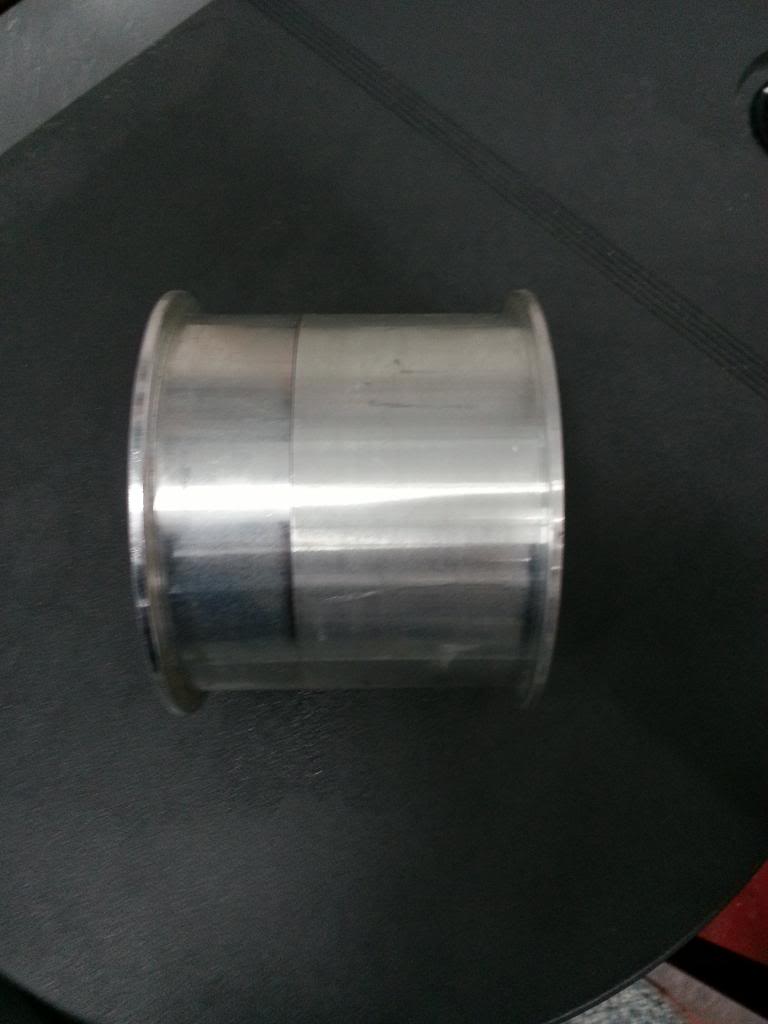

  • Jim, the cds ports are on top of recovery tank, on pro 1200 they are at bottom right side (very close to the end of the sliding door front side. Trying to avoid running from back door.
  • Fred, the side step is a possibility though it will have an extra bend (a little loss of vacuum) and may force me to put the chemical jug somewhere else. Working with a standard size van (a necessity in S.F.) and trying to maximize space, as I have the baaaaaaad habit of carrying a lot of chemicals and equipment with me.

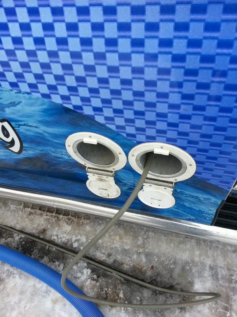

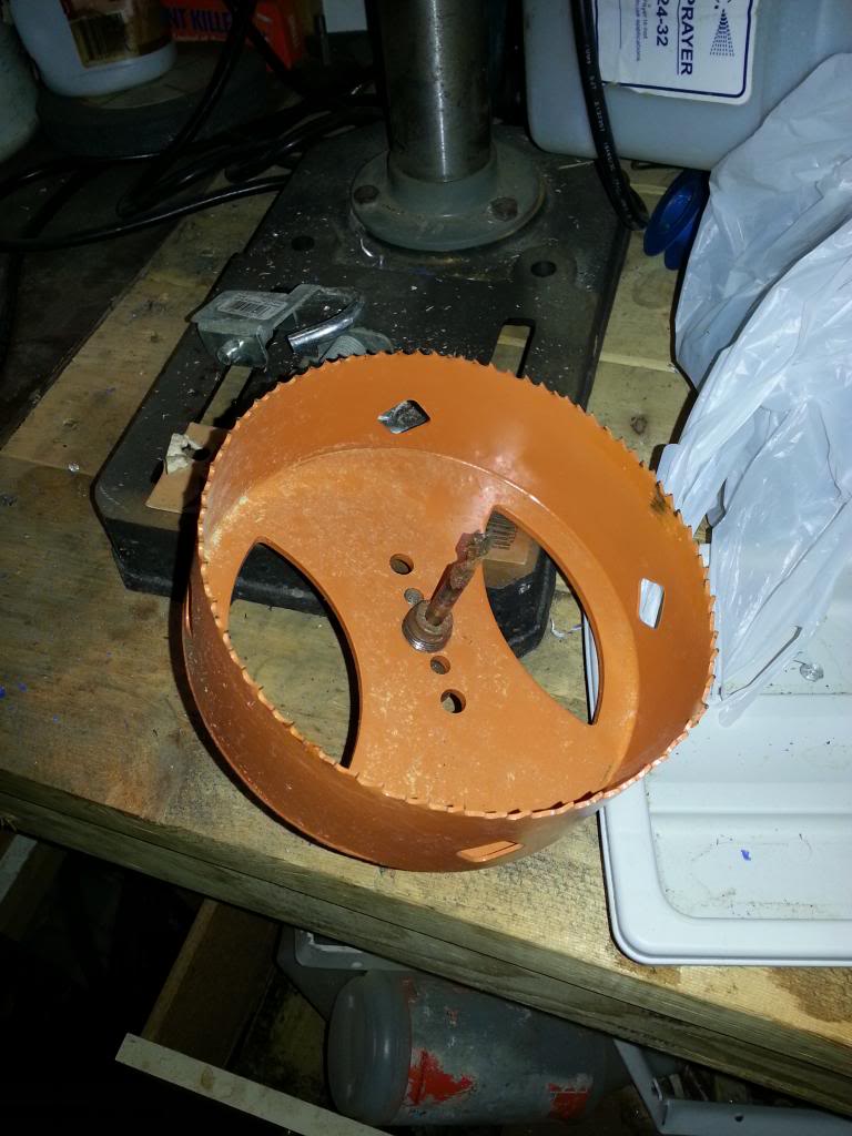

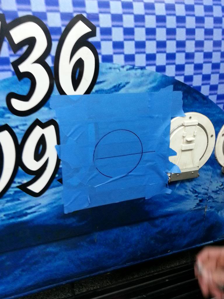

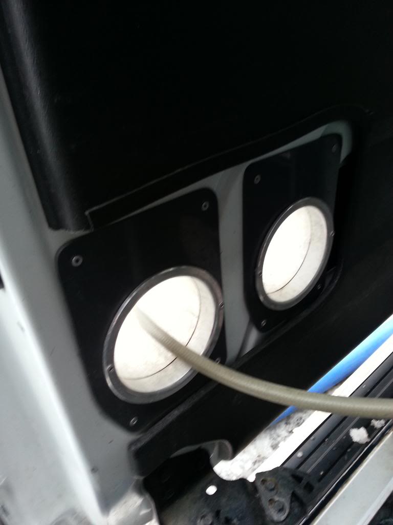

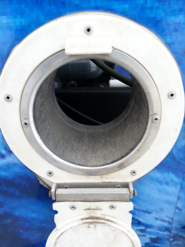

  • Mark, that is very neat and thanks for the pictures. Is opening or closing while hose in create any issue? What's the distance from door to where hookup is?

Mark Saiger
Mr Happy!
Dec 26, 2006
11,200
Mark Saiger
Hopefully you just got a chance to see the videos posted (while you were both posting your threads)
The videos will maybe help with all the ideas mentioned.
Mark

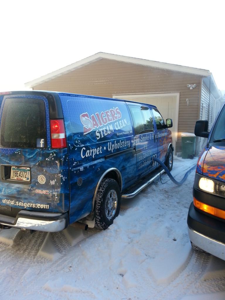

I run out the back of our rig, through the floorboard. Behind drivers rear tire.
Love being able to lock the doors at times!

How do you keep the hose from pulling back out the window?
Sent from my HTC6435LVW using Tapatalk
Since you don't have to worry about freezing why not just mount a manifold outside the vehicle beneath the door. Run the plumbing down through the floor and to the manifold.
That way you don't even have to screw with cutting on the door.
Use a hose hook.
I like the Super Strap that also holds my hoses too when wrapped up.
