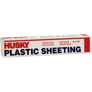

oh and when you see a spot turn orange right away when you apply the Ammonia 40 combo, that's a good thing!
Don't panic, just put the plastic over it and tell Mrs Pift that you enjoy fine bourbon around the holidays.
Every last one of you should have a 12 by 400 roll of this on board..
Home Depot $24.99
Cut small pieces for covering Stain Magic attempts
Use as a leave behind tarp for setting upholstery cushions on
Leave behind under hacked rugs
Placed inside cushions between ink marked foam and fabric
Mask cabinets when cleaning counters
Mask stainless appliances when acid cleaning or stripping floors
Protect banana trees from freezing.

I thought about you yesterday. (I threw up a little in my mouth.)
I had to quote a pretty large oriental rug "cleaning" yesterday. They were all on wood floors. Your plastic came to mind.
I would have recommended a "take em out and clean em" place if we had one around here. I mean REALLY clean them. Not just take em out and steam clean them out back.

I left a long piece a plastic for the vCt guys today!
Told em id kill em if they get that sheet on my cleaned carpet!
