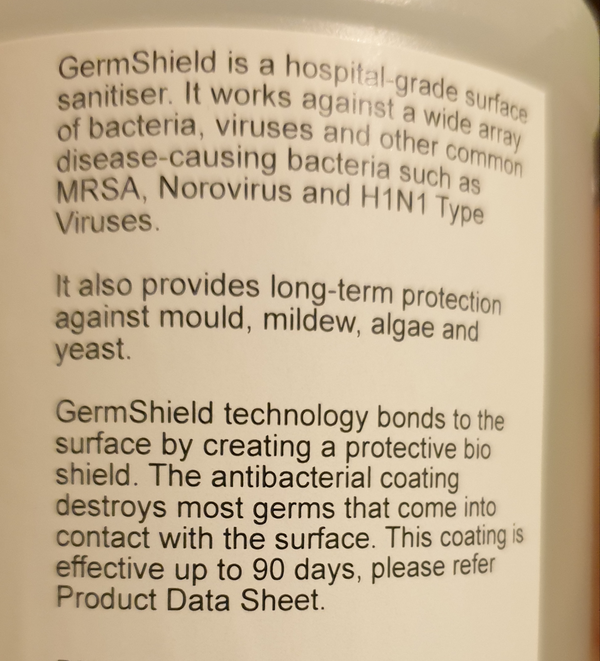

Thirty days is quite ridiculous.
90 days on one I use...
but like Jim said, its the antibacterial side not viral
12,576
Thank you for posting that.
This is what concerns me with the claims I'm seeing.
Its not that I'm saying its not possible to make that claim, just that I haven't been able to find clear documentation that such technology exists beyond bacteriacidal products.
12,576
When people say "But I saw people fogging on TV, it must work!", I remind them that Listerine used to advertise that gargling with that horrid stuff prevented colds.
Then I get blank stares and realize the FTC made them stop saying that in 1971, and most people I know weren't born yet at that time..... :frown:
It provides long term protection against mould, mildew, algae and yeast.
That's it and all it promises.
The label is the law.
Promising more than the label says or using it in any way not specified by the label creates a vulnerability to the law.
Lawyers will be very busy after all this is over.
We say this and only this-
We cleaned the specific area/item and we applied X product according to the label. Documented. The end. We don't make promises...the label does.
I've used that product awhile in commercial bathrooms
when this crap hit the fan, the sales rep rung up all excited wanting to know how much extra product I wanted as it killed viruses for 90 days
I told him he needed to read the label and data sheet for what he sold
