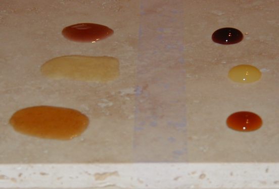

Ultraseal Impregnator does not let water through after spraying.
assuming that you have a clean surface to begin with.
This porous limestone was treated with one coat :
( Grape Juice, Orange Juice & Coffee )
I'm not trying to be a dick, but that is crosscut travertine, which is pretty dense when compared to a sedimentary limestone. Travertine isn't that porous, despite popular belief, and usually won't even stain when polished. Night and day different from commonly used limestones like Jura Gray, Jura Beige, Beaumaniere, Crema Europa, etc. Not to say that the sealer doesn't work, I haven't tried it, but I think you would find a significant difference when sealing travertine vs. some of the limestone listed.

cameron demille
Except that Travertine is also a type of Limestone.
So is marble, so is compact limestone, so is dolomitic limestone, so is dolomitic marble. They all start as limestone, but pure sedimentary limestone is a completely different animal and not comparable in terms of porosity, to its metamorphic relatives. Being a "type of limestone" doesn't really matter here.

Yup travertine
The better question, after you wipe the spills, did it etch ?
The answer will be yes.
The real question is it buys any time before it etches....
