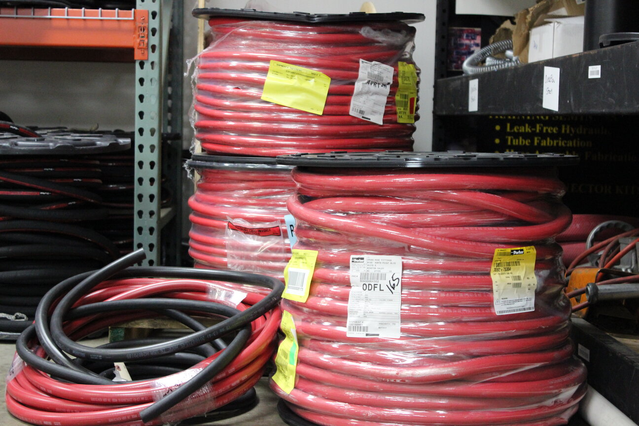

What's everybody doing for replacement TM hoses? Do you just order a 50' section of solution hose and have NAPA cut it into small pieces and put ends on it? How about stainless automotive hose? Where would a man go to get something of this nature?
down the road from you...
