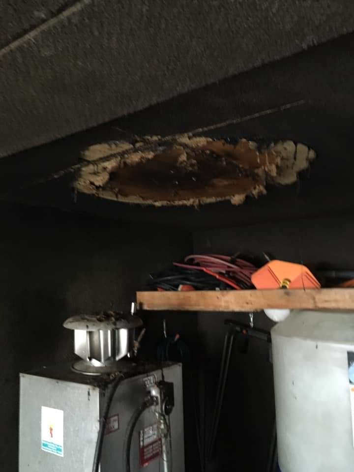

Waldo's POS LG nearly killed him yesterday.
Sure it Waldo but he's smarter than the average carpet cleaning idiot
I had a close call with mine when the igniter went bad back in 2000
Over confidence and lack of respect for the danger are the usual culprits
Id like to know if the guys that run them actually informed their auto insurance companies or if there are local transport regulations that allow these to even be onboard

Little giants are as safe as the owner operating them. I have had and still have lg's for over 30 years. The only problem I have ever had was my fault for not repairing it properly. The burner was loose due to a broken mount and caused the main gas line to come loose. Caused a small fire that I luckily discovered before it did major damage. Taught me a good lesson. I usually light mine with a long bbq lighter and have several in the van in case one fails. I do regular leak checks with a bottle of soapy water. The proper way to use them is to have everything turned off in between jobs. The propane tank should be turned off, the heater should be turned off. It's not hard to light it for every job and turn it off again. A lot of problems are caused by carpet cleaners being too lazy to turn everything off as they drive from job to job. The issue that Bob mentions is caused by faulty controls. You know the control is going when you start getting too much heat. I had one that was going up to 280 degrees f. Way too hot and dangerous but addictive at the same time. The modern heaters are usually set not to exceed 230 degrees f. The larger the heater, the greater volume of water you can get at the same temperature. Even if you have the propane tank mounted outside the vehicle, you need to keep your doors open. The heater always needs the right air mixture to operate properly and leaks can happen anywhere in the gas system. If you're lazy or just an idiot, don't buy one.

in the pic it looks like that LG is deep in the van up against the side with a wooden shelf right above it. doesnt seem too smart to me but its hard to tell from the pic.
They should be near the door with plenty of breathing room. I think they are just as safe as any propane stoves or heaters in any RV but just like an RV cant be a dumbass about it.
cant have trash and cardboard boxes all over a rat nest van.
that being said I had an accident with one about 8 years ago but it was my own fault... we were still using bbq tanks and I tried to put an inline fuel gauge on the tank. big mistake lol
I still use BBQ tanks. When I know the fuel is low, I carry a spare. When working the spare sits outside the van until needed. I know my systems and am comfortable with them but really should be using a belly tank with the regulator outside the van. I would not let an employee use my system.
