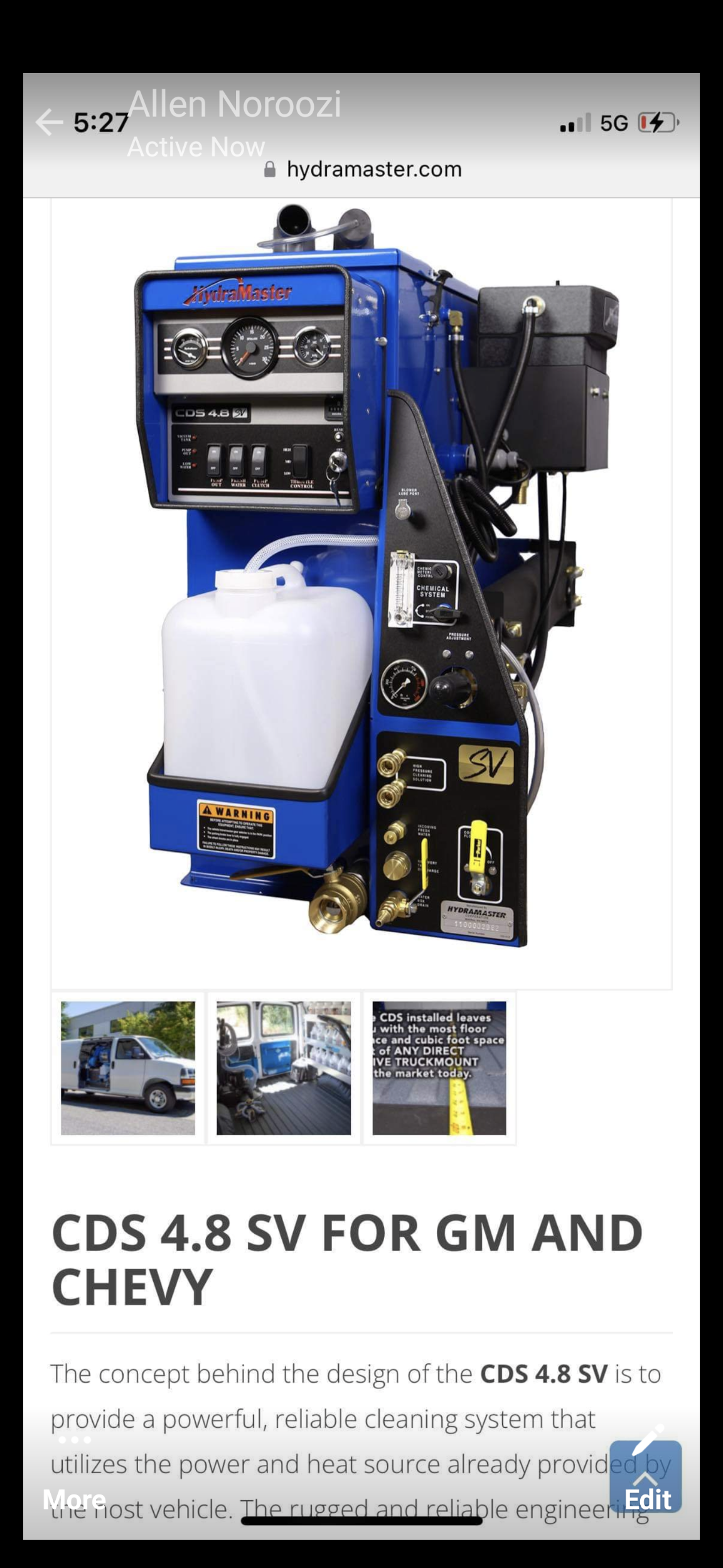

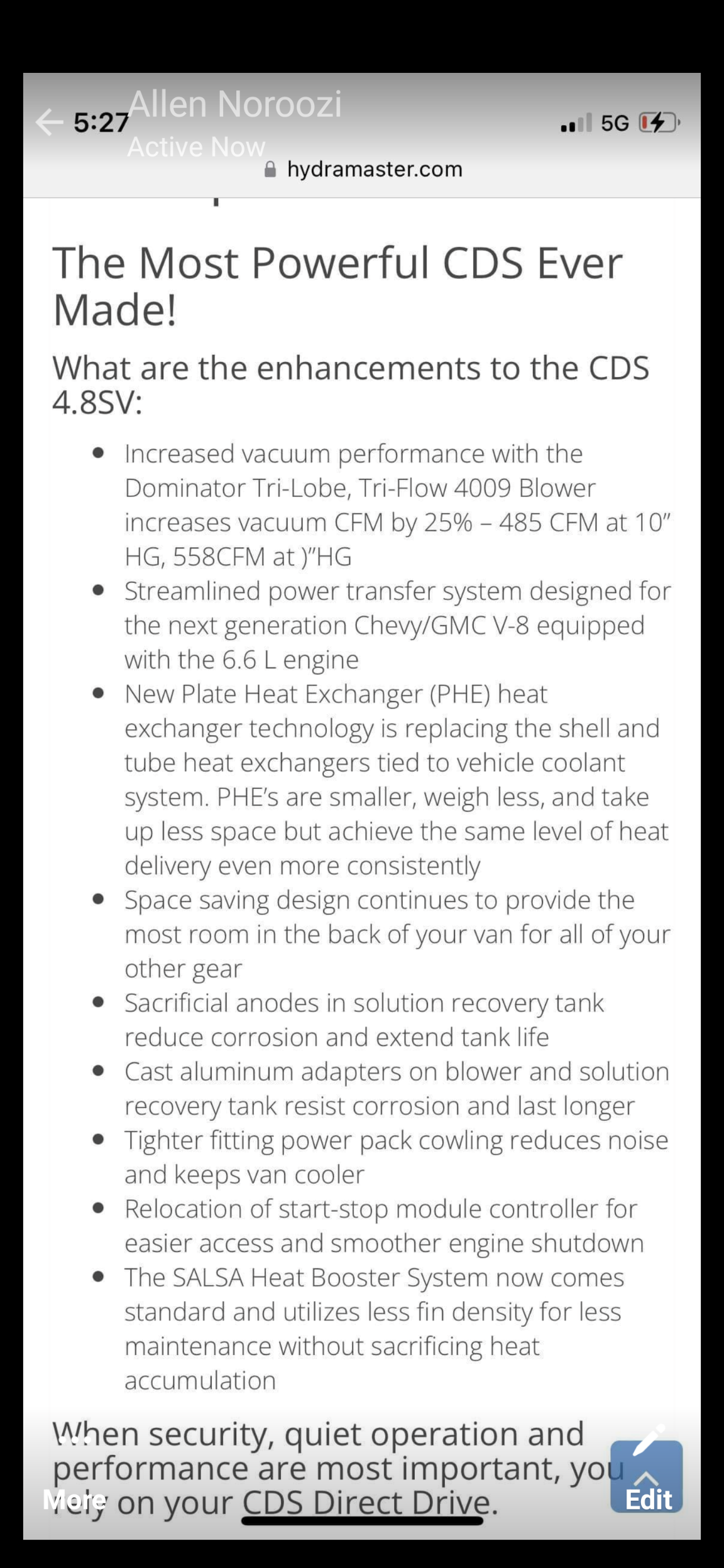

Since when was there a 4.9 blower?
115,966
There are (or were) MD 4009 blowers but they aren't trilobe.
and it shows a 408 in the manual (Rev. Dec 2021)
but the sell sheet shows a blower similar to the MD with trilobes and says "exclusive design" (not the Triflow 408)

The Titan 625 has the new 4009 blower also. I think it's a Gardner Denver 4009 Tri-Flow
Massive 38HP Industrial EFI Air-Cooled Engine – EFI Fuel Delivery, EPA approved delivers maximum power and cost efficient performance
Dominator Tri-Lobe, Tri-Flow 4009 Blower produces 500+ CFM of airflow for faster drying, longer hose runs
