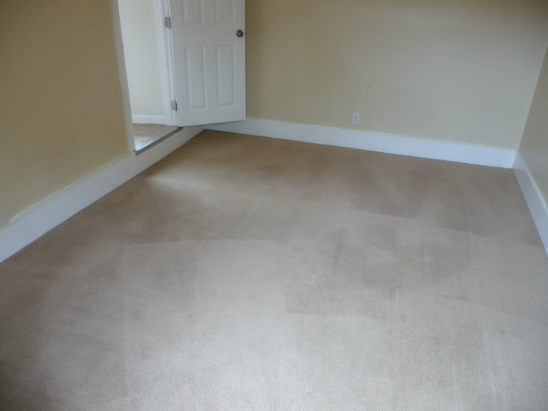

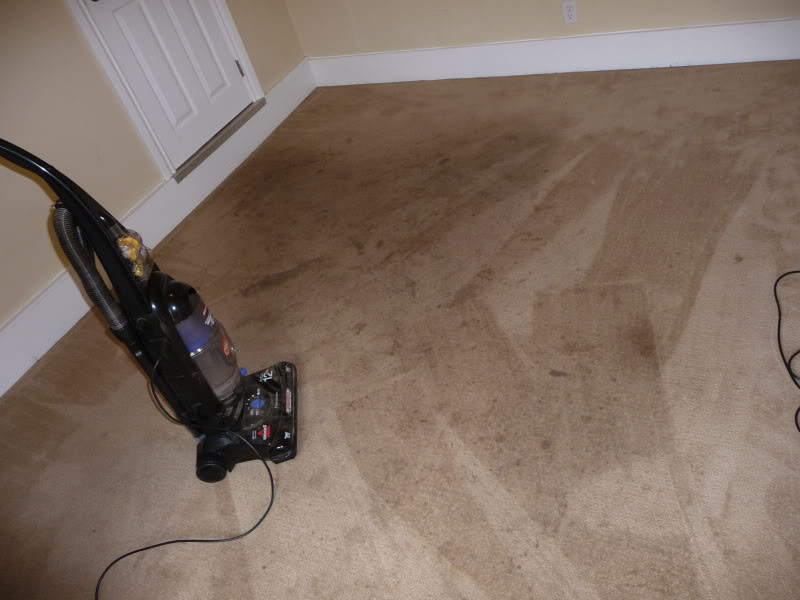

The surf nazis were forcefully removed and look what they left behind..
I filled it 1.5 times more after that..
This was out of one 10 by 15 room that the slumlords had already vacuumed over 3 times 3 full cups with their new Bissell.
Grease Master was pretty worthless on this one. I had to use a 50/50 combo of Zep Engine Degreaser and 40 volume to get it looking this good.

I wish alot of the younger carpet cleaners would realize what engine degreaser and 40 vol can do in shit holes like that.
But alas many buy into the old BP classes where they teach them to use a nuetral prespray and an acid rinse for everything.

I use to use Betco Liquid Chisel(10oz) + Betco TLC(6 oz) + 40 vol(1oz) in a HF on shitholes. If I didn't have any 40 vol at the time I'd settle for sodium percarb. Good stuff but it was also a good thing we opened the windows in every unit we did too, it'd take your breath away.
