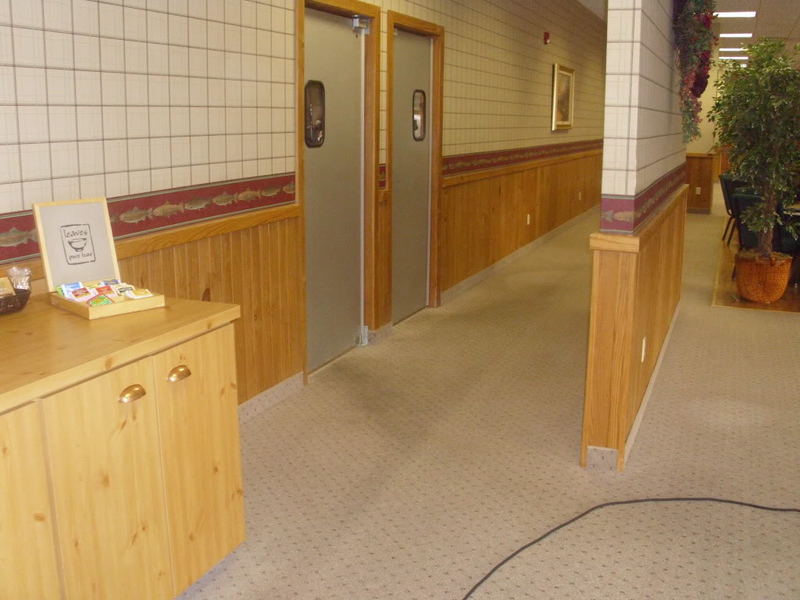

well it seems Danny doesnt read ALL of it 1st....
I do EXTRACT/FLUSH every 12-18 mths
i clean it (or try to if they say ok) every 3-4.....encap it always looked good....hence is why they always try to extend cleaning, even though i tell them over and over thats not the best option
I need to vac after it has been extracted??? ummm isnt that the point of extraction?? :shock: :shock:
2-4oz i fill a 5 gallon bucket roughly 3" from the top and pour in 10-12 ish oz....so its in the 2-4 range, i adjusted it a bit more each time just a little to notice the change..
like i said i have done it before, and it looked great...only different variable is chem...
and yes its loaded.....and no i dont have 30 pads to go about doing a post pad on everything

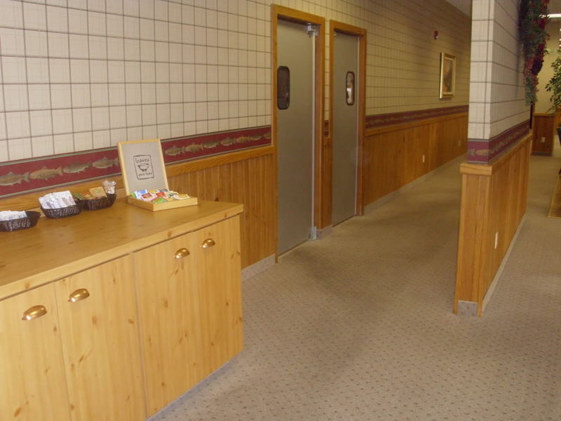

no its blotchy all over the place :( i have to go back re-vac things (yes that fixes a few things...big spill looking areas is what vaccing fixes) and redo a bunch of areas...
problem is,
1-2oz is what was said to be as a comparable...No?? is that what you have heard?
2-the 4 oz rating on encap takes out 99% of things...traffic, spills, spots etc...
yes i know it may sound as whinning...but grrrrrr i like to try new things, to see if it works better A....to see if its a better value B.....but if it doesnt do the job, and then i gotta fix it, then what??

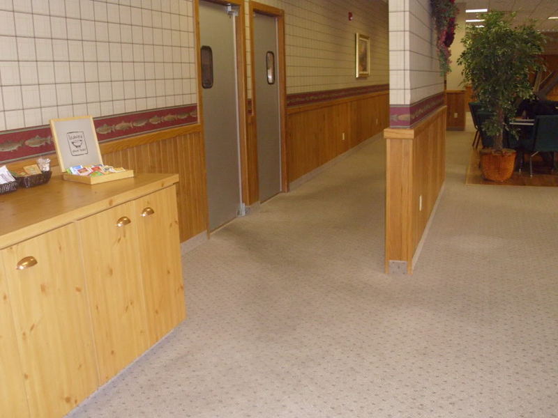

It sure looks like wicking...are you 100% sure it dried in a few hours? Any chance (because the Snake Oil doesn't have the same foam as Releasit DS that you were previously using) you were leaning heavy on the trigger?
Snake Oil has a 400sq. ft. per gallon RTU coverage, if say you were averaging 250-300 per, I would say cut back the juice and dry pass each wet pass and stay on that rotation.
From the "wet, during pics" it appears the snake oil cut a path just like other encaps if not better, like you said, it did "look" pretty good a that time, it was just during final drying it looked splotchy.
What were the HVAC conditions, ever had any drying issues or ventilation issues before?
Also, I don't think you needed more than 2 oz. per, and in fact If you made a "dry pass" to even out the shampoo I'm willing to guess you could have got the same visual results with 1.5 oz. per gal. So I don't think the chemistry is failing here.
We've had 20 guys chase a regular releasit job with Snake Oil and have 0 issues. So I am trying to get to the bottom of your issue, cause obviously that was very embarrassing, and for that I apologize.
I can tell you what I would have been doing that Same night you noticed it. Running a synthetic bonnet like a Tuway and the sprayer of your choice and some 2oz. gal/snake oil and blending the area and adding some polymer in the process, keep in mind it would be a Blend and fix not a wet shampoo.

had the hvac to fan on...
ran it the same way i do the releasit...wet on, dry pass back
it was having a slight issues "cutting" the wick back lines....hence is why i went a little higher..
an OP with a sprayer would be great to go back to touch up now...just enough to wet the tips...then run a beige pad over it...
