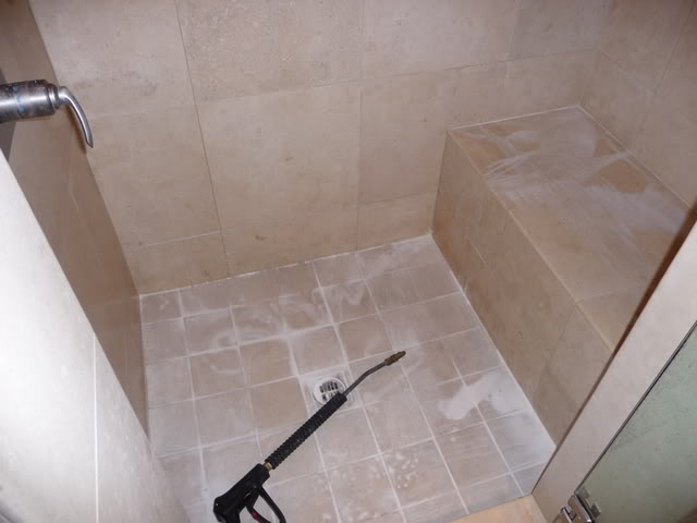

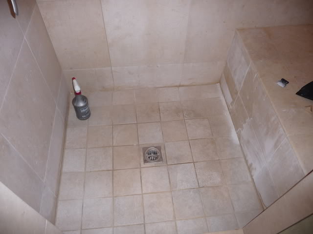

You'll find a lot of home owners are very leary of cleaning their own stone.
Perhaps they already goofed and used KabOom or another acid based product.

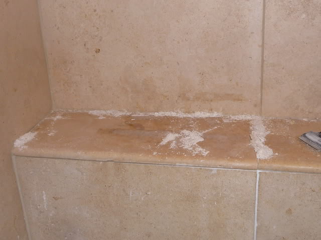

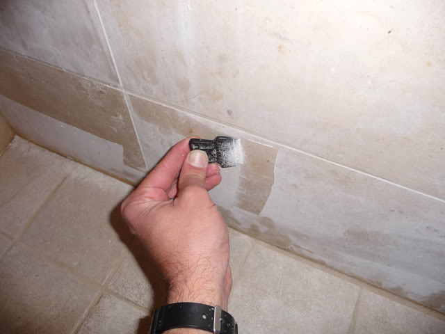

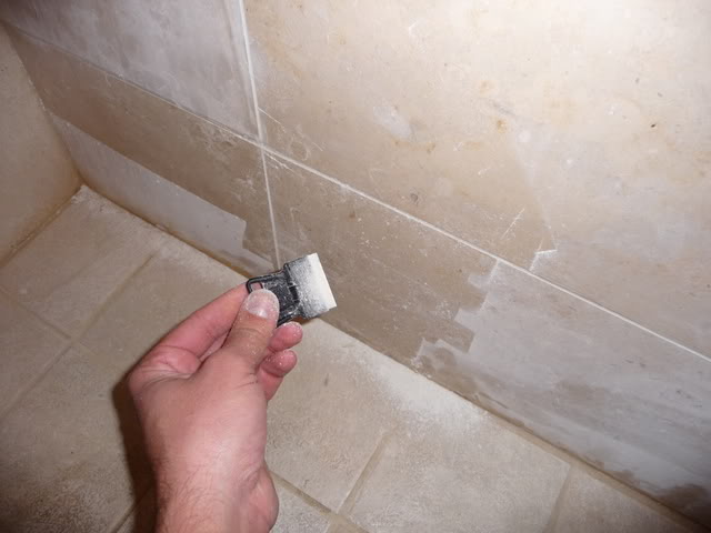

Get up the nerve to look in their shower and al0ng with a razor, some Magic Al's Non Acid Soap Scum Remover and a HF gun you too can be a hero.

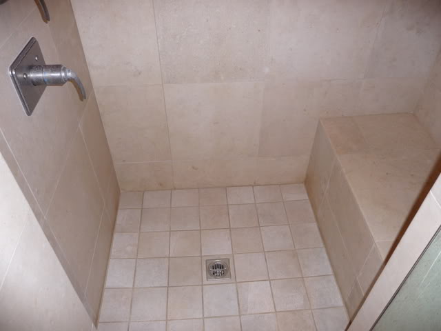

I charged $175 to just clean this one. Hubby will seal it. took under an hour.
The Shampoo bottle are is always the worse.
Some of the scum comes off in sheets it's so thick.

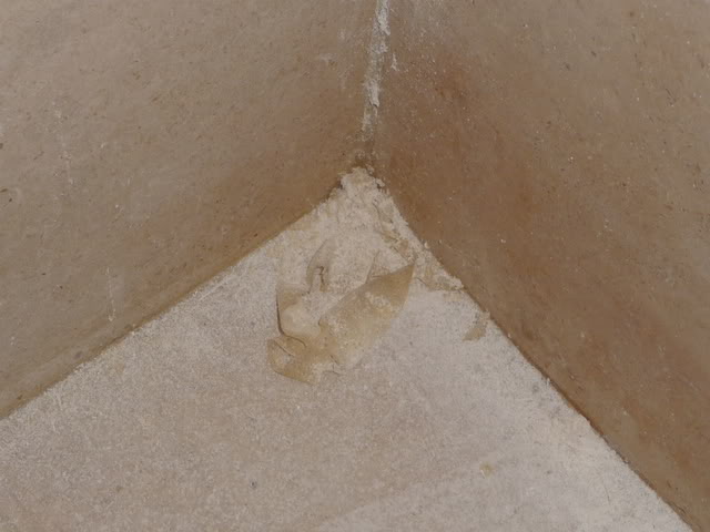

Some Peroxide based cleaner to get to the mold
and there you are.
Still a bit wet in the corners..

mikey, i notice in 1st photo that the grey 5/10 year trigger nozzle has taken the day off to be replace by a red head. :lol:
Has anyone had them last more than a few months?
Terry

Looks good!
What about the stainless fixtures?
A little polish and some 0000 steel wool and those would shine up nicely. Charge an extra 25+

Walrus said:
A well trained house cleaner around here would have charged $20 .
And then could of paid Mike $6 or $700 to come in and grind off all the etching!! That's where most of the money in Stone comes from!! :mrgreen:
R
R W
No gloves or mask and that scraping is probably dried jizim!! Yuk. Unless it's a "ladies only" house.
