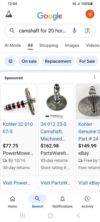

Well the final verdict on my boxer 318 is that it needs a new motor, they said a valve adjustment would fix it but apparently that did not take care of my problem and they told me the camshaft was very loose and wobbly and they con’t fix it so i am just putting a new motor in it

Never heard of a "loose wobbly cam shaft" before. Ive heard of spun bearings, rounded lobes, warn out thrust bearing but never loose wobbly cam shaft. I would question more before throwing out the motor cam moving in and out would suggest a thrust bearing up and down cam bearings possibly cam too bearings should only be 50 or so bucks+labor and a complete camshaft 100-150.00. Might as well replace your "high volume kooparater" while you're at it( that part connects to the throttle waddle on a ducks ass. ) not to be too sarcastic . But it sounds to me like this company is like the transmission shop in my town. For a 30.00 part and 250.00 labor they told me i needed a new transmission 3780.00+labor
i do believe thats what he said
I mention to the guy when i first took it in about just replacing the motor but he said he didn't think i needed a new motor but turns out i do, oh well
