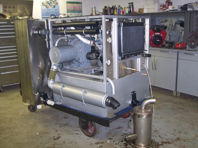

If you are wondering what that "thingy" is sitting on the floor in front of the Reactor it is a filter prototype.
Zero restriction regardless of how full the filter gets.

That prototype filter needs a new "filter". That clearview cartridge is a CFM robber. Unless the design maximizes the performance.
Why not make a filter like that, but it would have a lip down inside that peoples "current" baskets will fit into. ie, prochem basket, hm basket, etc. You could then have a customizable ring that will hold either two of those clearview cartridges or a ring that fits your basket from your TM and rests on the lip inside the mini box? I think that is a great idea. Someone do it or I will. Wink Wink *greenie*

Just make it with interchangeable drop in rings that sit on a ledge that will fit the different sized baskets!
That filter WILL plug up and the CFM WILL decrease. No way to prevent it.
Just have to train the operator to be aware of the wand performance to know when to go clean it.
Does the lint and stuff collect in the inside or the outside?
I believe those are 2.5" pipe, inlet and outlet. The larger the inlet /outlet the less restriction. I saw a huge difference when I re-plumbed my filter from 2" to 3".
I look forward to seeing it.
How would it work if the Inlet was the bottom pipe? Would need to hold down the filter.
Which is the inlet?
Or, how would it work if the inlet was the bottom pipe and it laid on its side?
