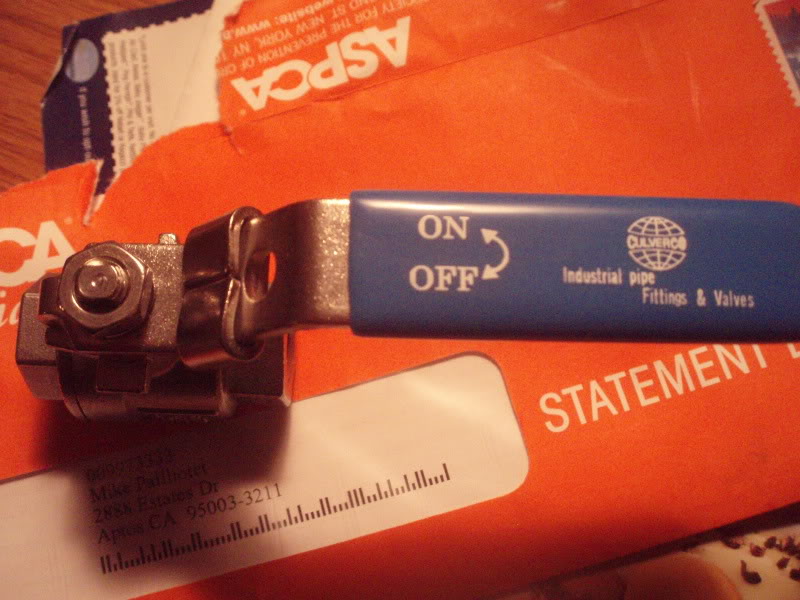

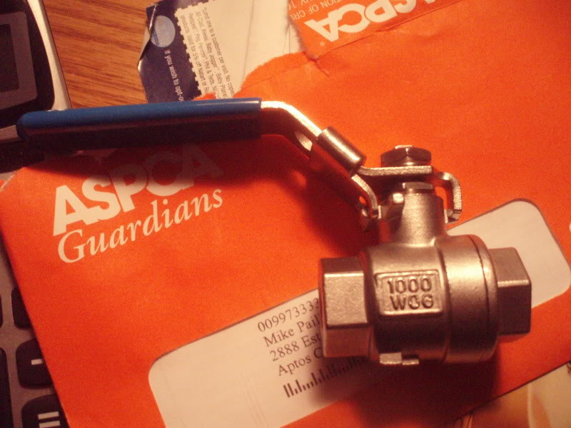

Check this beauty out.
I got it at my Parker store for $26.
Culverco brand
Parker SS valves are $68. ( but 2000WOG)!

Busted the male-male hex on mine after about 6 months. EZ-Out the broken piece, insert new male-male hex and 4 months later the damn thing is still holding pressure. I carry a spare in the van just in case.
I betcha it will go a year
2000 WOG's eh?
it's stamped 1000
are WOGs double PSI?
Water, Oil, Gass
BTW, a dude that works at Parker (right down the road from me) told me they pressure test at 3 times ratings

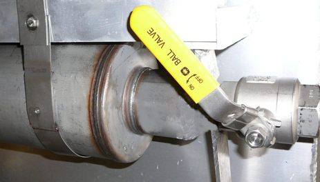

The HUGE handle would be a PITA at the wand. I currently use the small Parkers with the little yellow handles. They work well until you try to crank up the pressure for T&G work. Then the leaks start.
Some company out there, somewhere, has to have a decent valve that can take the PSI and the heat, and they aren't HUGE....

These are the best that I found. Use 2000 psi on pavers and they last a long time.
