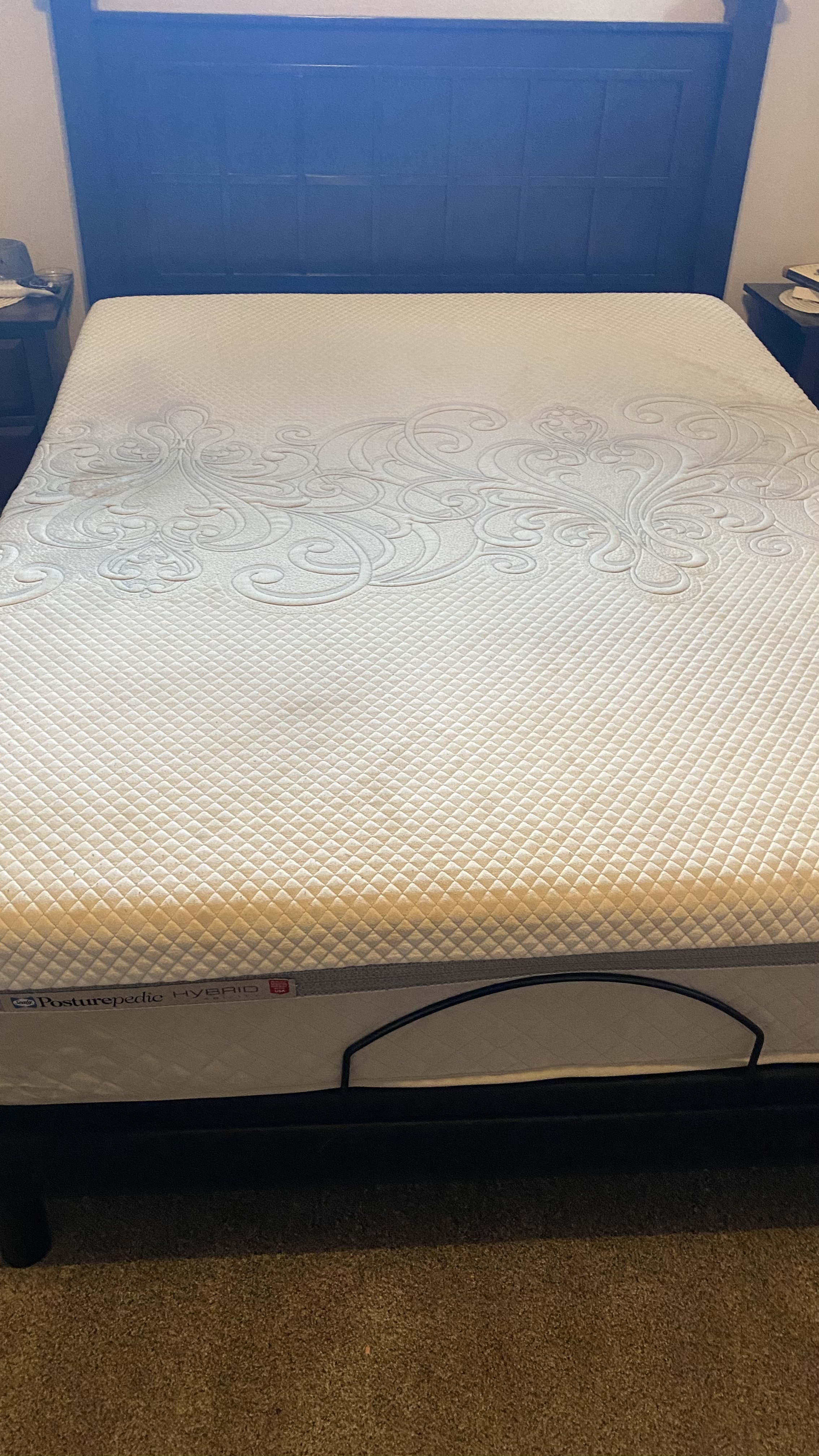

It says hello. I used it today on a horrible mattress. It's working very well. It wanted me to thank you for missing the auction.
