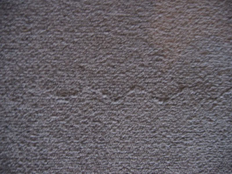

Cleaned a house last week and came across this strange squiggly line in a bedroom carpet. Can't offer to much detail other than its obviously a cut pile and appeared to repeat itself about 6' away. Had really poor lighting in the room so I couldn't see if it went wall to wall.
Anyone know the meaning of it? Aliens? Kinda makes me think of crop circles.

Sounds like a question for a carpet inspector? Sorry I can't be of more assistance other than to say call Dale Collins... If he says it's aliens I'll refer you to Dwayne Oxley...

Looks to me ....that the installer used a serpentine straight edge...
Did the pattern...span the length of the room..?
What was the size of the room..?
Possibly a tufting defect from the mill..?
Hard to tell from the photo.....was there a room partition divider ...leaving a depression..?
TERRIBLE.."blossoming" of the fibers...was is a poly or olefin..!!

Hard to tell from photo...BUT..It looks to be a cheap "Berber"..not a cut pile..?
Looks to be a worn..olefin...many installer used the "Serpentine" to hide the seams
the rows were so far off in some goods..it was impossible to hide the seam.. :roll:

not a serpentine straight edge too sharp of angles mine is much more rounded edge
i think its a flaw from mill looks familiar i think ive seen it before machine may have skipped some
i used to use a serpentine with blotchy sculptered carpet like we used to put in trailers alot the blotches didnt have a pattern so if you straight edged a seam and a black blotch came against a white -ouch! so we had to serpentine

Guys...."Blow-Up"..the photo...That is a continuous filament olefin yarn...It is a BERBER..!
Surely...someone did NOT...remove the salvage edge...prior to installing... :shock:
Looks like a tufting issue... :!:
There will be a EXPERT..along soon.. :D

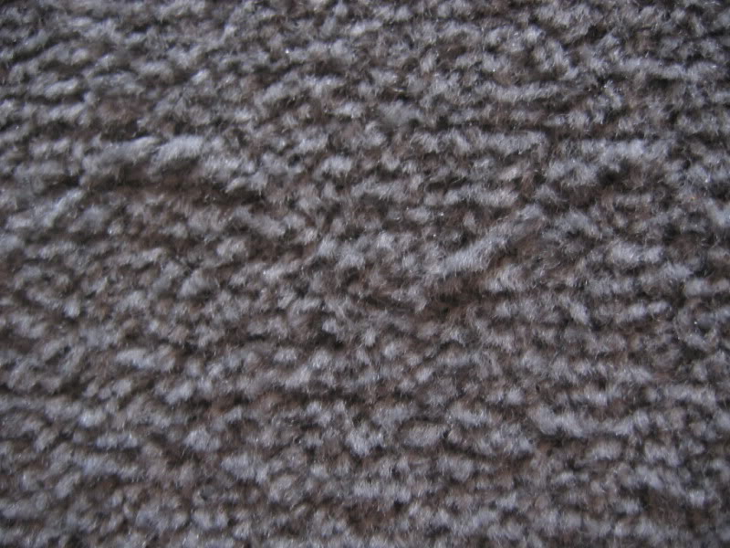

Jim, that's a high line and you can probably confirm it by seeing if the line is in the lengthwise direction.
This occurs when one tufting needle has been improperly set & comes up too high. It can be sheared down to make it look just fine.
Sometimes this can also occur when a repair is done at the mill with a tufting gun.
Here is an example of one that I saw on an Inspection.

Thanks Tony, just about looks like the same piece of carpet. The rest of the guys seemed to be running in the crop circle direction :)

I belive Harry has nailed this one. A high line was also my first thought. Many tufting machines use a step-over or zig-zag pattern. So, a single needle inserting a single yarn moves back and forth in that pattern.

The technical term for that defect is chicken tracks. All of the above are correct on how it occured. I have also been an inspector since 95

This mill defect is corrected in about 10 min with hand shears, and "the mIll has a right to repair". I've clipped many of them. Why not tell the consumer to send the mill a picture, and make a settlment. No Inspector needed, and $$.
