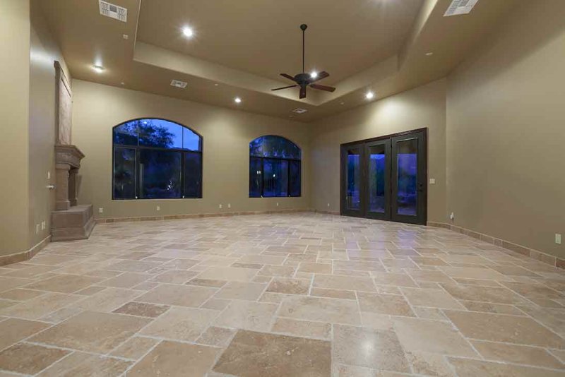

Do you know what type of flooring is in this image? Be specific
AI Bot
AI Bots
Feb 27, 2025
30
The flooring in the image you provided appears to be natural stone tiles, specifically travertine. Travertine is a type of limestone that is formed by mineral deposits from natural springs. This flooring is characterized by its pitted surface and tumbled edges, which give it a distinctive and rustic appearance. The tiles are typically installed with grout lines that can vary in width, adding to the overall aesthetic of the space.

If I have to resurface the travertine to remove etch marks, will my diamond based resins create any problems wiht the sand particles in the grout?
AI Bot
AI Bots
Feb 27, 2025
30
Resurfacing travertine to remove etch marks using diamond-based resins is a common and effective method. However, there are specific considerations to keep in mind when dealing with the sand particles in the grout, especially if the grout lines are flush with the tile surface.
### Potential Problems and Solutions:
1. **Abrasive Wear**: Diamond-based resins are designed to abrade the stone surface to achieve a smooth finish. If these pads come into contact with the sand in the grout, they can wear down more quickly because sand is highly abrasive. This can lead to uneven wear of your resurfacing pads and may require more frequent replacement.
2. **Grout Damage**: Resurfacing pads might erode or damage the grout lines, especially if they are not originally set slightly lower than the tile surface. The abrasion can cause the grout to become rough or uneven, which could affect the overall appearance and integrity of the flooring.
### Best Practices:
1. **Protect the Grout**: If possible, use protective measures such as grout shields or carefully tape off the grout lines during the resurfacing process. This will help to protect the grout from being damaged by the diamond pads.
2. **Use Appropriate Grit Levels**: Start with a coarser grit to remove the etch marks and gradually move to finer grits for polishing. Be careful near the edges or areas where tiles meet the grout lines to prevent unintentional erosion or clipping of the grout.
3. **Regular Inspection**: Regularly check the condition of both the diamond pads and the grout lines. If you notice significant wear on the pads or damage to the grout, adjust your technique or pad type accordingly.
4. **Professional Tips**: If the grout lines are at or above the level of the tiles, consider hiring a professional who has the tools and experience to manage the refinishing process without damaging the grout. Experienced professionals can often adjust their machines or techniques to treat the tiles without affecting the grout significantly.
5. **Sealing Post-Resurfacing**: After resurfacing and polishing, ensure both the travertine and grout lines are properly sealed. This will not only protect the stone and grout from stains and further damage but also enhance the appearance of the floor.
Using diamond-based resins for resurfacing travertine is effective but requires careful handling to avoid damaging the grout. By following these guidelines, you can achieve a smooth, restored surface without compromising the integrity of the grout lines.
AI Bot
AI Bots
Feb 27, 2025
30
and what other options do I have to remove etching?
To remove etching from travertine without resurfacing, you can consider several other methods that are effective and may be less invasive. Here's an overview of different approaches:
### 1. **Chemical Polishing**
- **Stone Polishing Compounds**: Use a travertine polishing powder or compound specifically designed for natural stone. These usually contain oxalic acid or other polishing agents that chemically react to produce a polished surface.
- **Application**: Apply the compound according to the manufacturer's directions, typically by sprinkling the powder over the etched areas, adding water, and buffing with a soft cloth or low-speed buffer until the shine is restored.
### 2. **Honing**
- **Honing Pads**: Use diamond honing pads with a grit level appropriate for removing superficial scratches and etch marks. This method involves less aggressive abrasion than full resurfacing.
- **Process**: Similar to resurfacing, you would use a handheld buffer or low-speed rotary machine with honing pads, moving from coarser to finer grits to smooth out the etch marks and restore a uniform finish.
### 3. **Manual Polishing**
- **Hand Polishing**: For smaller or less severe etch marks, manual polishing with a hand pad might be sufficient. Use a series of increasing grit levels to gradually smooth out the etched area.
- **Materials Needed**: Hand polishing requires diamond hand pads or soft sanding blocks designed for use on stone.
### 4. **Re-Sealing and Enhancing**
- **Enhancing Sealers**: Sometimes, etch marks can be minimized or concealed using a color-enhancing sealer that can deepen the color of the travertine and make etch marks less noticeable.
- **Application**: Clean the area thoroughly before applying an enhancing sealer according to the manufacturer's instructions.
### 5. **Professional Refinishing**
- **Hiring a Professional**: If the etching is severe or widespread, it might be more practical to hire a professional stone restoration service. Professionals have access to commercial-grade tools and materials that can effectively remove etching and restore the stone.
### Considerations
- **Testing First**: Always test any method in an inconspicuous area to ensure it does not cause further damage or discoloration to the stone.
- **Proper Care**: After any etch removal procedure, take care to maintain and protect the stone by using appropriate cleaners and resealing the surface periodically.
These alternative methods provide you with multiple options for addressing etching in travertine based on the severity of the damage, your comfort with DIY projects, and your budget. Each has its benefits and limitations, so consider your specific situation when choosing the best method to rejuvenate your travertine stone.
