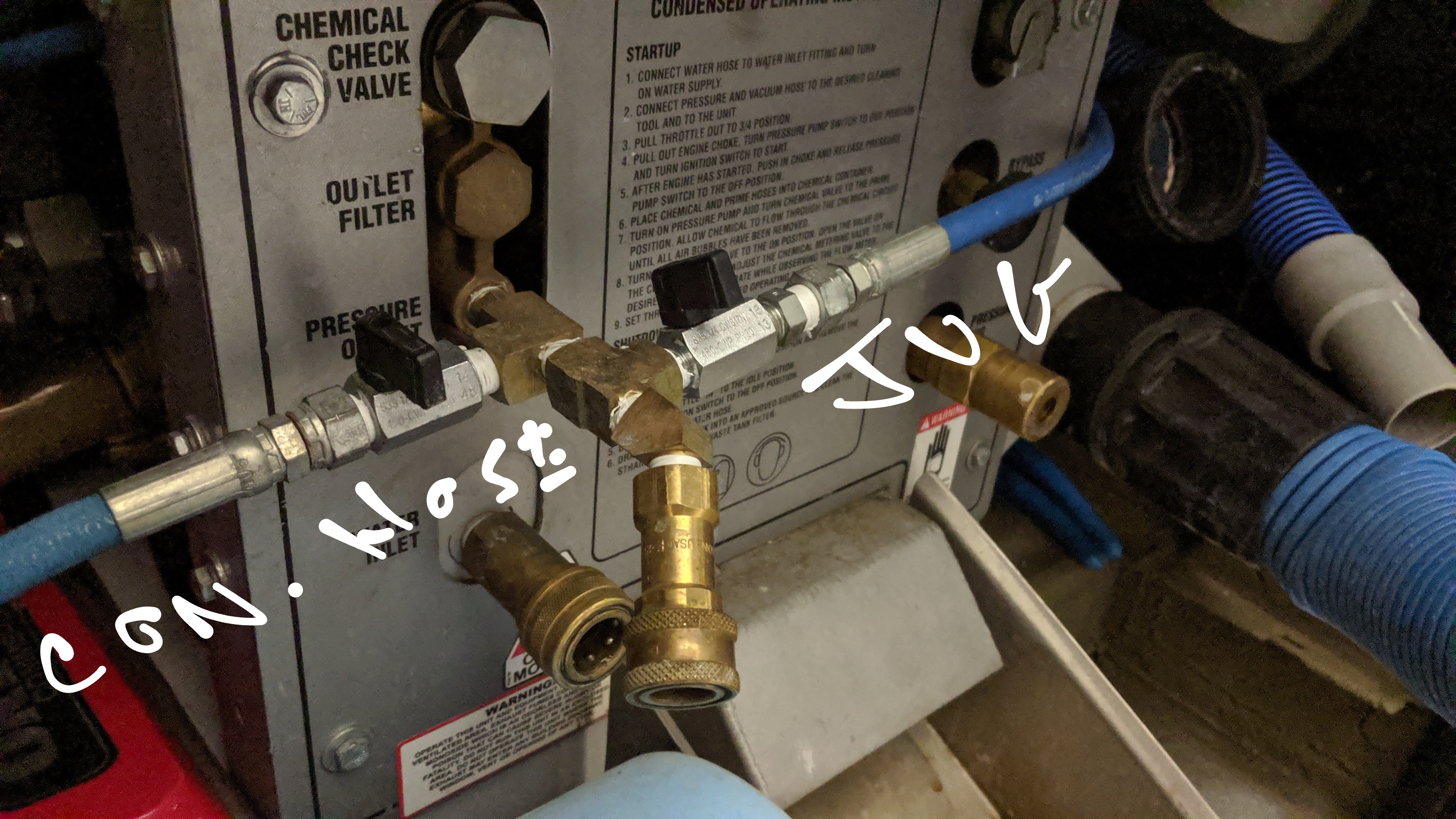

and make damn sure that your jug fill hose won't pop out of the cap when you go to fill it under heated pressure or you're going to soak your cab and melt your skin

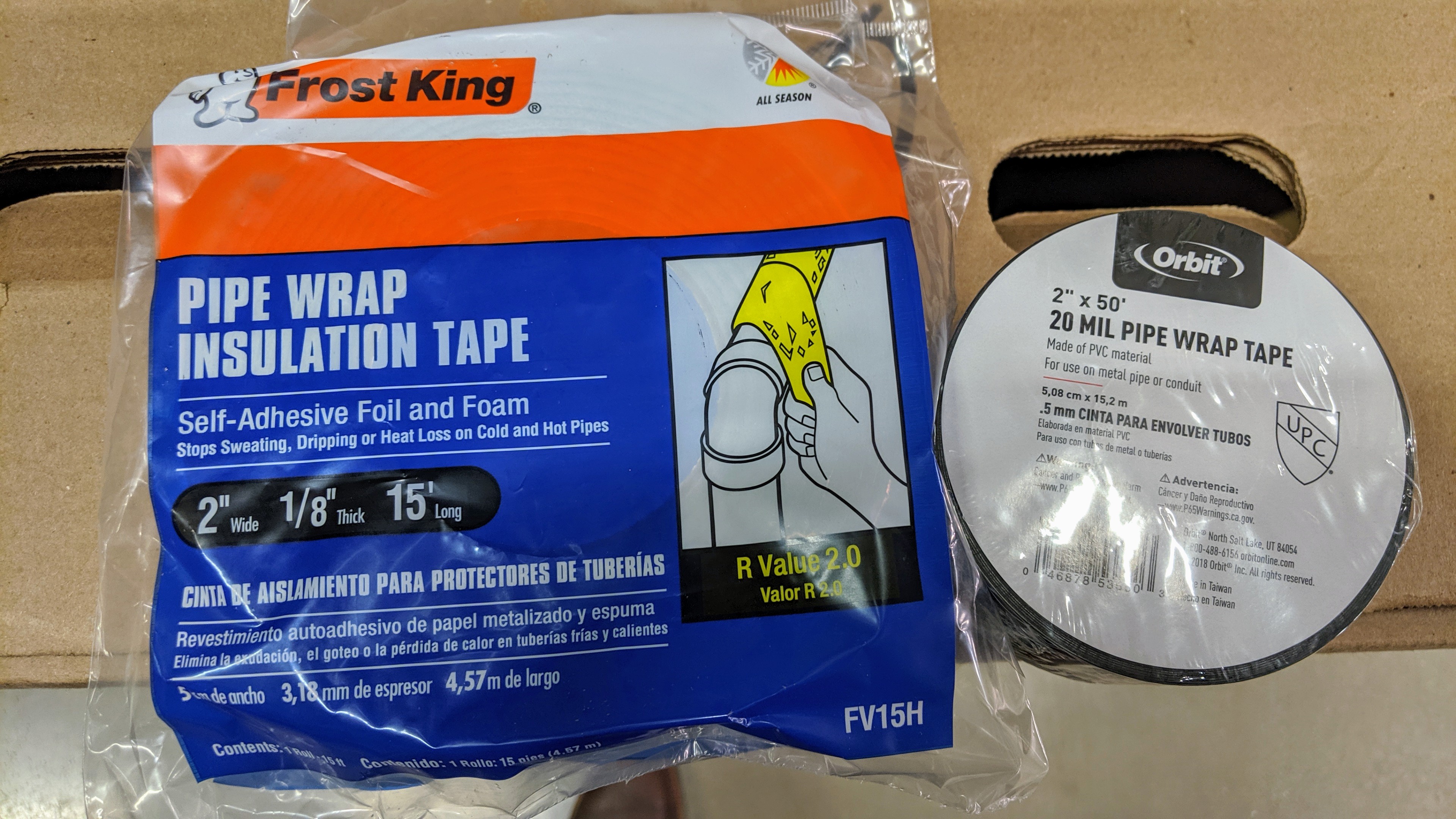

Do you keep your wand planted on the floor when you clean? The less you pick your wand up off the carpet, the hotter it’ll getGood to know. My system is vastly different than your system. It seem that your system produces heat and maintains it better. I wonder if i can improve it.. would cover up the heat exchanger completely with insulate blanket improve heat?
Still learning it. Maybe winter just make it colder as fresh water just cold.
