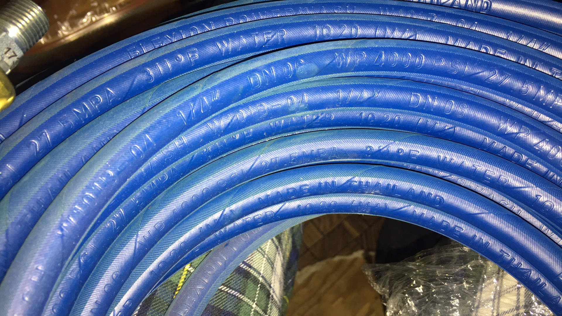

I’m loving these hoses so far. Not stiff, insulates the heat well, and is a rough feeling surface that isn’t bleeding blue when wet. I’ll keep you up to date on it as time flies
The outer skin on mine marked up quickly, but is a decent hose to work with. I have been using for about a year now. I bought a second 125' length at the first if the year, so I would recommend.
14,078
Is this the hose you got? Flexion?

They all blow out black water in 6 months or less I’m hoping these Flexion hoses will hold up

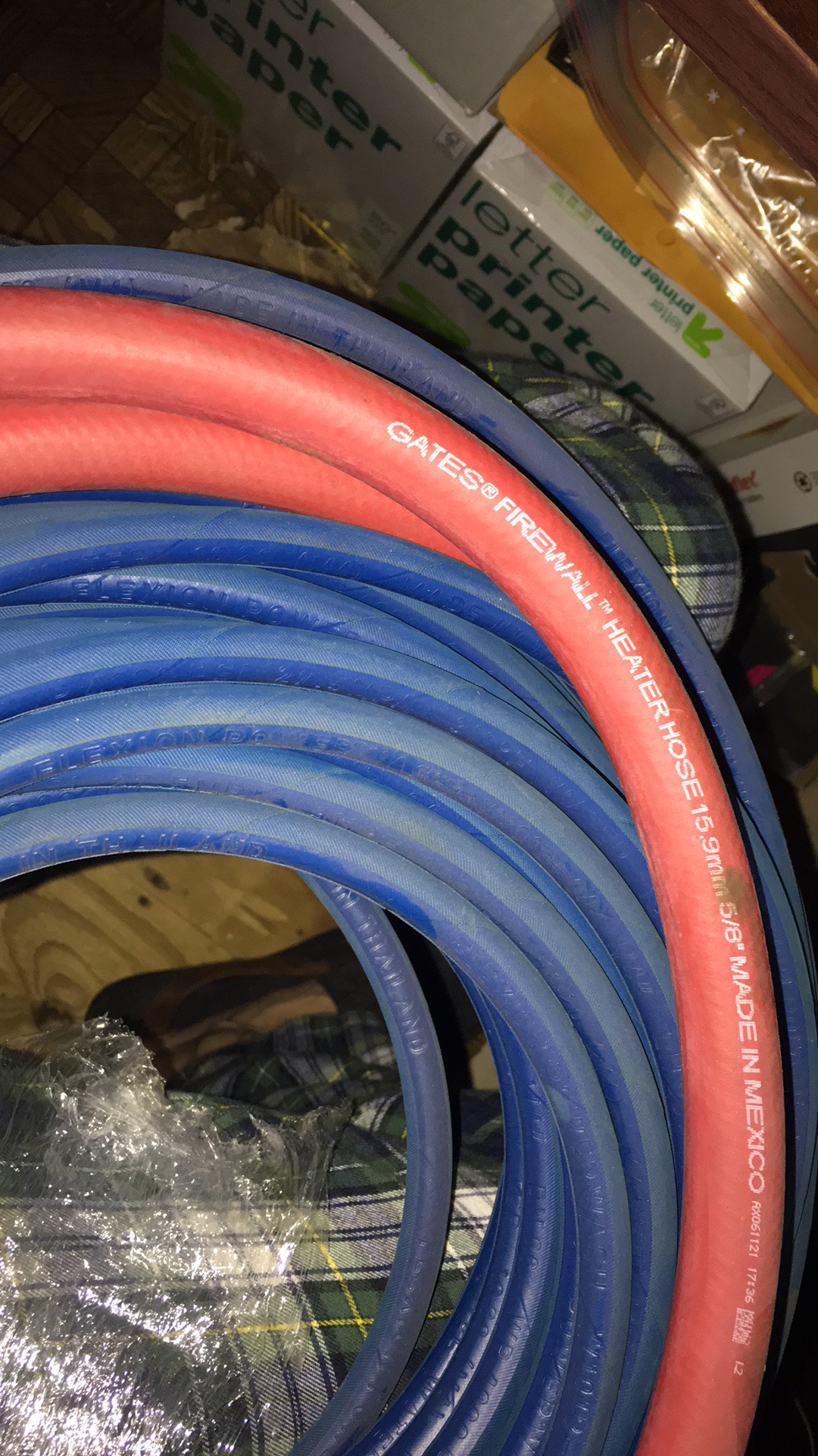

The red heater hose serves the function of bend restriction, heat protection, and blowout deflection.
I remember seeing @GeneMiller use the clear vinyl hose as a deflection hose.. You could see if it was leaking..
