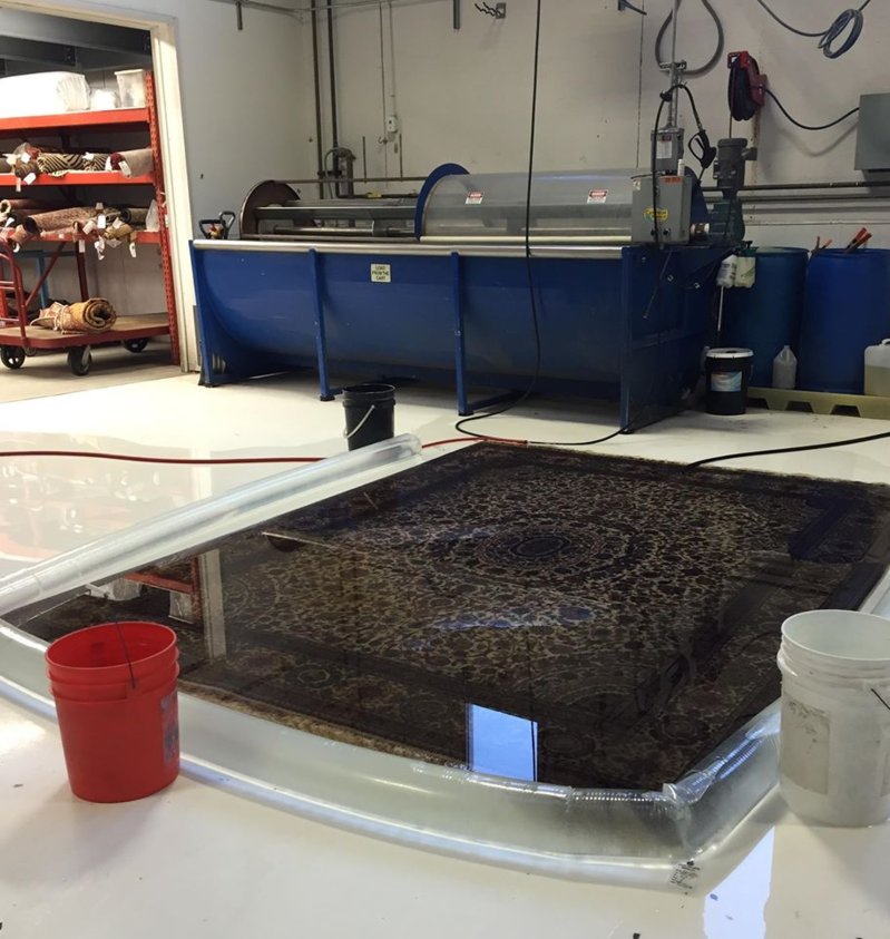

I have a wash pit built with pvc pipe and pond liner. I had sleeves sewn on the liner so all I had to do was slide the pvc into the sleeves and connect with the elbow joints. Pretty easy set up and break down and requires very little storage space. The pond liner is fairly thick - can't remember the exact mil thickness - but is not 100% water tight. I just ordered this to replace what I have. There is also a heavy duty option. http://www.chemicalguys.com/Car_Wash_Mat_Water_Containment_Mat_p/acc_m1.htm

You can also fill the smaller diameter tubes with water to make quick soaking enclosures on the wash floor. (Robert Mann's idea is inexpensive)
We also sell the new version Rug Suckers offered by Rugged Industries.
http://centrum-force.com/rug-sucker.html
