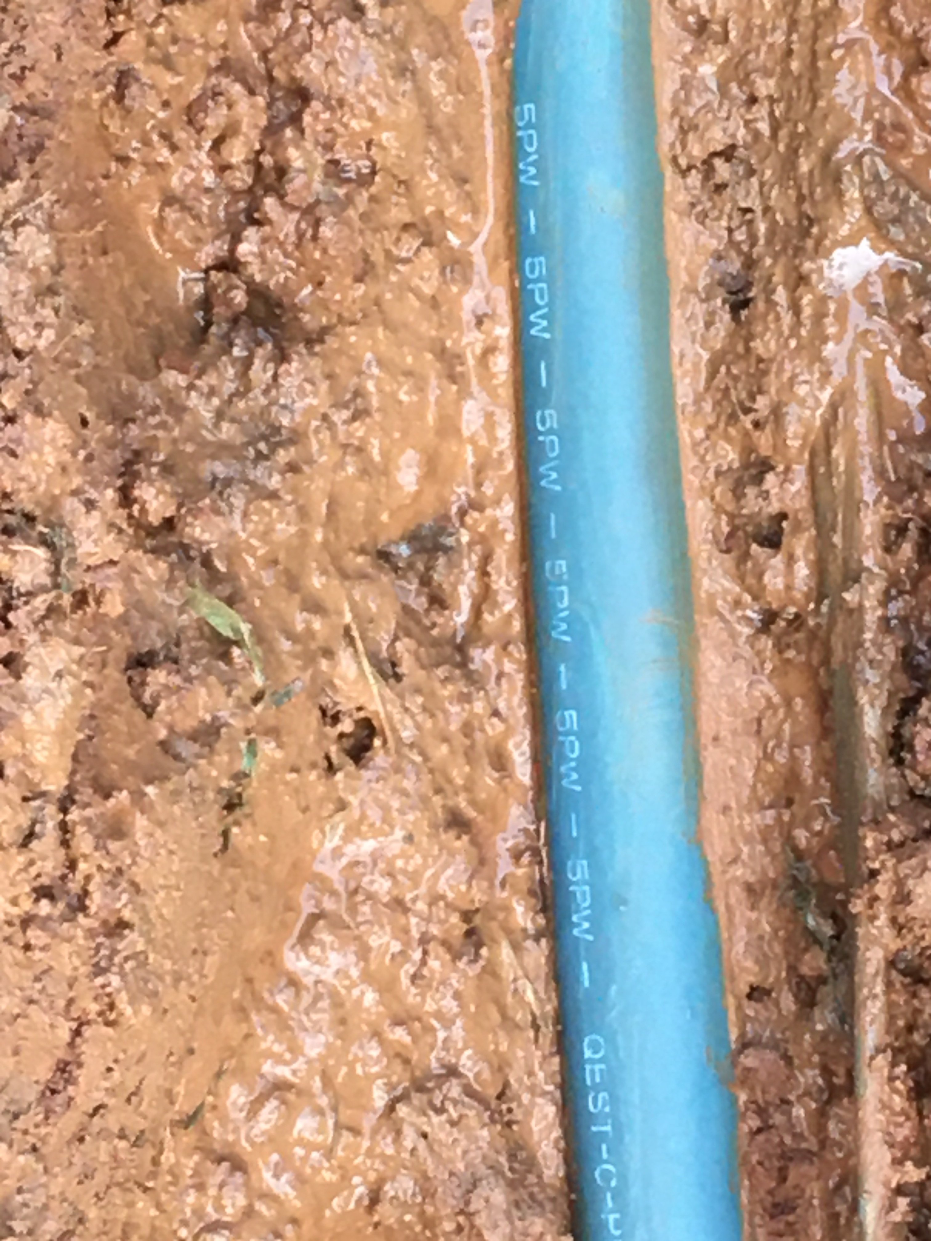

It's just coming straight out of the ground with no casing from what I can tell. Looks like whoever plumbed it did a shitty job. I'll try and take a picture and show you how it looks.

old gray polybutylene
there was a YUGE class action settlement over that crap in the early 90's(?)
One of our accounts owned a dozen new condos plumbed with it.
Right from the get-go they had pipe bursts.
Everyone on the street of the first phase (40 units) were popping pipes
The second and third phase 40+40 units got copper
we were out there a couple times a month to fix broken pipes and dry carpets til they replaced all the plumbing

What is Qest pipe?
Polybutylene (PB) was a plastic manufactured between 1978 and mid-1995 for use as piping in home plumbing systems. ... Pipes made from polybutylene were installed in up to 10 million homes in the Unites States during that period.

I was told that was pex. Maybe I was wrong
